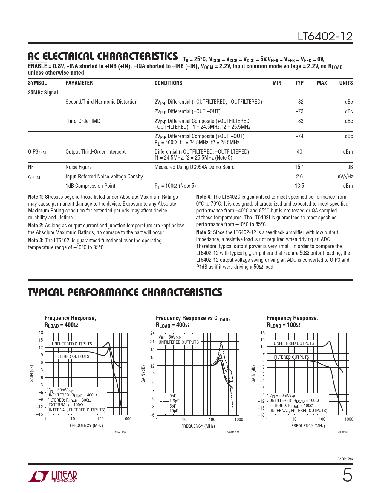

AC ELECTRICAL CHARACTERISTICS TA = 25°C, VCCA = VCCB = VCCC = 5V,VEEA = VEEB = VEEC = 0V,
LT6402-12
E
N
A
B
L
E = 0.8V, +INA shorted to +INB (+IN), –INA shorted to –INB (–IN), VOCM = 2.2V, Input common mode voltage = 2.2V, no RLOAD unless otherwise noted. SYMBOL PARAMETER CONDITIONS MIN TYP MAX UNITS 25MHz Signal
Second/Third Harmonic Distortion 2VP-P Differential (+OUTFILTERED, –OUTFILTERED) –82 dBc 2VP-P Differential (+OUT, –OUT) –73 dBc Third-Order IMD 2VP-P Differential Composite (+OUTFILTERED, –83 dBc –OUTFILTERED), f1 = 24.5MHz, f2 = 25.5MHz 2VP-P Differential Composite (+OUT, –OUT), –74 dBc RL = 400Ω, f1 = 24.5MHz, f2 = 25.5MHz OIP325M Output Third-Order Intercept Differential (+OUTFILTERED, –OUTFILTERED), 40 dBm f1 = 24.5MHz, f2 = 25.5MHz (Note 5) NF Noise Figure Measured Using DC954A Demo Board 15.1 dB en25M Input Referred Noise Voltage Density 2.6 nV/√Hz 1dB Compression Point RL = 100Ω (Note 5) 13.5 dBm
Note 1:
Note 4:
The LT6402C is guaranteed to meet specifi ed performance from may cause permanent damage to the device. Exposure to any Absolute 0°C to 70°C. It is designed, characterized and expected to meet specifi ed Maximum Rating condition for extended periods may affect device performance from –40°C and 85°C but is not tested or QA sampled reliability and lifetime. at these temperatures. The LT6402I is guaranteed to meet specifi ed
Note 2:
As long as output current and junction temperature are kept below performance from –40°C to 85°C. the Absolute Maximum Ratings, no damage to the part will occur.
Note 5:
Since the LT6402-12 is a feedback amplifi er with low output
Note 3:
The LT6402 is guaranteed functional over the operating impedance, a resistive load is not required when driving an ADC. temperature range of –40°C to 85°C. Therefore, typical output power is very small. In order to compare the LT6402-12 with typical gm amplifi ers that require 50Ω output loading, the LT6402-12 output voltage swing driving an ADC is converted to OIP3 and P1dB as if it were driving a 50Ω load.
TYPICAL PERFORMANCE CHARACTERISTICS Frequency Response, Frequency Response vs CLOAD, Frequency Response, RLOAD = 400
Ω
RLOAD = 400
Ω
RLOAD = 100
Ω 18 24 18 V 15 IN = 50VP-P 21 15 UNFILTERED OUTPUTS UNFILTERED OUTPUTS UNFILTERED OUTPUTS 12 12 18 9 9 FILTERED OUTPUTS 15 FILTERED OUTPUTS 6 6 12 3 3 9 0 0 GAIN (dB) GAIN (dB) 6 GAIN (dB) –3 –3 –6 V –6 IN = 50mVP-P 3 UNFILTERED: RLOAD = 400Ω 0pF –9 VIN = 50mVP-P –9 FILTERED: R 0 LOAD = 300Ω 1.6pF –12 UNFILTERED: RLOAD = 100Ω –12 (EXTERNAL) + 100Ω –3 5pF FILTERED: RLOAD = 100Ω (INTERNAL, FILTERED OUTPUTS) –15 10pF (INTERNAL, FILTERED OUTPUTS) –15 –6 –18 1 10 100 1000 1 10 100 1000 1 10 100 1000 FREQUENCY (MHz) FREQUENCY (MHz) FREQUENCY (MHz) 640212 G01 640212 G02 640212 G03 640212fa 5
