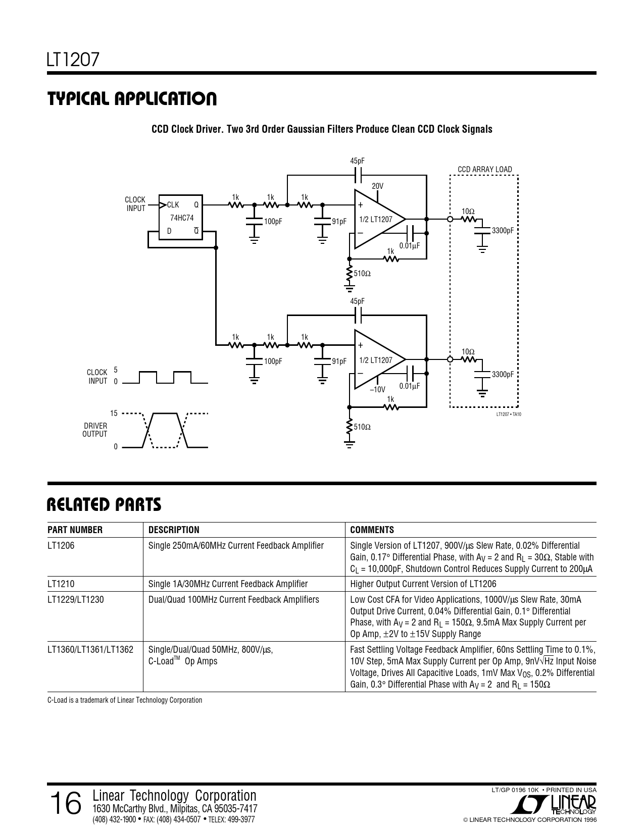

TYPICAL APPLICATION. CCD Clock Driver. Two 3rd Order Gaussian Filters Produce Clean CCD Clock Signals. RELATED PARTS
TYPICAL APPLICATION CCD Clock Driver Two 3rd Order Gaussian Filters Produce Clean CCD Clock Signals RELATED PARTS
LT1207
U TYPICAL APPLICATION CCD Clock Driver. Two 3rd Order Gaussian Filters Produce Clean CCD Clock Signals
45pF CCD ARRAY LOAD 20V CLOCK 1k 1k 1k CLK Q + INPUT 10Ω 74HC74 100pF 91pF 1/2 LT1207 D Q – 3300pF 0.01µF 1k 510Ω 45pF 1k 1k 1k + 10Ω 100pF 91pF 1/2 LT1207 5 CLOCK – 3300pF INPUT 0 0.01µF –10V 1k 15 LT1207 • TA10 DRIVER 510Ω OUTPUT 0
RELATED PARTS PART NUMBER DESCRIPTION COMMENTS
LT1206 Single 250mA/60MHz Current Feedback Amplifier Single Version of LT1207, 900V/µs Slew Rate, 0.02% Differential Gain, 0.17° Differential Phase, with AV = 2 and RL = 30Ω, Stable with CL = 10,000pF, Shutdown Control Reduces Supply Current to 200µA LT1210 Single 1A/30MHz Current Feedback Amplifier Higher Output Current Version of LT1206 LT1229/LT1230 Dual/Quad 100MHz Current Feedback Amplifiers Low Cost CFA for Video Applications, 1000V/µs Slew Rate, 30mA Output Drive Current, 0.04% Differential Gain, 0.1° Differential Phase, with AV = 2 and RL = 150Ω, 9.5mA Max Supply Current per Op Amp, ±2V to ±15V Supply Range LT1360/LT1361/LT1362 Single/Dual/Quad 50MHz, 800V/µs, Fast Settling Voltage Feedback Amplifier, 60ns Settling Time to 0.1%, C-LoadTM Op Amps 10V Step, 5mA Max Supply Current per Op Amp, 9nV√Hz Input Noise Voltage, Drives All Capacitive Loads, 1mV Max VOS, 0.2% Differential Gain, 0.3° Differential Phase with AV = 2 and RL = 150Ω C-Load is a trademark of Linear Technology Corporation LT/GP 0196 10K • PRINTED IN USA 16 Linear Technology Corporation 1630 McCarthy Blvd., Milpitas, CA 95035-7417 (408) 432-1900 ● FAX: (408) 434-0507 ● TELEX: 499-3977 LINEAR TECHNOLOGY CORPORATION 1996
