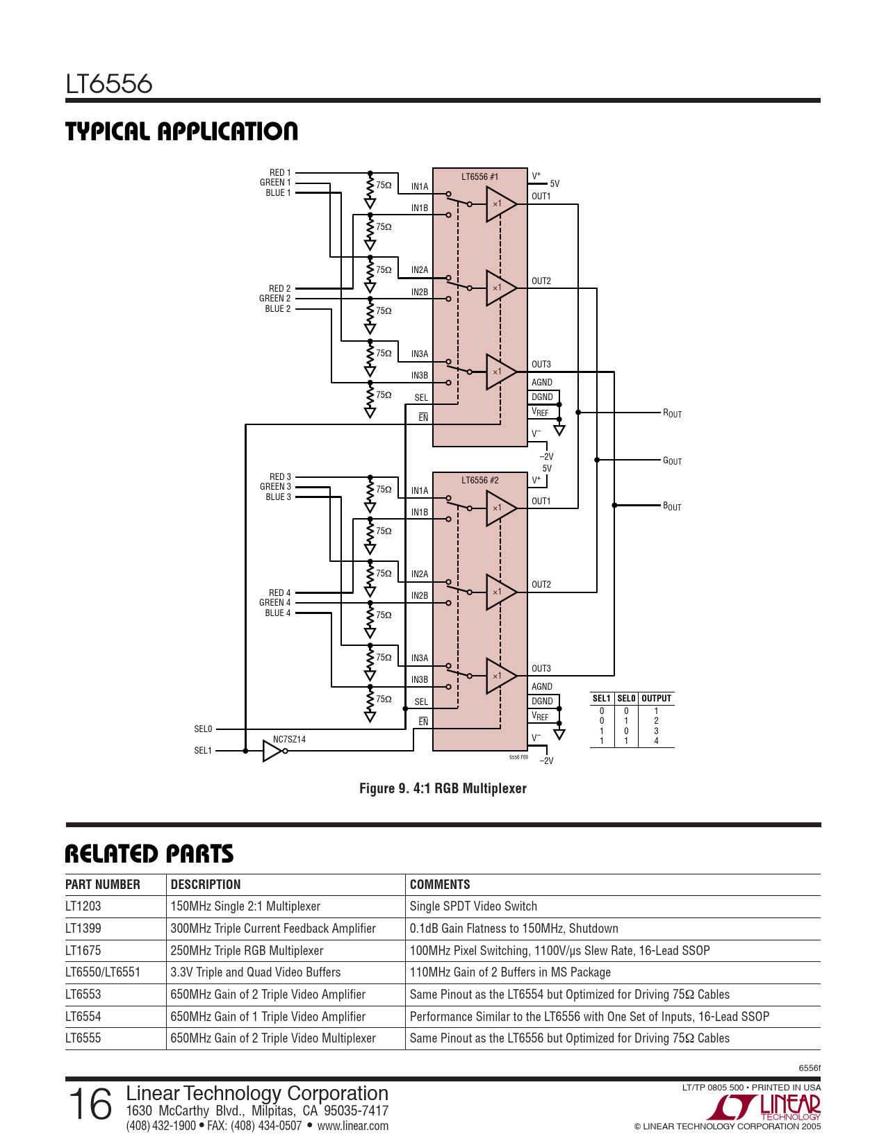

U TYPICAL APPLICATIO
RED 1 LT6556 #1 V+ GREEN 1 75Ω IN1A 5V BLUE 1 OUT1 ×1 IN1B 75Ω 75Ω IN2A OUT2 RED 2 ×1 IN2B GREEN 2 BLUE 2 75Ω 75Ω IN3A OUT3 ×1 IN3B AGND 75Ω SEL DGND VREF R EN OUT V– –2V GOUT 5V RED 3 LT6556 #2 V+ GREEN 3 75Ω IN1A BLUE 3 OUT1 ×1 BOUT IN1B 75Ω 75Ω IN2A OUT2 RED 4 ×1 IN2B GREEN 4 BLUE 4 75Ω 75Ω IN3A OUT3 ×1 IN3B AGND 75Ω SEL DGND
SEL1 SEL0 OUTPUT
0 0 1 VREF EN 0 1 2 SEL0 1 0 3 NC7SZ14 V– 1 1 4 SEL1 6556 F09 –2V
Figure 9. 4:1 RGB Multiplexer RELATED PARTS PART NUMBER DESCRIPTION COMMENTS
