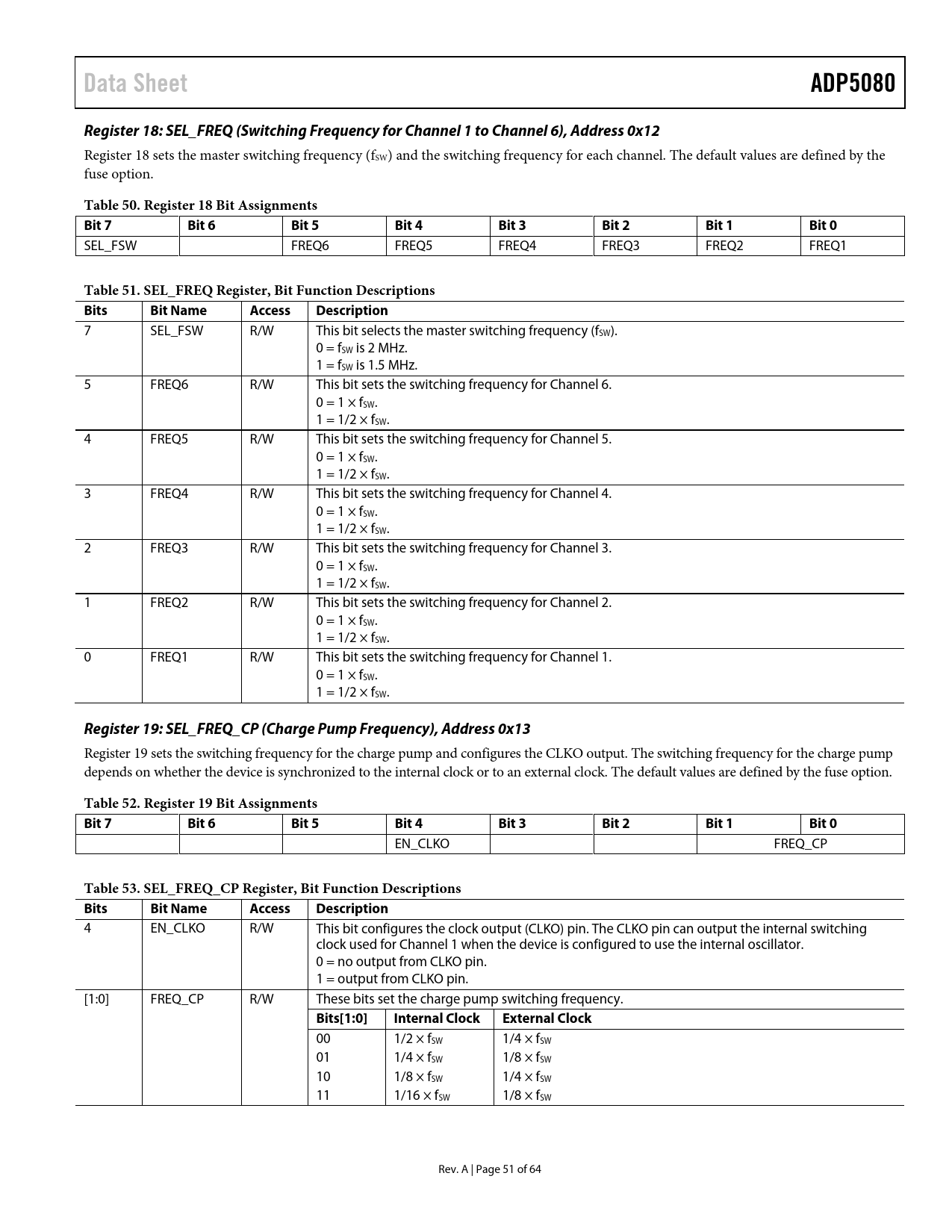

Data Sheet. ADP5080. Register 18: SEL_FREQ (Switching Frequency for Channel 1 to Channel 6), Address 0x12
Data Sheet ADP5080 Register 18: SEL_FREQ (Switching Frequency for Channel 1 to Channel 6), Address 0x12
Register 18 sets the master switching frequency (fSW) and the switching frequency for each channel. The default values are defined by the fuse option.
Table 50. Register 18 Bit Assignments Bit 7 Bit 6 Bit 5 Bit 4 Bit 3 Bit 2 Bit 1 Bit 0
SEL_FSW FREQ6 FREQ5 FREQ4 FREQ3 FREQ2 FREQ1
Table 51. SEL_FREQ Register, Bit Function Descriptions Bits Bit Name Access Description
7 SEL_FSW R/W This bit selects the master switching frequency (fSW). 0 = fSW is 2 MHz. 1 = fSW is 1.5 MHz. 5 FREQ6 R/W This bit sets the switching frequency for Channel 6. 0 = 1 × fSW. 1 = 1/2 × fSW. 4 FREQ5 R/W This bit sets the switching frequency for Channel 5. 0 = 1 × fSW. 1 = 1/2 × fSW. 3 FREQ4 R/W This bit sets the switching frequency for Channel 4. 0 = 1 × fSW. 1 = 1/2 × fSW. 2 FREQ3 R/W This bit sets the switching frequency for Channel 3. 0 = 1 × fSW. 1 = 1/2 × fSW. 1 FREQ2 R/W This bit sets the switching frequency for Channel 2. 0 = 1 × fSW. 1 = 1/2 × fSW. 0 FREQ1 R/W This bit sets the switching frequency for Channel 1. 0 = 1 × fSW. 1 = 1/2 × fSW.
Register 19: SEL_FREQ_CP (Charge Pump Frequency), Address 0x13
Register 19 sets the switching frequency for the charge pump and configures the CLKO output. The switching frequency for the charge pump depends on whether the device is synchronized to the internal clock or to an external clock. The default values are defined by the fuse option.
Table 52. Register 19 Bit Assignments Bit 7 Bit 6 Bit 5 Bit 4 Bit 3 Bit 2 Bit 1 Bit 0
EN_CLKO FREQ_CP
Table 53. SEL_FREQ_CP Register, Bit Function Descriptions Bits Bit Name Access Description
4 EN_CLKO R/W This bit configures the clock output (CLKO) pin. The CLKO pin can output the internal switching clock used for Channel 1 when the device is configured to use the internal oscillator. 0 = no output from CLKO pin. 1 = output from CLKO pin. [1:0] FREQ_CP R/W These bits set the charge pump switching frequency.
Bits[1:0] Internal Clock External Clock
00 1/2 × fSW 1/4 × fSW 01 1/4 × fSW 1/8 × fSW 10 1/8 × fSW 1/4 × fSW 11 1/16 × fSW 1/8 × fSW Rev. A | Page 51 of 64 Document Outline Features Applications Functional Block Diagram General Description Table of Contents Revision History Specifications Housekeeping Block Specifications DC-to-DC Converter Block Specifications Linear Regulator Block Specifications I2C Interface Timing Specifications Timing Diagram Absolute Maximum Ratings Thermal Resistance ESD Caution Pin Configuration and Function Descriptions Typical Performance Characteristics Application Circuit Theory of Operation UVLO and POR Undervoltage Lockout (UVLO) Power-On Reset (POR) Discharge Switch Keep-Alive LDO Linear Regulators LDO1 VISW1 Input Current Limit for LDO1 Discharge Switch for LDO1 LDO2 VISW2 Input Current Limit for LDO2 Discharge Switch for LDO2 DC-to-DC Converter Channels Channel 1, Channel 2, and Channel 3: Buck Regulators with Flex-Mode Architecture Selecting the Output Voltage, Channel 1 to Channel 3 Current-Limit Protection, Channel 1 to Channel 3 Discharge Switch, Channel 1 to Channel 3 Gate Scaling (Channel 1 Only) Dynamic Voltage Scaling (DVS) Function Channel 4 and Channel 5: Current Mode Buck Regulators Selecting the Output Voltage, Channel 4 and Channel 5 Current-Limit Protection, Channel 4 and Channel 5 Discharge Switch, Channel 4 and Channel 5 Channel 6: Buck or Buck Boost Regulator Buck Only Configuration Buck Boost Configuration Selecting the Output Voltage, Channel 6 Current-Limit Protection, Channel 6 Discharge Switch, Channel 6 Light Load and Other Modes of Operation for the DC-to-DC Converter Channels Slew Rate Adjustment Forced PWM (FPWM) Mode Auto DCM Auto PSM Selecting Light Load Switching Modes Switching Clock External Synchronization Mode Selecting the Internal Clock Frequency Selecting the External Resistor Phase Shifting CLKO Pin Soft Start Function Channel 7: High Voltage LDO Regulator Selecting the Output Voltage, Channel 7 Discharge Switch, Channel 7 Charge Pump Charge Pump Switching Frequency Capacitor Selection Protection Diode Using the Charge Pump as the Channel 7 Input Supply Enabling and Disabling the Output Channels Sequencer Mode Manual Mode EN Function EN34 Function Power-Good Function Fault Function Undervoltage Protection (UVP) UVP Detection Delay Channel 5 Standalone Undervoltage Detection Option Recovering from UVP Overvoltage Protection (OVP) OVP Detection Delay Recovering from OVP Applications Information Component Selection for the Buck and Buck Boost Regulators Setting the Output Voltage (Adjustable Mode Channels) Selecting the Inductor Selecting the Input Capacitor Selecting the Output Capacitor Component Selection for the LDO Regulators Selecting the Capacitors PCB Layout Recommendations Sensitive Signal Treatment Grounding External Component Placement and Signal Routing Thermal Considerations I2C Interface SDA and SCL Pins I2C Address Self-Clearing Register Bits I2C Interface Timing Diagrams Control Register Information Control Register Map CONTROL REGISTER DETAILS Register 1: DSCG (Discharge Switch Control), Address 0x01 Register 2: SFTTIM1234 (Soft Start Time for Channel 1, Channel 2, Channel 3, and Channel 4), Address 0x02 Register 3: SFTTIM567 (Soft Start Time for Channel 5, Channel 6, and Channel 7), Address 0x03 Register 4: EN_DLY12 (Enable Delay Time for Channel 1 and Channel 2), Address 0x04 Register 5: EN_DLY34 (Enable Delay Time for Channel 3 and Channel 4), Address 0x05 Register 6: EN_DLY56 (Enable Delay Time for Channel 5 and Channel 6), Address 0x06 Register 7: EN_DLY7 (Enable Delay Time for Channel 7), Address 0x07 Register 8: DIS_DLY12 (Disable Delay Time for Channel 1 and Channel 2), Address 0x08 Register 9: DIS_DLY34 (Disable Delay Time for Channel 3 and Channel 4), Address 0x09 Register 10: DIS_DLY56 (Disable Delay Time for Channel 5 and Channel 6), Address 0x0A Register 11: DIS_DLY7 (Disable Delay Time for Channel 7), Address 0x0B Register 12: VID1 (Output Voltage for Channel 1), Address 0x0C Register 13: VID23 (Output Voltage for Channel 2 and Channel 3), Address 0x0D Register 14: VID45 (Output Voltage for Channel 4 and Channel 5), Address 0x0E Register 15: VID6 (Output Voltage for Channel 6), Address 0x0F Register 16: VID7_LDO12 (Output Voltage for Channel 7, LDO1, and LDO2), Address 0x10 Register 17: DVS12 (DVS Control for Channel 1 and Channel 2), Address 0x11 Register 18: SEL_FREQ (Switching Frequency for Channel 1 to Channel 6), Address 0x12 Register 19: SEL_FREQ_CP (Charge Pump Frequency), Address 0x13 Register 20: SEL_PHASE (Switching Phase for Channel 1 to Channel 6), Address 0x14 Register 23: PROT_DLY (Undervoltage/Overvoltage Protection Delay Times), Address 0x17 Register 24: PWRG (Power-Good Status), Address 0x18 Register 25: MASK_PWRG (Power-Good Masked Channels), Address 0x19 Register 26: UVPST (Undervoltage Protection Status), Address 0x1A Register 27: OVPST (Overvoltage Protection Status), Address 0x1B Register 28: AUTO-PSM (Auto PSM or Forced PWM Mode for Channel 1 to Channel 6), Address 0x1C Register 29: SEQ_MODE (Sequencer Mode), Address 0x1D Register 30: ADJ_BST_VTH6 (Adjust Boost Kick-In Threshold and Regulation Mode for Channel 6), Address 0x1E Register 31: OPT_SR_ADJ (Slew Rate Adjustment for Channel 1 to Channel 6), Address 0x1F Register 32: DCM56_GSCAL1 (Auto DCM for Channel 5 and Channel 6, Gate Scaling for Channel 1), Address 0x20 Register 33: SEL_INP_LDO12 (Input Selection for LDO1 and LDO2), Address 0x21 Register 34: SEL_IND_UV5 (Independent UVP Control for Channel 5), Address 0x22 Register 35: OPTION_SEL (Channel 1 Output Voltage Reduction, Disable Delay Time Increase, EN34 Function), Address 0x23 Register 48: PCTRL (Channel Enable Control), Address 0x30 Factory Default Options Outline Dimensions Ordering Guide
