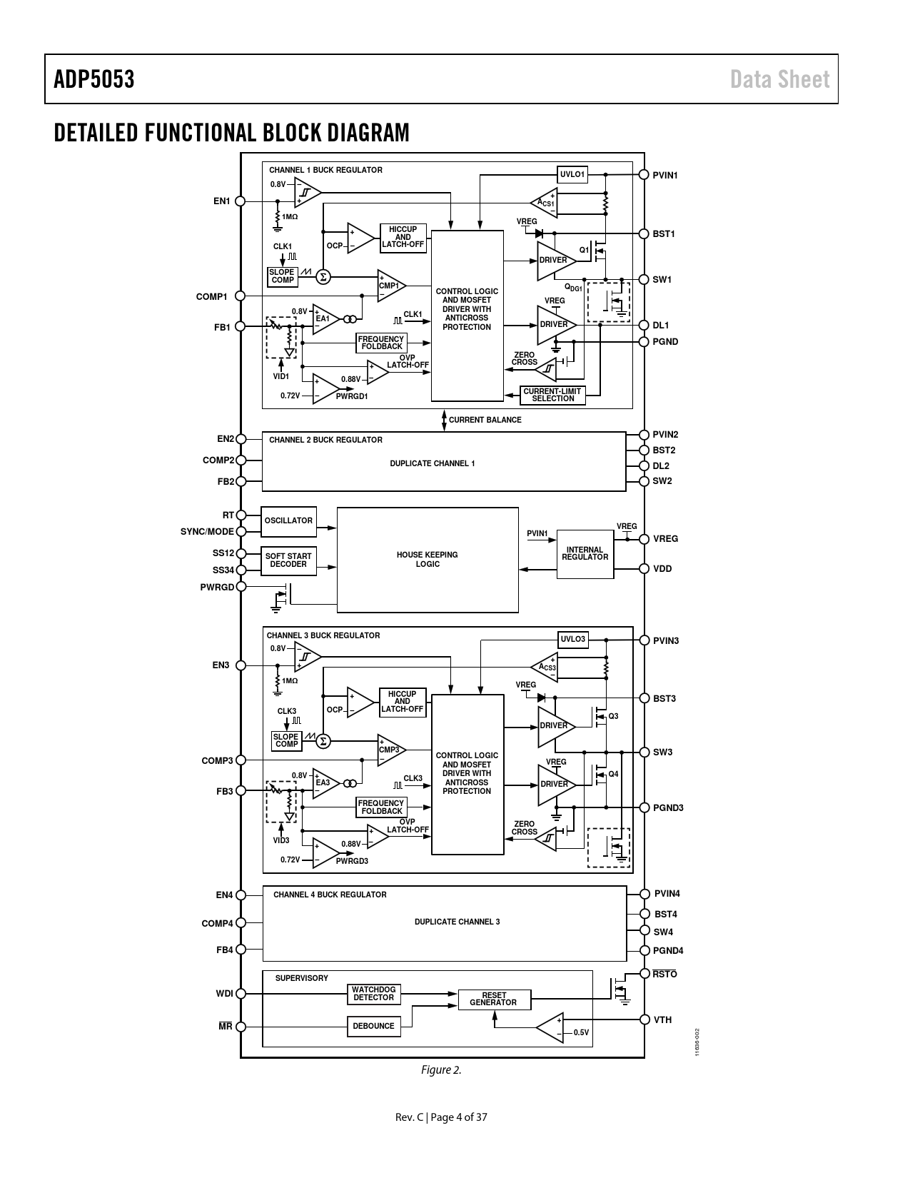

ADP5053. Data Sheet. DETAILED FUNCTIONAL BLOCK DIAGRAM. CHANNEL 1 BUCK REGULATOR. UVLO1. PVIN1. 0.8V. EN1. ACS1. 1MΩ. VREG. HICCUP. BST1. AND. CLK1
ADP5053 Data Sheet DETAILED FUNCTIONAL BLOCK DIAGRAM CHANNEL 1 BUCK REGULATOR UVLO1 PVIN1 0.8V EN1 ACS1 1MΩ VREG HICCUP BST1 AND CLK1
ADP5053 Data Sheet DETAILED FUNCTIONAL BLOCK DIAGRAM CHANNEL 1 BUCK REGULATOR UVLO1 PVIN1 0.8V + EN1 + ACS1 1MΩ VREG HICCUP + BST1 AND CLK1 OCP LATCH-OFF Q1 DRIVER SLOPE COMP + SW1 CMP1 QDG1 CONTROL LOGIC COMP1 AND MOSFET VREG DRIVER WITH 0.8V + CLK1 EA1 ANTICROSS DRIVER FB1 PROTECTION DL1 FREQUENCY PGND FOLDBACK ZERO OVP CROSS + LATCH-OFF VID1 + 0.88V CURRENT-LIMIT 0.72V PWRGD1 SELECTION CURRENT BALANCE PVIN2 EN2 CHANNEL 2 BUCK REGULATOR BST2 COMP2 DUPLICATE CHANNEL 1 DL2 FB2 SW2 RT OSCILLATOR VREG SYNC/MODE PVIN1 VREG SS12 INTERNAL SOFT START HOUSE KEEPING REGULATOR DECODER LOGIC SS34 VDD PWRGD CHANNEL 3 BUCK REGULATOR UVLO3 PVIN3 0.8V + EN3 + ACS3 1MΩ VREG HICCUP + BST3 AND CLK3 OCP LATCH-OFF Q3 DRIVER SLOPE COMP + CMP3 SW3 CONTROL LOGIC COMP3 AND MOSFET VREG DRIVER WITH Q4 0.8V + CLK3 EA3 ANTICROSS DRIVER FB3 PROTECTION FREQUENCY PGND3 FOLDBACK OVP ZERO + LATCH-OFF CROSS VID3 + 0.88V 0.72V PWRGD3 EN4 CHANNEL 4 BUCK REGULATOR PVIN4 BST4 DUPLICATE CHANNEL 3 COMP4 SW4 FB4 PGND4 SUPERVISORY RSTO WDI WATCHDOG RESET DETECTOR GENERATOR + VTH MR DEBOUNCE 0.5V
002 1636- 1 Figure 2. Rev. C | Page 4 of 37 Document Outline FEATURES APPLICATIONS TYPICAL APPLICATION CIRCUIT GENERAL DESCRIPTION TABLE OF CONTENTS REVISION HISTORY DETAILED FUNCTIONAL BLOCK DIAGRAM SPECIFICATIONS BUCK REGULATOR SPECIFICATIONS SUPERVISORY SPECIFICATIONS ABSOLUTE MAXIMUM RATINGS THERMAL RESISTANCE ESD CAUTION PIN CONFIGURATION AND FUNCTION DESCRIPTIONS TYPICAL PERFORMANCE CHARACTERISTICS THEORY OF OPERATION BUCK REGULATOR OPERATIONAL MODES Pulse-Width Modulation (PWM) Mode Power Save Mode (PSM) Forced PWM and Automatic PWM/PSM Modes ADJUSTABLE AND FIXED OUTPUT VOLTAGES INTERNAL REGULATORS (VREG AND VDD) SEPARATE SUPPLY APPLICATIONS LOW-SIDE DEVICE SELECTION BOOTSTRAP CIRCUITRY ACTIVE OUTPUT DISCHARGE SWITCH PRECISION ENABLING OSCILLATOR Phase Shift SYNCHRONIZATION INPUT/OUTPUT SOFT START PARALLEL OPERATION STARTUP WITH PRECHARGED OUTPUT CURRENT-LIMIT PROTECTION FREQUENCY FOLDBACK Pulse Skip Mode Under Maximum Duty Cycle HICCUP PROTECTION LATCH-OFF PROTECTION Short-Circuit Latch-Off Mode Overvoltage Latch-Off Mode UNDERVOLTAGE LOCKOUT (UVLO) POWER-GOOD FUNCTION THERMAL SHUTDOWN SUPERVISORY CIRCUIT Reset Output Watchdog Input Manual Reset Input Processor Manual Reset Mode Power On/Off Switch Mode APPLICATIONS INFORMATION ADIsimPower DESIGN TOOL PROGRAMMING THE ADJUSTABLE OUTPUT VOLTAGE VOLTAGE CONVERSION LIMITATIONS CURRENT-LIMIT SETTING SOFT START SETTING INDUCTOR SELECTION OUTPUT CAPACITOR SELECTION INPUT CAPACITOR SELECTION LOW-SIDE POWER DEVICE SELECTION PROGRAMMING THE UVLO INPUT COMPENSATION COMPONENTS DESIGN POWER DISSIPATION Buck Regulator Power Dissipation Power Switch Conduction Loss (PCOND) Switching Loss (PSW) Transition Loss (PTRAN) Thermal Shutdown JUNCTION TEMPERATURE DESIGN EXAMPLE SETTING THE SWITCHING FREQUENCY SETTING THE OUTPUT VOLTAGE SETTING THE CURRENT LIMIT SELECTING THE INDUCTOR SELECTING THE OUTPUT CAPACITOR SELECTING THE LOW-SIDE MOSFET DESIGNING THE COMPENSATION NETWORK SELECTING THE SOFT START TIME SELECTING THE INPUT CAPACITOR RECOMMENDED EXTERNAL COMPONENTS CIRCUIT BOARD LAYOUT RECOMMENDATIONS TYPICAL APPLICATION CIRCUITS FACTORY DEFAULT OPTIONS OUTLINE DIMENSIONS ORDERING GUIDE
