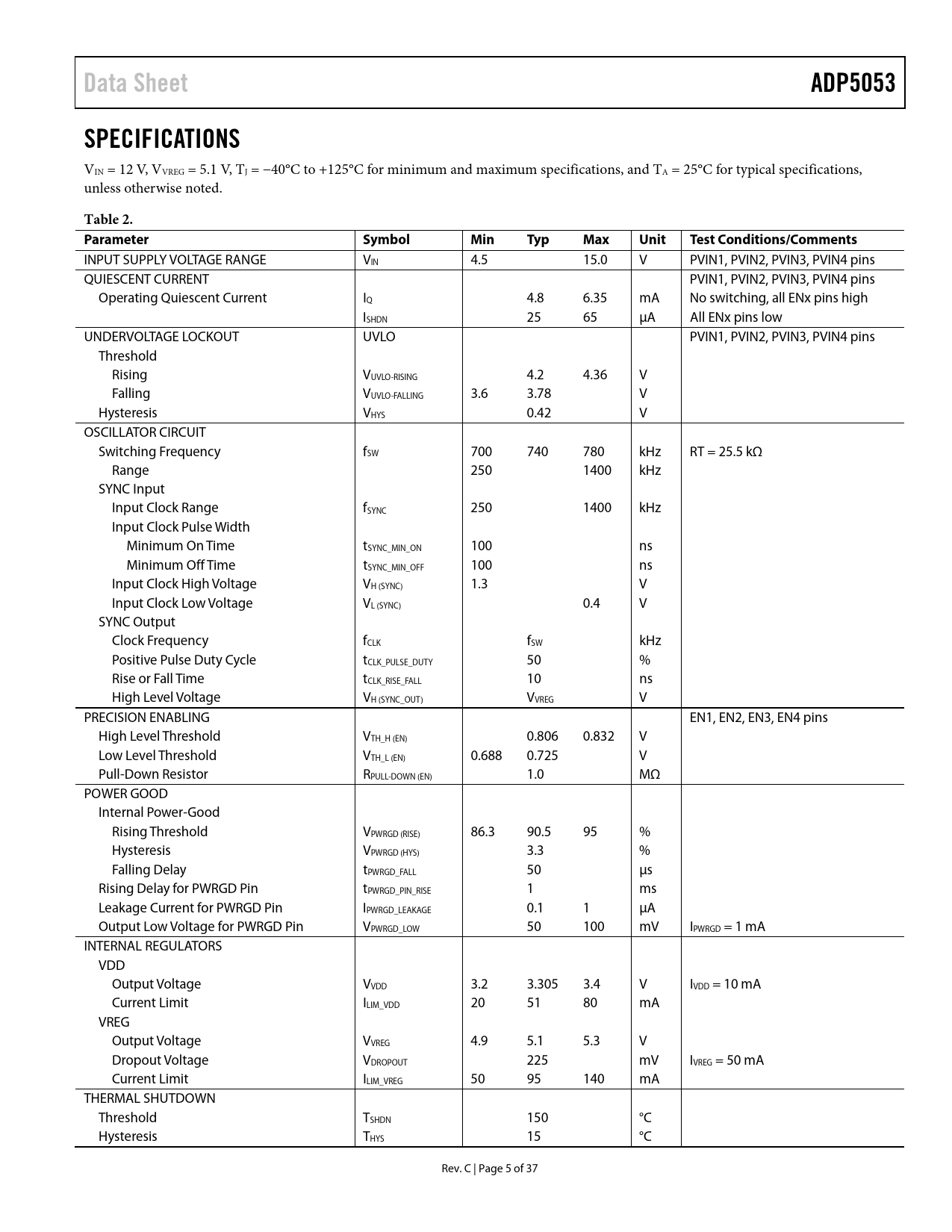

Data Sheet. ADP5053. SPECIFICATIONS. Table 2. Parameter. Symbol. Min. Typ. Max. Unit. Test Conditions/Comments
Data Sheet ADP5053 SPECIFICATIONS Table 2 Parameter Symbol Min Typ Max Unit Test Conditions/Comments
VIN = 12 V, VVREG = 5.1 V, TJ = −40°C to +125°C for minimum and maximum specifications, and TA = 25°C for typical specifications, unless otherwise noted.
Table 2. Parameter Symbol Min Typ Max Unit Test Conditions/Comments
INPUT SUPPLY VOLTAGE RANGE VIN 4.5 15.0 V PVIN1, PVIN2, PVIN3, PVIN4 pins QUIESCENT CURRENT PVIN1, PVIN2, PVIN3, PVIN4 pins Operating Quiescent Current IQ 4.8 6.35 mA No switching, all ENx pins high ISHDN 25 65 µA All ENx pins low UNDERVOLTAGE LOCKOUT UVLO PVIN1, PVIN2, PVIN3, PVIN4 pins Threshold Rising VUVLO-RISING 4.2 4.36 V Falling VUVLO-FALLING 3.6 3.78 V Hysteresis VHYS 0.42 V OSCILLATOR CIRCUIT Switching Frequency fSW 700 740 780 kHz RT = 25.5 kΩ Range 250 1400 kHz SYNC Input Input Clock Range fSYNC 250 1400 kHz Input Clock Pulse Width Minimum On Time tSYNC_MIN_ON 100 ns Minimum Off Time tSYNC_MIN_OFF 100 ns Input Clock High Voltage VH (SYNC) 1.3 V Input Clock Low Voltage VL (SYNC) 0.4 V SYNC Output Clock Frequency fCLK fSW kHz Positive Pulse Duty Cycle tCLK_PULSE_DUTY 50 % Rise or Fall Time tCLK_RISE_FALL 10 ns High Level Voltage VH (SYNC_OUT) VVREG V PRECISION ENABLING EN1, EN2, EN3, EN4 pins High Level Threshold VTH_H (EN) 0.806 0.832 V Low Level Threshold VTH_L (EN) 0.688 0.725 V Pull-Down Resistor RPULL-DOWN (EN) 1.0 MΩ POWER GOOD Internal Power-Good Rising Threshold VPWRGD (RISE) 86.3 90.5 95 % Hysteresis VPWRGD (HYS) 3.3 % Falling Delay tPWRGD_FALL 50 µs Rising Delay for PWRGD Pin tPWRGD_PIN_RISE 1 ms Leakage Current for PWRGD Pin IPWRGD_LEAKAGE 0.1 1 µA Output Low Voltage for PWRGD Pin VPWRGD_LOW 50 100 mV IPWRGD = 1 mA INTERNAL REGULATORS VDD Output Voltage VVDD 3.2 3.305 3.4 V IVDD = 10 mA Current Limit ILIM_VDD 20 51 80 mA VREG Output Voltage VVREG 4.9 5.1 5.3 V Dropout Voltage VDROPOUT 225 mV IVREG = 50 mA Current Limit ILIM_VREG 50 95 140 mA THERMAL SHUTDOWN Threshold TSHDN 150 °C Hysteresis THYS 15 °C Rev. C | Page 5 of 37 Document Outline FEATURES APPLICATIONS TYPICAL APPLICATION CIRCUIT GENERAL DESCRIPTION TABLE OF CONTENTS REVISION HISTORY DETAILED FUNCTIONAL BLOCK DIAGRAM SPECIFICATIONS BUCK REGULATOR SPECIFICATIONS SUPERVISORY SPECIFICATIONS ABSOLUTE MAXIMUM RATINGS THERMAL RESISTANCE ESD CAUTION PIN CONFIGURATION AND FUNCTION DESCRIPTIONS TYPICAL PERFORMANCE CHARACTERISTICS THEORY OF OPERATION BUCK REGULATOR OPERATIONAL MODES Pulse-Width Modulation (PWM) Mode Power Save Mode (PSM) Forced PWM and Automatic PWM/PSM Modes ADJUSTABLE AND FIXED OUTPUT VOLTAGES INTERNAL REGULATORS (VREG AND VDD) SEPARATE SUPPLY APPLICATIONS LOW-SIDE DEVICE SELECTION BOOTSTRAP CIRCUITRY ACTIVE OUTPUT DISCHARGE SWITCH PRECISION ENABLING OSCILLATOR Phase Shift SYNCHRONIZATION INPUT/OUTPUT SOFT START PARALLEL OPERATION STARTUP WITH PRECHARGED OUTPUT CURRENT-LIMIT PROTECTION FREQUENCY FOLDBACK Pulse Skip Mode Under Maximum Duty Cycle HICCUP PROTECTION LATCH-OFF PROTECTION Short-Circuit Latch-Off Mode Overvoltage Latch-Off Mode UNDERVOLTAGE LOCKOUT (UVLO) POWER-GOOD FUNCTION THERMAL SHUTDOWN SUPERVISORY CIRCUIT Reset Output Watchdog Input Manual Reset Input Processor Manual Reset Mode Power On/Off Switch Mode APPLICATIONS INFORMATION ADIsimPower DESIGN TOOL PROGRAMMING THE ADJUSTABLE OUTPUT VOLTAGE VOLTAGE CONVERSION LIMITATIONS CURRENT-LIMIT SETTING SOFT START SETTING INDUCTOR SELECTION OUTPUT CAPACITOR SELECTION INPUT CAPACITOR SELECTION LOW-SIDE POWER DEVICE SELECTION PROGRAMMING THE UVLO INPUT COMPENSATION COMPONENTS DESIGN POWER DISSIPATION Buck Regulator Power Dissipation Power Switch Conduction Loss (PCOND) Switching Loss (PSW) Transition Loss (PTRAN) Thermal Shutdown JUNCTION TEMPERATURE DESIGN EXAMPLE SETTING THE SWITCHING FREQUENCY SETTING THE OUTPUT VOLTAGE SETTING THE CURRENT LIMIT SELECTING THE INDUCTOR SELECTING THE OUTPUT CAPACITOR SELECTING THE LOW-SIDE MOSFET DESIGNING THE COMPENSATION NETWORK SELECTING THE SOFT START TIME SELECTING THE INPUT CAPACITOR RECOMMENDED EXTERNAL COMPONENTS CIRCUIT BOARD LAYOUT RECOMMENDATIONS TYPICAL APPLICATION CIRCUITS FACTORY DEFAULT OPTIONS OUTLINE DIMENSIONS ORDERING GUIDE
