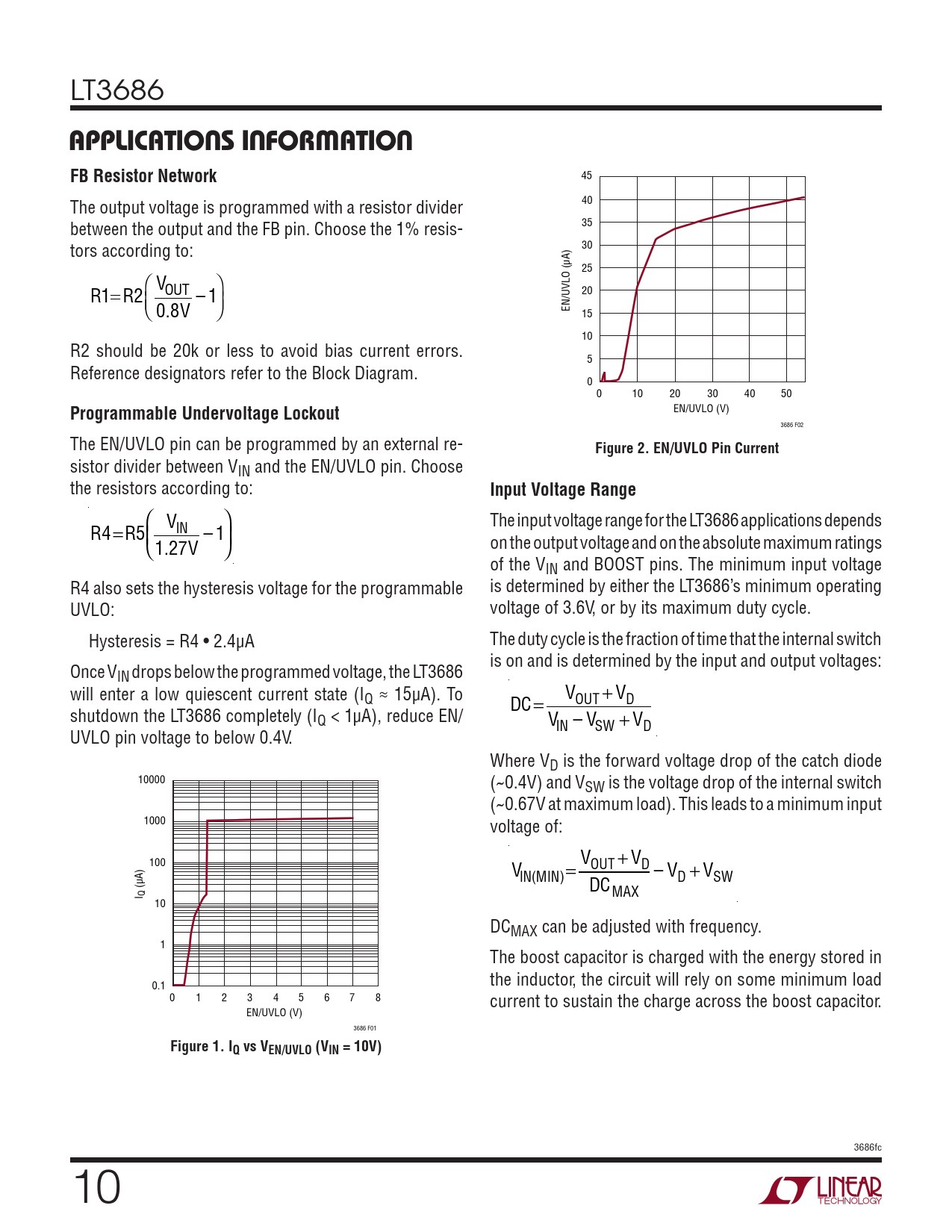

ApplicAtions inForMAtion. FB Resistor Network. Programmable Undervoltage Lockout. Figure 2. EN/UVLO Pin Current
ApplicAtions inForMAtion FB Resistor Network Programmable Undervoltage Lockout Figure 2 EN/UVLO Pin Current
LT3686
45 The output voltage is programmed with a resistor divider 40 between the output and the FB pin. Choose the 1% resis- 35 tors according to: 30 25 ⎛ V R1 OUT ⎞ 20 = R2 – 1 EN/UVLO (µA) ⎝⎜ 0.8V ⎠⎟ 15 10 R2 should be 20k or less to avoid bias current errors. 5 Reference designators refer to the Block Diagram. 0 0 10 20 30 40 50
EN/UVLO (V) 3686 F02 The EN/UVLO pin can be programmed by an external re-
sistor divider between VIN and the EN/UVLO pin. Choose the resistors according to:
Input Voltage Range
 V  The input voltage range for the LT3686 applications depends R4=R5 IN  – 1 on the output voltage and on the absolute maximum ratings 1.27V  of the VIN and BOOST pins. The minimum input voltage R4 also sets the hysteresis voltage for the programmable is determined by either the LT3686’s minimum operating UVLO: voltage of 3.6V, or by its maximum duty cycle. Hysteresis = R4 • 2.4µA The duty cycle is the fraction of time that the internal switch is on and is determined by the input and output voltages: Once VIN drops below the programmed voltage, the LT3686 will enter a low quiescent current state (I V Q ≈ 15µA). To DC= OUT + VD shutdown the LT3686 completely (IQ < 1µA), reduce EN/ VIN – VSW + VD UVLO pin voltage to below 0.4V. Where VD is the forward voltage drop of the catch diode 10000 (~0.4V) and VSW is the voltage drop of the internal switch (~0.67V at maximum load). This leads to a minimum input 1000 voltage of: 100 V V OUT + VD IN(MIN)= – VD + VSW (µA) I Q DCMAX 10 DCMAX can be adjusted with frequency. 1 The boost capacitor is charged with the energy stored in 0.1 the inductor, the circuit will rely on some minimum load 0 1 2 3 4 5 6 7 8 current to sustain the charge across the boost capacitor. EN/UVLO (V) 3686 F01
Figure 1. IQ vs VEN/UVLO (VIN = 10V)
