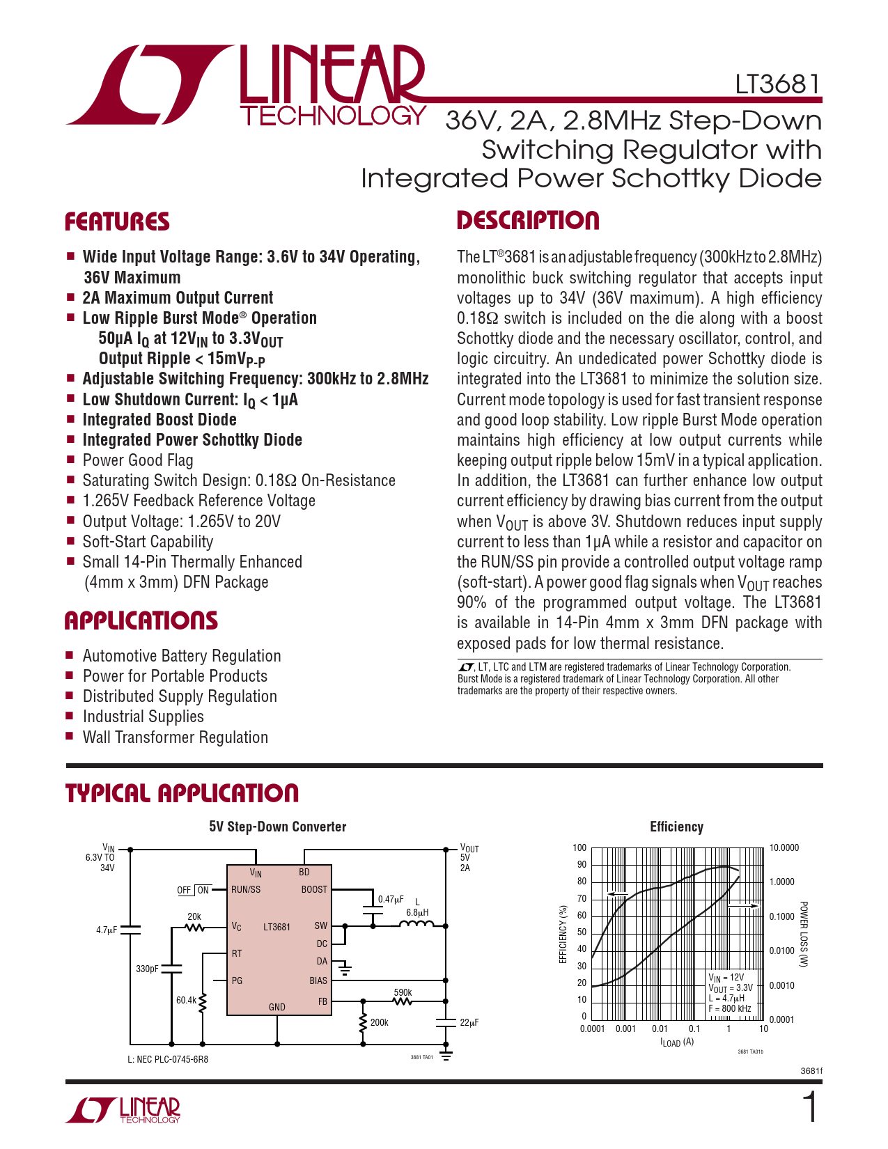

LT3681 36V, 2A, 2.8MHz Step-Down Switching Regulator with Integrated Power Schottky Diode
U FEATURES DESCRIPTIO
Wide Input Voltage Range: 3.6V to 34V Operating,
The LT®3681 is an adjustable frequency (300kHz to 2.8MHz)
36V Maximum
monolithic buck switching regulator that accepts input ■
2A Maximum Output Current
voltages up to 34V (36V maximum). A high effi ciency ■
Low Ripple Burst Mode® Operation
0.18Ω switch is included on the die along with a boost
50µA I
Schottky diode and the necessary oscillator, control, and
Q at 12VIN to 3.3VOUT Output Ripple < 15mV
logic circuitry. An undedicated power Schottky diode is
P-P
Adjustable Switching Frequency: 300kHz to 2.8MHz
integrated into the LT3681 to minimize the solution size. ■
Low Shutdown Current: I
Current mode topology is used for fast transient response
Q < 1µA
Integrated Boost Diode
and good loop stability. Low ripple Burst Mode operation ■
maintains high effi ciency at low output currents while ■ Power Good Flag keeping output ripple below 15mV in a typical application. ■ Saturating Switch Design: 0.18Ω On-Resistance In addition, the LT3681 can further enhance low output ■ 1.265V Feedback Reference Voltage current effi ciency by drawing bias current from the output ■ Output Voltage: 1.265V to 20V when VOUT is above 3V. Shutdown reduces input supply ■ Soft-Start Capability current to less than 1µA while a resistor and capacitor on ■ Small 14-Pin Thermally Enhanced the RUN/SS pin provide a controlled output voltage ramp (4mm x 3mm) DFN Package (soft-start). A power good fl ag signals when VOUT reaches
U
90% of the programmed output voltage. The LT3681
APPLICATIO S
is available in 14-Pin 4mm x 3mm DFN package with exposed pads for low thermal resistance. ■ Automotive Battery Regulation , LT, LTC and LTM are registered trademarks of Linear Technology Corporation. ■ Power for Portable Products Burst Mode is a registered trademark of Linear Technology Corporation. All other ■ Distributed Supply Regulation trademarks are the property of their respective owners. ■ Industrial Supplies ■ Wall Transformer Regulation
U TYPICAL APPLICATIO 5V Step-Down Converter Effi ciency
