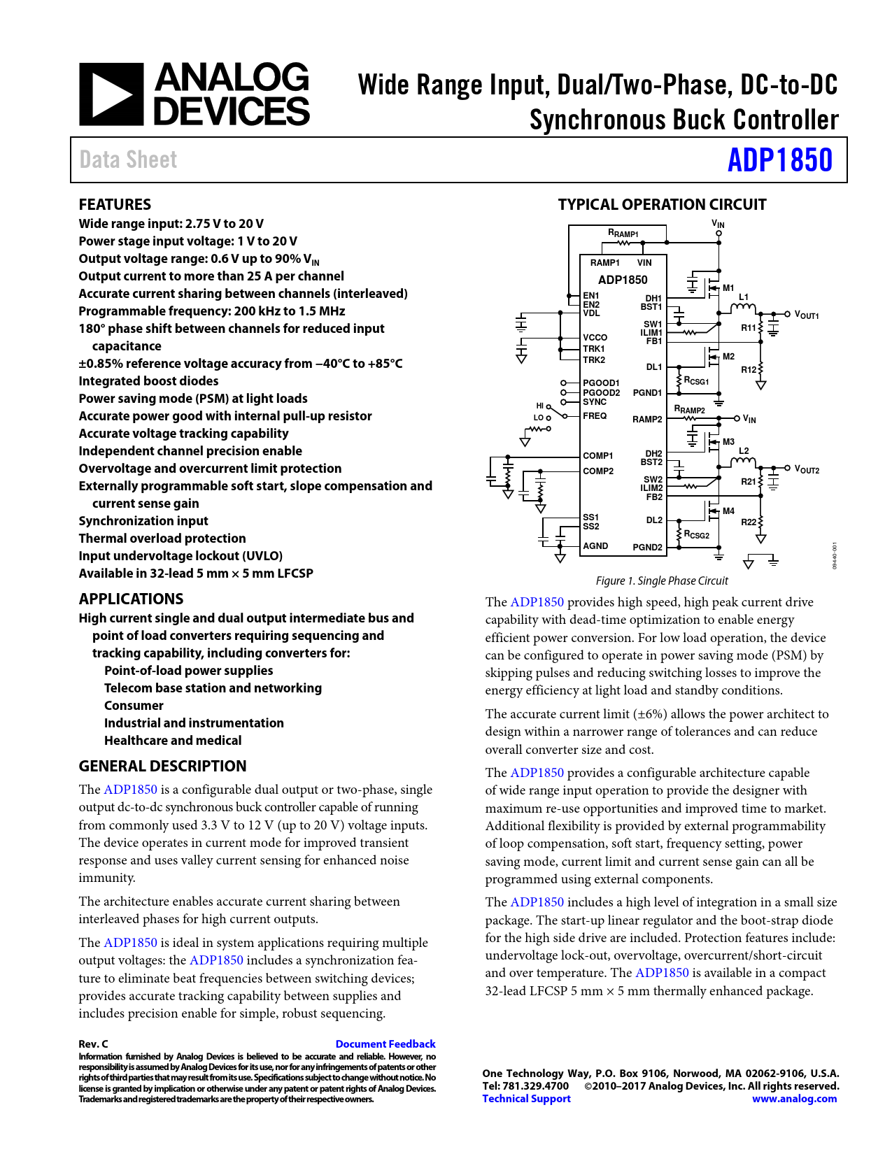

Wide Range Input, Dual/Two-Phase, DC-to-DC. Synchronous Buck Controller. Data Sheet. ADP1850. FEATURES. TYPICAL OPERATION CIRCUIT
Datasheet ADP1850 Analog Devices, Revision: C
Wide Range Input, Dual/Two-Phase, DC-to-DC Synchronous Buck Controller Data Sheet ADP1850 FEATURES TYPICAL OPERATION CIRCUIT Wide range input: 2.75 V to 20 V VIN R Power stage input voltage: 1 V to 20 V RAMP1 Output voltage range: 0.6 V up to 90% V IN RAMP1 VIN Output current to more than 25 A per channel ADP1850 Accurate current sharing between channels (interleaved) M1 EN1 DH1 L1 Programmable frequency: 200 kHz to 1.5 MHz EN2 BST1 VDL VOUT1 180° phase shift between channels for reduced input SW1 R11 ILIM1 capacitance VCCO FB1 TRK1 ±0.85% reference voltage accuracy from −40°C to +85°C TRK2 M2 DL1 R12 Integrated boost diodes RCSG1 PGOOD1 Power saving mode (PSM) at light loads PGOOD2 PGND1 SYNC HI Accurate power good with internal pull-up resistor RRAMP2 FREQ LO RAMP2 VIN Accurate voltage tracking capability M3 Independent channel precision enable DH2 L2 COMP1 Overvoltage and overcurrent limit protection BST2 COMP2 VOUT2 Externally programmable soft start, slope compensation and SW2 R21 ILIM2 current sense gain FB2 M4 Synchronization input SS1 DL2 SS2 R22 Thermal overload protection RCSG2 AGND PGND2 Input undervoltage lockout (UVLO)
001
Available in 32-lead 5 mm × 5 mm LFCSP
09440- Figure 1. Single Phase Circuit
