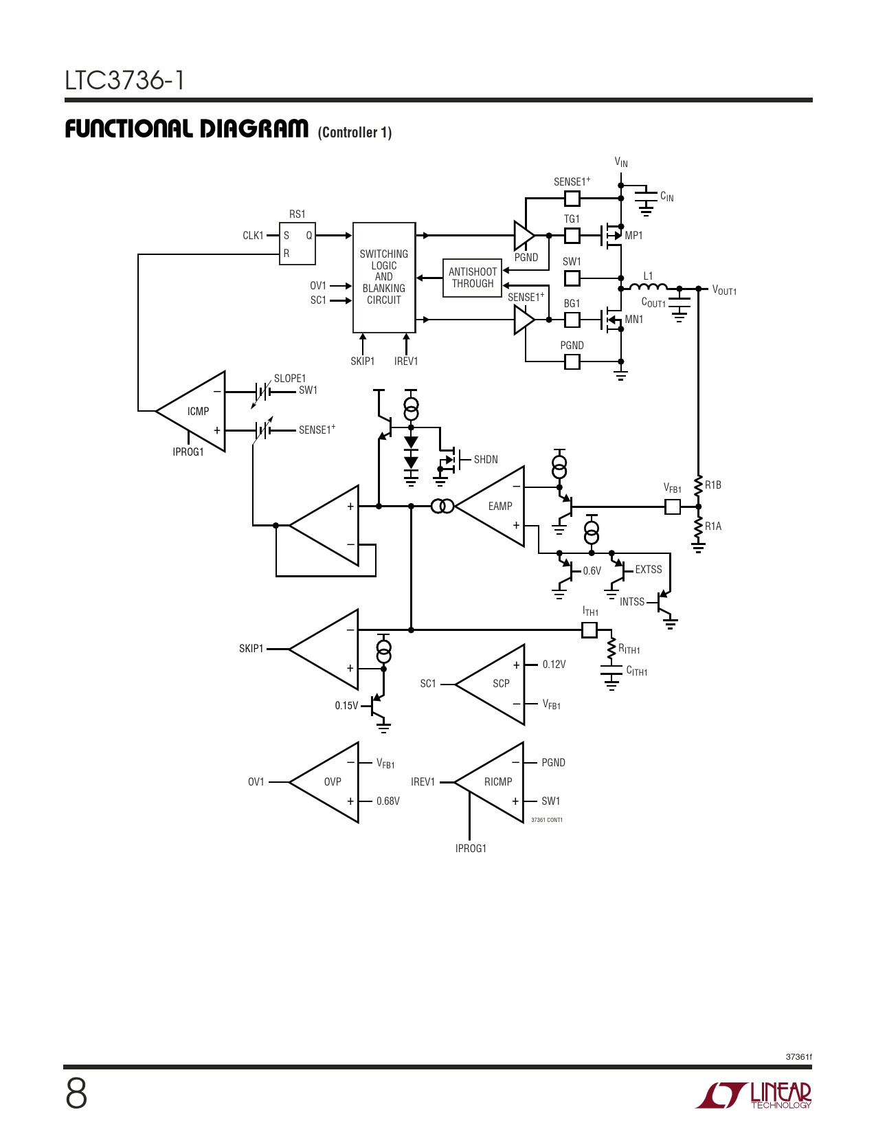

FU CTIO AL DIAGRA (Controller 1)
LTC3736-1
U U W FU CTIO AL DIAGRA (Controller 1)
VIN SENSE1+ CIN RS1 TG1 CLK1 S Q MP1 R SWITCHING PGND SW1 LOGIC ANTISHOOT AND L1 OV1 THROUGH BLANKING VOUT1 SC1 SENSE1+ CIRCUIT C BG1 OUT1 MN1 PGND SKIP1 IREV1 SLOPE1 – SW1 ICMP + SENSE1+ IPROG1 SHDN – R1B VFB1 + EAMP + R1A – 0.6V EXTSS INTSS ITH1 – SKIP1 RITH1 + + 0.12V CITH1 SC1 SCP V 0.15V – FB1 – VFB1 – PGND OV1 OVP IREV1 RICMP + 0.68V + SW1 37361 CONT1 IPROG1 37361f 8
