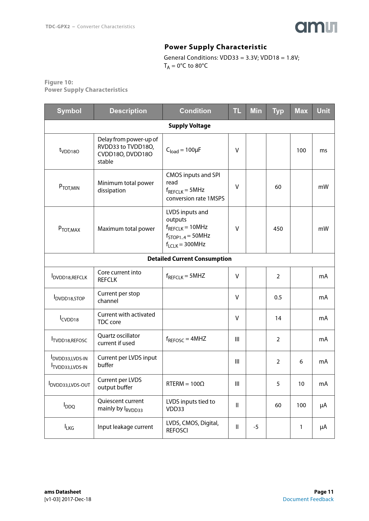

TDC-GPX2 −. Power Supply Characteristic. Figure 10: Power Supply Characteristics. Symbol. Description. Condition. Min. Typ. Max. Unit
TDC-GPX2 − Power Supply Characteristic Figure 10: Power Supply Characteristics Symbol Description Condition Min Typ Max Unit
TDC-GPX2 −
Converter Characteristics
General Conditions: VDD33 = 3.3V; VDD18 = 1.8V; TA = 0°C to 80°C
Figure 10: Power Supply Characteristics Symbol Description Condition TL Min Typ Max Unit Supply Voltage
Delay from power-up of RVDD33 to TVDD18O, tVDD18O C CVDD18O, DVDD18O load = 100μF V 100 ms stable CMOS inputs and SPI Minimum total power read PTOT,MIN V 60 mW dissipation fREFCLK = 5MHz conversion rate 1MSPS LVDS inputs and outputs P f TOT,MAX Maximum total power REFCLK = 10MHz V 450 mW fSTOP1..4 = 50MHz fLCLK = 300MHz
Detailed Current Consumption
Core current into IDVDD18,REFCLK f REFCLK REFCLK = 5MHZ V 2 mA Current per stop IDVDD18,STOP V 0.5 mA channel Current with activated ICVDD18 V 14 mA TDC core Quartz oscillator ITVDD18,REFOSC f current if used REFOSC = 4MHZ III 2 mA IDVDD33,LVDS-IN Current per LVDS input III 2 6 mA ITVDD33,LVDS-IN buffer Current per LVDS IDVDD33,LVDS-OUT RTERM = 100Ω III 5 10 mA output buffer Quiescent current LVDS inputs tied to IDDQ II 60 100 μA mainly by IRVDD33 VDD33 LVDS, CMOS, Digital, ILKG Input leakage current II -5 1 μA REFOSCI
