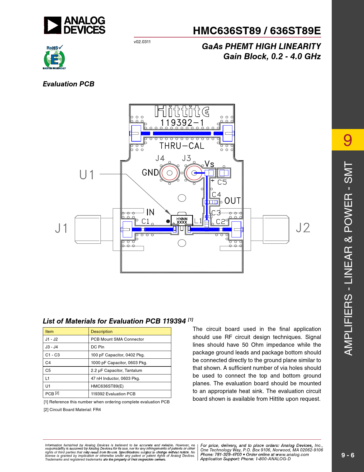

HMC636ST89 / 636ST89E. GaAs pHEMT HiGH LinEAriTy. Gain Block, 0.2 - 4.0 GHz. Evaluation pCB
HMC636ST89 / 636ST89E GaAs pHEMT HiGH LinEAriTy Gain Block, 0.2 - 4.0 GHz Evaluation pCB
v02.0311
9 T m s r - e w o p r & A e lin s - r ie
List of Materials for Evaluation pCB 119394 [1]
The circuit board used in the final application item Description lif should use rf circuit design techniques. signal J1 - J2 pCB mount smA Connector p lines should have 50 ohm impedance while the J3 - J4 DC pin m package ground leads and package bottom should C1 - C3 100 pf Capacitor, 0402 pkg. A be connected directly to the ground plane similar to C4 1000 pf Capacitor, 0603 pkg. that shown. A sufficient number of via holes should C5 2.2 µf Capacitor, Tantalum be used to connect the top and bottom ground l1 47 nH inductor, 0603 pkg. planes. The evaluation board should be mounted U1 HmC636sT89(e) to an appropriate heat sink. The evaluation circuit pCB [2] 119392 evaluation pCB board shown is available from Hittite upon request. [1] reference this number when ordering complete evaluation pCB [2] Circuit Board material: fr4 Inf F or o m rat ip o r n ifc ur e n ,is hd e e d lbiv y e Anry alo a g n D d evi cto es ips la beclie ev eo d rtd o e b r e sa: ccH ur iattte itaen M d reliic a r bl o e w . H a o v weev eC r, o n r o For price, delivery, and to place orders: Analog Devices, Inc., responsibility is assumed by Analog Devices for its use, nor for any infringements of patents or other poration, 20 Alpha Road, Chelmsford, MA 01824 One Technology Way, P.O. Box 9106, Norwood, MA 02062-9106 Phone: 978-250-3343 Fax: 978-250-3373 rights of third parties that may result from its use. Specifications subject to change without notice. No Or P d hoe n r e O : 7 n- 81-li 3 n 2 e 9- a 4 t 7 0 www 0 • O . rdh e itt r o it n e li . n co e a m license is granted by implication or otherwise under any patent or patent rights of Analog Devices. t www.analog.com
