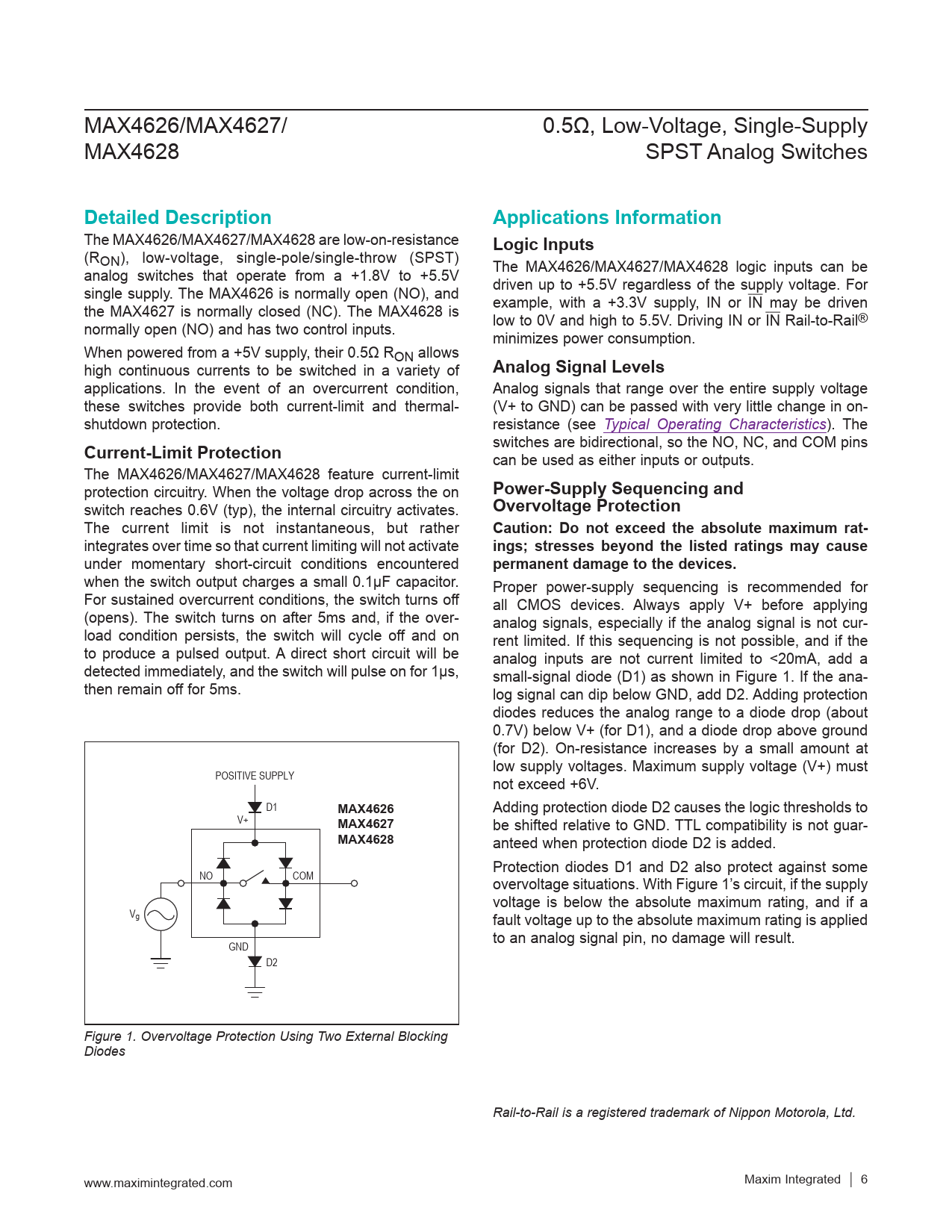

when the switch output charges a small 0.1μF capacitor. Proper power-supply sequencing is recommended for For sustained overcurrent conditions, the switch turns off all CMOS devices. Always apply V+ before applying (opens). The switch turns on after 5ms and, if the over- analog signals, especially if the analog signal is not cur- load condition persists, the switch will cycle off and on rent limited. If this sequencing is not possible, and if the to produce a pulsed output. A direct short circuit will be analog inputs are not current limited to <20mA, add a detected immediately, and the switch will pulse on for 1μs, small-signal diode (D1) as shown in Figure 1. If the ana- then remain off for 5ms. log signal can dip below GND, add D2. Adding protection diodes reduces the analog range to a diode drop (about 0.7V) below V+ (for D1), and a diode drop above ground (for D2). On-resistance increases by a small amount at low supply voltages. Maximum supply voltage (V+) must POSITIVE SUPPLY not exceed +6V. D1
MAX4626
Adding protection diode D2 causes the logic thresholds to V+
MAX4627
be shifted relative to GND. TTL compatibility is not guar-
MAX4628
anteed when protection diode D2 is added. Protection diodes D1 and D2 also protect against some NO COM overvoltage situations. With Figure 1’s circuit, if the supply voltage is below the absolute maximum rating, and if a Vg fault voltage up to the absolute maximum rating is applied to an analog signal pin, no damage will result. GND D2 Figure 1. Overvoltage Protection Using Two External Blocking Diodes Rail-to-Rail is a registered trademark of Nippon Motorola, Ltd. www.maximintegrated.com Maxim Integrated │
