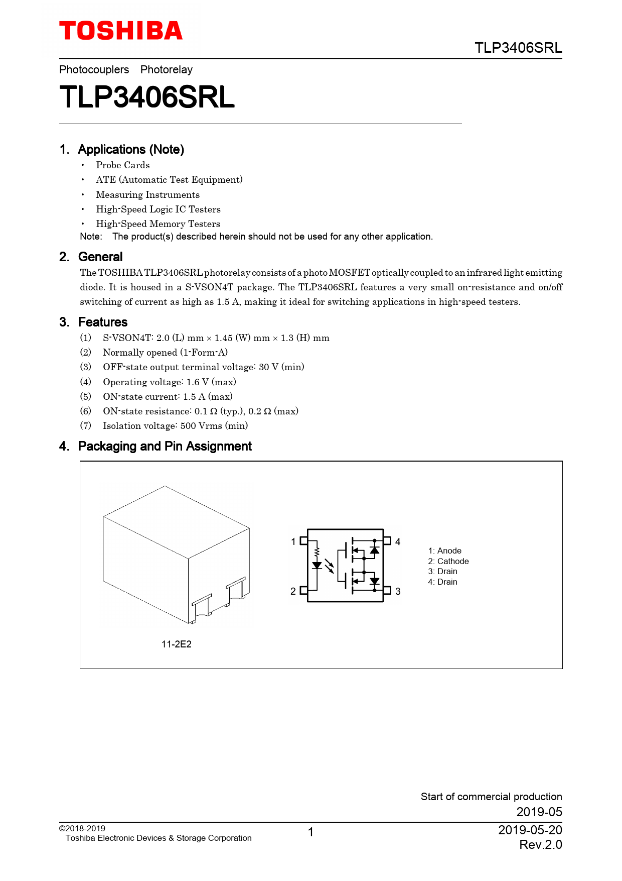

TLP3406SRL Photocouplers Photorelay TLP3406SRL 1. Applications (Note) • Probe Cards • ATE (Automatic Test Equipment) • Measuring Instruments • High-Speed Logic IC Testers • High-Speed Memory Testers Note: The product(s) described herein should not be used for any other application. 2. General The TOSHIBA TLP3406SRL photorelay consists of a photo MOSFET optically coupled to an infrared light emitting diode. It is housed in a S-VSON4T package. The TLP3406SRL features a very small on-resistance and on/off switching of current as high as 1.5 A, making it ideal for switching applications in high-speed testers. 3. Features (1) S-VSON4T: 2.0 (L) mm × 1.45 (W) mm × 1.3 (H) mm (2) Normally opened (1-Form-A) (3) OFF-state output terminal voltage: 30 V (min) (4) Operating voltage: 1.6 V (max) (5) ON-state current: 1.5 A (max) (6) ON-state resistance: 0.1 Ω (typ.), 0.2 Ω (max) (7) Isolation voltage: 500 Vrms (min) 4. Packaging and Pin Assignment 1: Anode 2: Cathode 3: Drain 4: Drain 11-2E2 Start of commercial production 2019-05 ©2018-2019 1 2019-05-20 Toshiba Electronic Devices & Storage Corporation Rev.2.0
