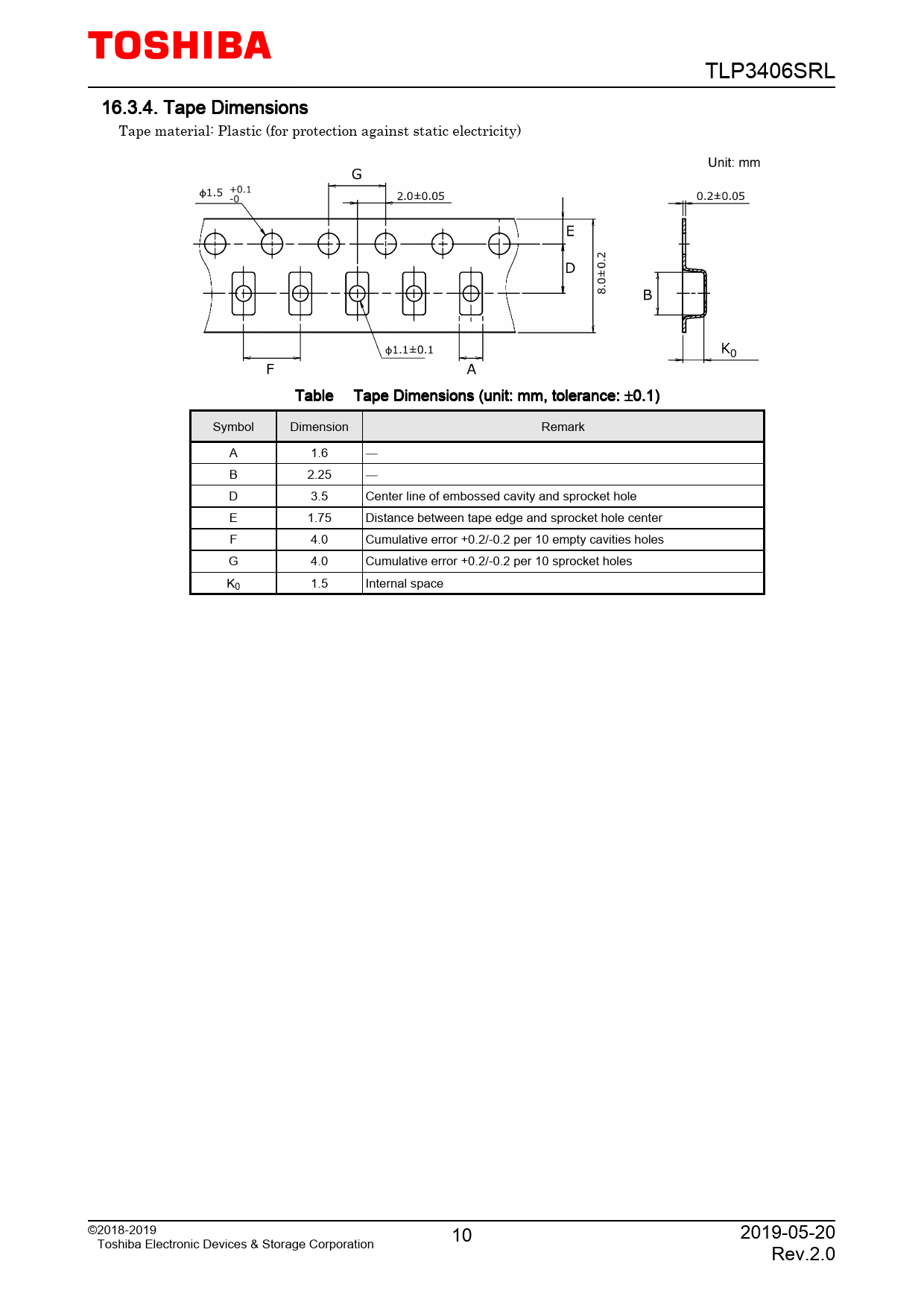

TLP3406SRL. 16.3.4. Tape. Dimensions. Tape. material:. Plastic. (for. protection. against. static. electricity). Table. Tape. Dimensions. (unit:. mm,
TLP3406SRL 16.3.4. Tape Dimensions Tape material: Plastic (for protection against static electricity) Table Tape Dimensions (unit: mm, tolerance: ±0.1) Symbol Dimension Remark A 1.6 B 2.25 D 3.5 Center line of embossed cavity and sprocket hole E 1.75 Distance between tape edge and sprocket hole center F 4.0 Cumulative error +0.2/-0.2 per 10 empty cavities holes G 4.0 Cumulative error +0.2/-0.2 per 10 sprocket holes K0 1.5 Internal space ©2018-2019 10 2019-05-20 Toshiba Electronic Devices & Storage Corporation Rev.2.0
