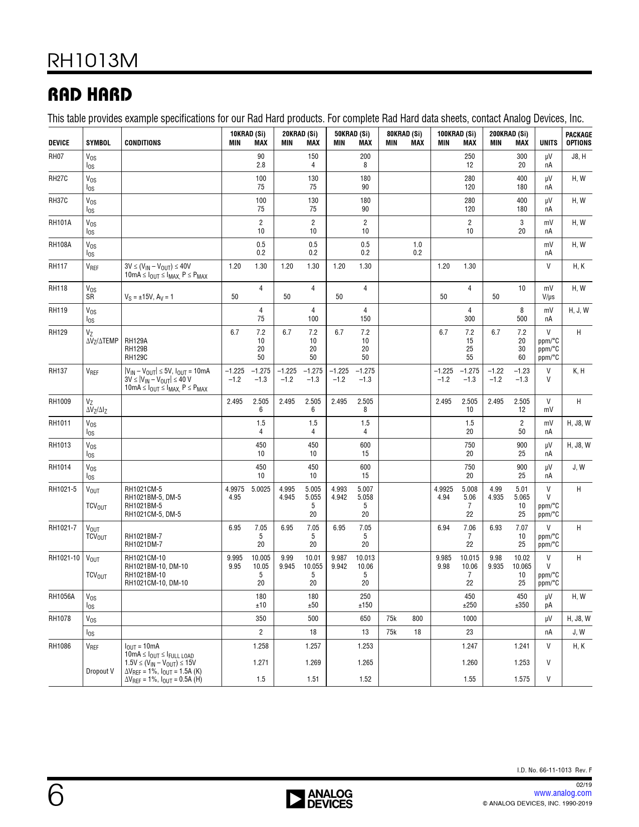

RAD HARD. 10KRAD (Si). 20KRAD (Si). 50KRAD (Si). 80KRAD (Si). 100KRAD (Si). 200KRAD (Si). PACKAGE. DEVICE. SYMBOL. CONDITIONS. MIN. MAX
RAD HARD 10KRAD (Si) 20KRAD (Si) 50KRAD (Si) 80KRAD (Si) 100KRAD (Si) 200KRAD (Si) PACKAGE DEVICE SYMBOL CONDITIONS MIN MAX
RH1013M
RAD HARD
This table provides example specifications for our Rad Hard products. For complete Rad Hard data sheets, contact Analog Devices, Inc.
10KRAD (Si) 20KRAD (Si) 50KRAD (Si) 80KRAD (Si) 100KRAD (Si) 200KRAD (Si) PACKAGE DEVICE SYMBOL CONDITIONS MIN MAX MIN MAX MIN MAX MIN MAX MIN MAX MIN MAX UNITS OPTIONS
RH07 VOS 90 150 200 250 300 µV J8, H IOS 2.8 4 8 12 20 nA RH27C VOS 100 130 180 280 400 µV H, W IOS 75 75 90 120 180 nA RH37C VOS 100 130 180 280 400 µV H, W IOS 75 75 90 120 180 nA RH101A VOS 2 2 2 2 3 mV H, W IOS 10 10 10 10 20 nA RH108A VOS 0.5 0.5 0.5 1.0 mV H, W IOS 0.2 0.2 0.2 0.2 nA RH117 VREF 3V ≤ (VIN – VOUT) ≤ 40V 1.20 1.30 1.20 1.30 1.20 1.30 1.20 1.30 V H, K 10mA ≤ IOUT ≤ IMAX, P ≤ PMAX RH118 VOS 4 4 4 4 10 mV H, W SR VS = ±15V, AV = 1 50 50 50 50 50 V/µs RH119 VOS 4 4 4 4 8 mV H, J, W IOS 75 100 150 300 500 nA RH129 VZ 6.7 7.2 6.7 7.2 6.7 7.2 6.7 7.2 6.7 7.2 V H ∆VZ/∆TEMP RH129A 10 10 10 15 20 ppm/°C RH129B 20 20 20 25 30 ppm/°C RH129C 50 50 50 55 60 ppm/°C RH137 VREF |VIN – VOUT| ≤ 5V, IOUT = 10mA –1.225 –1.275 –1.225 –1.275 –1.225 –1.275 –1.225 –1.275 –1.22 –1.23 V K, H 3V ≤ |VIN – VOUT| ≤ 40 V –1.2 –1.3 –1.2 –1.3 –1.2 –1.3 –1.2 –1.3 –1.2 –1.3 V 10mA ≤ IOUT ≤ IMAX, P ≤ PMAX RH1009 VZ 2.495 2.505 2.495 2.505 2.495 2.505 2.495 2.505 2.495 2.505 V H ∆VZ/∆IZ 6 6 8 10 12 mV RH1011 VOS 1.5 1.5 1.5 1.5 2 mV H, J8, W IOS 4 4 4 20 50 nA RH1013 VOS 450 450 600 750 900 µV H, J8, W IOS 10 10 15 20 25 nA RH1014 VOS 450 450 600 750 900 µV J, W IOS 10 10 15 20 25 nA RH1021-5 VOUT RH1021CM-5 4.9975 5.0025 4.995 5.005 4.993 5.007 4.9925 5.008 4.99 5.01 V H RH1021BM-5, DM-5 4.95 4.945 5.055 4.942 5.058 4.94 5.06 4.935 5.065 V TCVOUT RH1021BM-5 5 5 7 10 ppm/°C RH1021CM-5, DM-5 20 20 22 25 ppm/°C RH1021-7 VOUT 6.95 7.05 6.95 7.05 6.95 7.05 6.94 7.06 6.93 7.07 V H TCVOUT RH1021BM-7 5 5 5 7 10 ppm/°C RH1021DM-7 20 20 20 22 25 ppm/°C RH1021-10 VOUT RH1021CM-10 9.995 10.005 9.99 10.01 9.987 10.013 9.985 10.015 9.98 10.02 V H RH1021BM-10, DM-10 9.95 10.05 9.945 10.055 9.942 10.06 9.98 10.06 9.935 10.065 V TCVOUT RH1021BM-10 5 5 5 7 10 ppm/°C RH1021CM-10, DM-10 20 20 20 22 25 ppm/°C RH1056A VOS 180 180 250 450 450 µV H, W IOS ±10 ±50 ±150 ±250 ±350 pA RH1078 VOS 350 500 650 75k 800 1000 µV H, J8, W IOS 2 18 13 75k 18 23 nA J, W RH1086 VREF IOUT = 10mA 1.258 1.257 1.253 1.247 1.241 V H, K 10mA ≤ IOUT ≤ IFULL LOAD 1.5V ≤ (VIN – VOUT) ≤ 15V 1.271 1.269 1.265 1.260 1.253 V Dropout V ∆VREF = 1%, IOUT = 1.5A (K) ∆VREF = 1%, IOUT = 0.5A (H) 1.5 1.51 1.52 1.55 1.575 V Rev. F I.D. No. 66-11-1013 Rev. F 6 02/19 www.analog.com ANALOG DEVICES, INC. 1990-2019 Document Outline Description Burn-In Circuit Package/Order Information Absolute Maximum Ratings Total Dose Bias Circuit Table 1: Electrical characteristics Table 1a: Electrical characteristics Table 2: Electrical Test Requirements Typical Performance Characteristics Revision History Rad Hard
