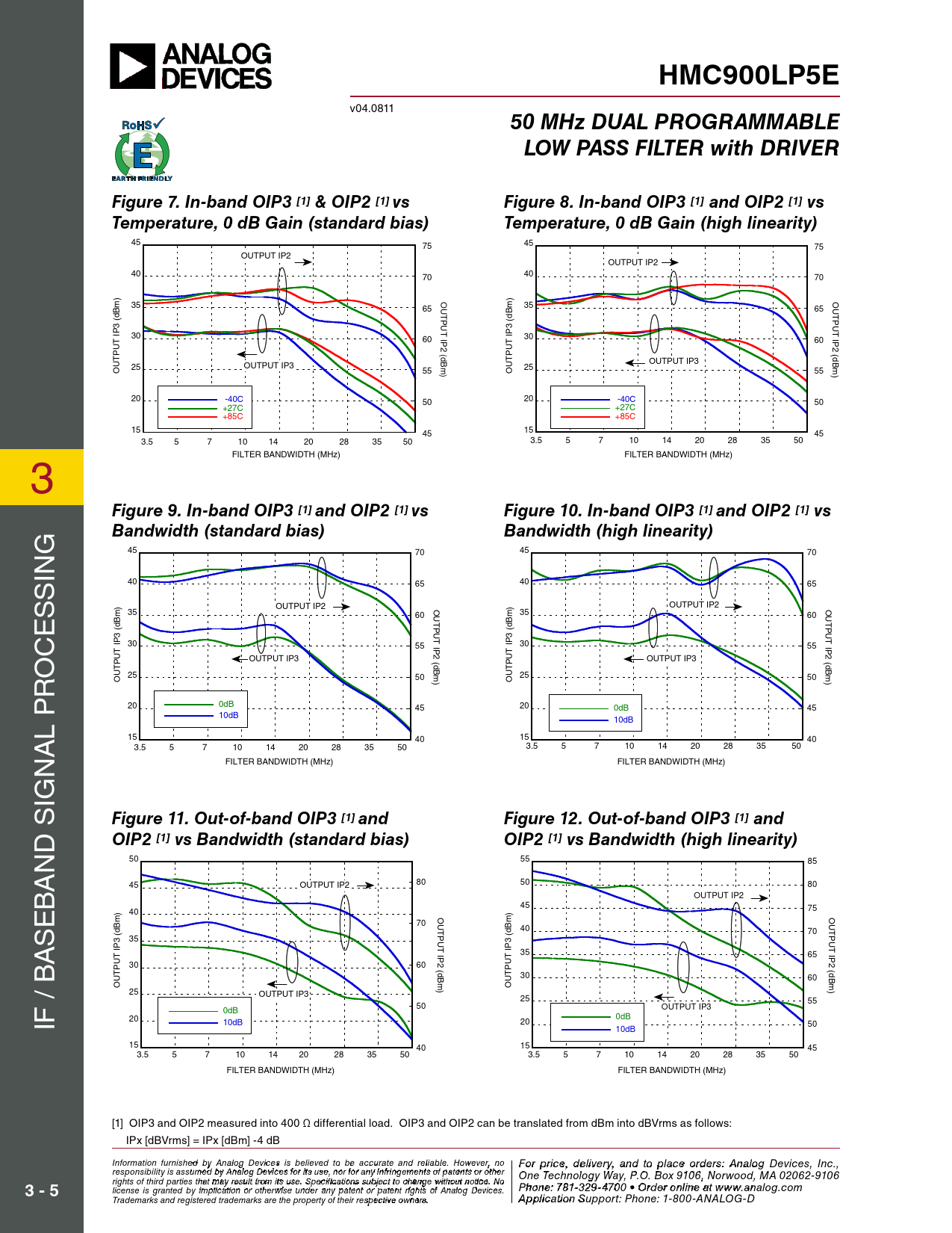

HMC900LP5E. 50 MHz DUAL PROGRAMMABLE. LOW PASS FILTER with DRIVER. Figure 7. In-band OIP3 [1] & OIP2 [1] vs
HMC900LP5E 50 MHz DUAL PROGRAMMABLE LOW PASS FILTER with DRIVER Figure 7 In-band OIP3 [1] & OIP2 [1] vs
HMC900LP5E
v04.0811
50 MHz DUAL PROGRAMMABLE LOW PASS FILTER with DRIVER Figure 7. In-band OIP3 [1] & OIP2 [1] vs Figure 8. In-band OIP3 [1] and OIP2 [1] vs Temperature, 0 dB Gain (standard bias) Temperature, 0 dB Gain (high linearity)
45 45 75 75 OUTPUT IP2 OUTPUT IP2 40 40 70 70 ) O ) O m 35 m 35 65 U U B T 65 B T P (d (d P 3 U U T 3 T IP 30 I IP 30 I T 60 P 60 T P U 2 2 U P ( d P ( T d B T B U OUTPUT IP3 25 m OUTPUT IP3 U 25 m O 55 ) O 55 ) 20 -40C -40C 20 50 -40C -40C 50 85C +27C 85C +27C 27C +85C 27C +85C 15 15 45 45 3.5 5 7 10 14 20 28 35 50 3.5 5 7 10 14 20 28 35 50 3 FILTER BANDWIDTH (MHz) FILTER BANDWIDTH (MHz)
Figure 9. In-band OIP3 [1] and OIP2 [1] vs Figure 10. In-band OIP3 [1] and OIP2 [1] vs
g
Bandwidth (standard bias) Bandwidth (high linearity)
45 70 45 70 IN s 40 65 40 65 s ) OUTPUT IP2 O ) OUTPUT IP2 O e 35 m 60 U 35 m 60 U B T B T P P (d (d C U U 3 T 3 T 30 IP 55 I 30 IP 55 I T P T P O 2 2 U U P OUTPUT IP3 (d P OUTPUT IP3 (d T B T B R U 25 m U m 50 25 O ) 50 O ) 20 0dB 0dB 45 20 0dB 0dB 45 l P 10dB 10dB 10dB 10dB a 15 40 15 40 3.5 5 7 10 14 20 28 35 50 3.5 5 7 10 14 20 28 35 50 N FILTER BANDWIDTH (MHz) FILTER BANDWIDTH (MHz) Ig s
Figure 11. Out-of-band OIP3 [1] and Figure 12. Out-of-band OIP3 [1] and
D
OIP2 [1] vs Bandwidth (standard bias) OIP2 [1] vs Bandwidth (high linearity)
N 50 55 85 a 80 50 B 45 OUTPUT IP2 80 OUTPUT IP2 e 45 75 40 ) O ) O m m s 70 B U U T B 40 70 T (d P P 35 (d a 3 U 3 U T T IP IP 35 T IP 65 T IP U 2 2 30 60 U P ( P ( T d T d U B 30 B m 60 U m O ) O ) 25 OUTPUT IP3 25 55 IF / B 50 OUTPUT IP3 0dB 0dB 20 10dB 0dB 10dB 20 0dB 10dB 50 10dB 15 40 15 45 3.5 5 7 10 14 20 28 35 50 3.5 5 7 10 14 20 28 35 50 FILTER BANDWIDTH (MHz) FILTER BANDWIDTH (MHz) [1] OIP3 and OIP2 measured into 400 Ω differential load. OIP3 and OIP2 can be translated from dBm into dBVrms as follows: IPx [dBVrms] = IPx [dBm] -4 dB Information furnish F e o d r b y pArnic alo e g , D d evi ecleis vie s rby eli, ea ve n d d to tbo e apl cc a ur c at e e ao n r d d releiars ble ,. p Ho le we a vesr, en c o For price, delivery, and to place orders: Analog Devices, Inc., responsibility is assumed by Analog Devices for its use, nor for any infringements of patents or other ontact Hittite Microwave Corporation: One Technology Way, P.O. Box 9106, Norwood, MA 02062-9106 2 Elizabeth Drive, Chelmsford, MA 01824 Phon rights of third parties that may result from its use. Specifications subject to change without notice. No e: 9 Ph 7 o 8 n - e 2 : 750 81- - 3 3 2 3 9- 4 4 3 7 0 Fax 0 • O : rd 9 e 7 r o8 nl-i2 n 50 e at -33 ww 7 w. 3
