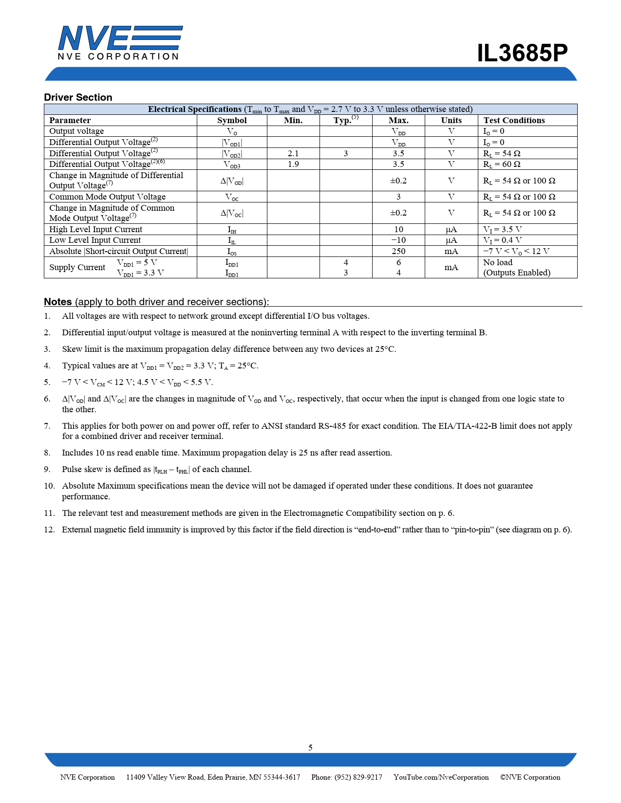

IL3685P. Driver Section. Electrical Specifications. Parameter. Symbol Min. Typ. Max. Units. Test. Conditions. Notes
IL3685P Driver Section Electrical Specifications
(Tmin to Tmax and V = 2.7 V to 3.3 V unless otherwise stated) DD
Parameter Symbol Min. Typ.
(5)
Max. Units Test Conditions
Output voltage V V V I = 0 O DD O Differential Output Voltage(2) |V V I = 0 OD1| VDD O Differential Output Voltage(2) |V = 54 Ω OD2| 2.1 3 3.5 V RL Differential Output Voltage(2)(6) V = 60 Ω OD3 1.9 3.5 V RL Change in Magnitude of Differential | ±0.2 V R = 54 Ω or 100 Ω Output Voltage(7) Δ|VOD L Common Mode Output Voltage V = 54 Ω or 100 Ω OC 3 V RL Change in Magnitude of Common | ±0.2 V R = 54 Ω or 100 Ω Mode Output Voltage(7) Δ|VOC L High Level Input Current IIH 10 μA VI = 3.5 V Low Level Input Current IIL −10 μA VI = 0.4 V Absolute |Short-circuit Output Current| I < 12 V OS 250 mA −7 V < VO V I 4 6 No load Supply Current DD1 = 5 V DD1 mA V I 3 4 (Outputs Enabled) DD1 = 3.3 V DD1
Notes
(apply to both driver and receiver sections): 1. All voltages are with respect to network ground except differential I/O bus voltages. 2. Differential input/output voltage is measured at the noninverting terminal A with respect to the inverting terminal B. 3. Skew limit is the maximum propagation delay difference between any two devices at 25°C. 4. Typical values are at V = 25°C. DD1 = VDD2 = 3.3 V; TA 5. −7 V < V < < 5.5 V. CM 12 V; 4.5 V < VDD 6. Δ|V | and Δ|V | are the changes in magnitude of V and V , respectively, that occur when the input is changed from one logic state to OD OC OD OC the other. 7. This applies for both power on and power off, refer to ANSI standard RS-485 for exact condition. The EIA/TIA-422-B limit does not apply for a combined driver and receiver terminal. 8. Includes 10 ns read enable time. Maximum propagation delay is 25 ns after read assertion. 9. Pulse skew is defined as |t – t | of each channel. PLH PHL 10. Absolute Maximum specifications mean the device will not be damaged if operated under these conditions. It does not guarantee performance. 11. The relevant test and measurement methods are given in the Electromagnetic Compatibility section on p. 6. 12. External magnetic field immunity is improved by this factor if the field direction is “end-to-end” rather than to “pin-to-pin” (see diagram on p. 6). 5 NVE Corporation 11409 Valley View Road, Eden Prairie, MN 55344-3617 Phone: (952) 829-9217 YouTube.com/NveCorporation ©NVE Corporation
