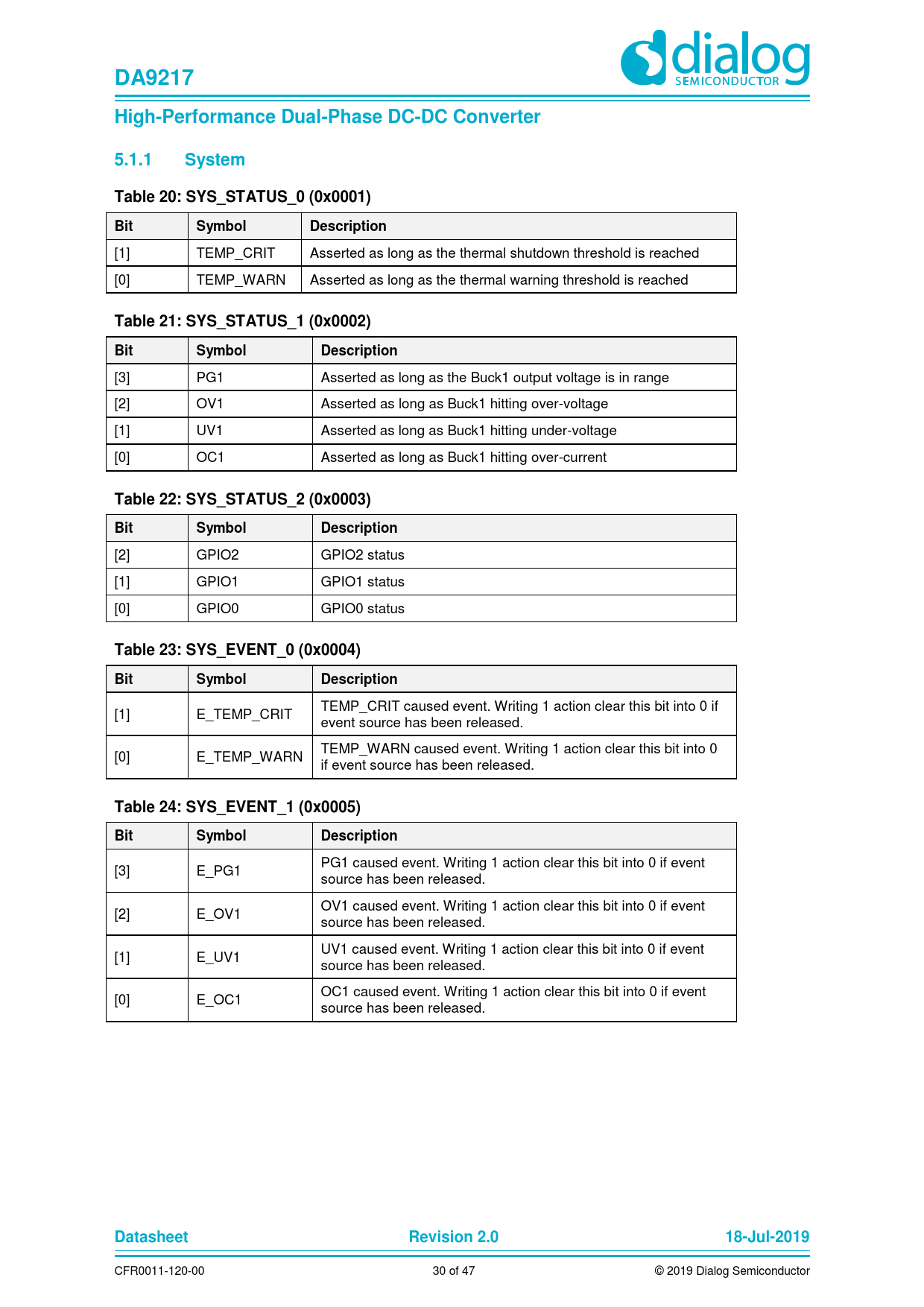

DA9217. High-Performance Dual-Phase DC-DC Converter. 5.1.1. System. Table 20: SYS_STATUS_0 (0x0001). Bit. Symbol. Description
DA9217 High-Performance Dual-Phase DC-DC Converter 5.1.1 System Table 20: SYS_STATUS_0 (0x0001) Bit Symbol Description
[1] TEMP_CRIT Asserted as long as the thermal shutdown threshold is reached [0] TEMP_WARN Asserted as long as the thermal warning threshold is reached
Table 21: SYS_STATUS_1 (0x0002) Bit Symbol Description
[3] PG1 Asserted as long as the Buck1 output voltage is in range [2] OV1 Asserted as long as Buck1 hitting over-voltage [1] UV1 Asserted as long as Buck1 hitting under-voltage [0] OC1 Asserted as long as Buck1 hitting over-current
Table 22: SYS_STATUS_2 (0x0003) Bit Symbol Description
[2] GPIO2 GPIO2 status [1] GPIO1 GPIO1 status [0] GPIO0 GPIO0 status
Table 23: SYS_EVENT_0 (0x0004) Bit Symbol Description
TEMP_CRIT caused event. Writing 1 action clear this bit into 0 if [1] E_TEMP_CRIT event source has been released. TEMP_WARN caused event. Writing 1 action clear this bit into 0 [0] E_TEMP_WARN if event source has been released.
Table 24: SYS_EVENT_1 (0x0005) Bit Symbol Description
PG1 caused event. Writing 1 action clear this bit into 0 if event [3] E_PG1 source has been released. OV1 caused event. Writing 1 action clear this bit into 0 if event [2] E_OV1 source has been released. UV1 caused event. Writing 1 action clear this bit into 0 if event [1] E_UV1 source has been released. OC1 caused event. Writing 1 action clear this bit into 0 if event [0] E_OC1 source has been released.
Datasheet Revision 2.0 18-Jul-2019
