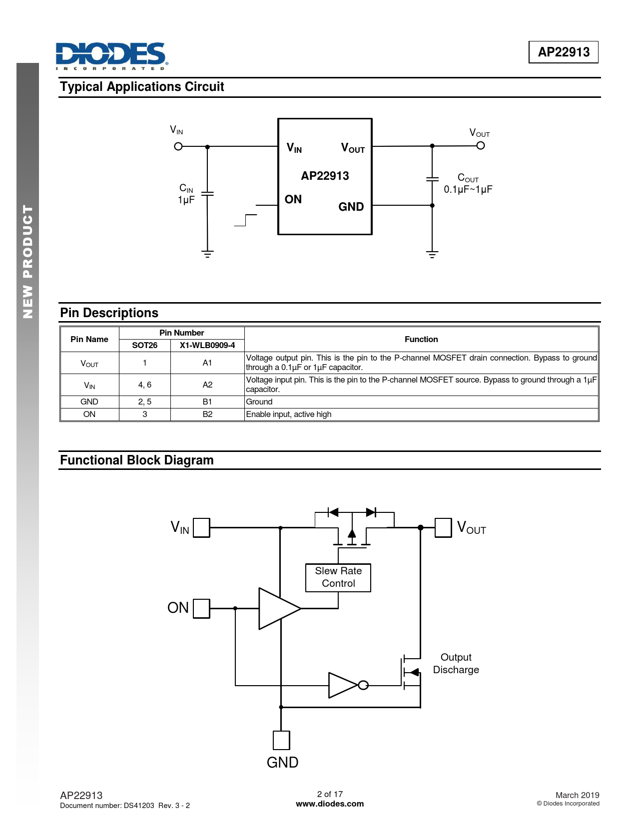

Pages / Page17 / 2 — AP22913. Typical Applications Circuit. VIN. VOUT. GND. C U D O R. W E. …
AP22913. Typical Applications Circuit. VIN. VOUT. GND. C U D O R. W E. Pin Descriptions. Pin Number. Pin Name. Function. SOT26. X1-WLB0909-4
AP22913 Typical Applications Circuit VIN VOUT GND C U D O R W E Pin Descriptions Pin Number Pin Name Function SOT26 X1-WLB0909-4
VIN VOUT
VIN VOUT AP22913
COUT C 0.1μF~1μF
IN 1μF
ON T GND C U D O R P W E N Pin Descriptions Pin Number Pin Name Function SOT26 X1-WLB0909-4
Voltage output pin. This is the pin to the P-channel MOSFET drain connection. Bypass to ground VOUT 1 A1 through a 0.1µF or 1µF capacitor. Voltage input pin. This is the pin to the P-channel MOSFET source. Bypass to ground through a 1µF VIN 4, 6 A2 capacitor. GND 2, 5 B1 Ground ON 3 B2 Enable input, active high
Functional Block Diagram
VIN VOUT Slew Rate Control ON Output Discharge GND
