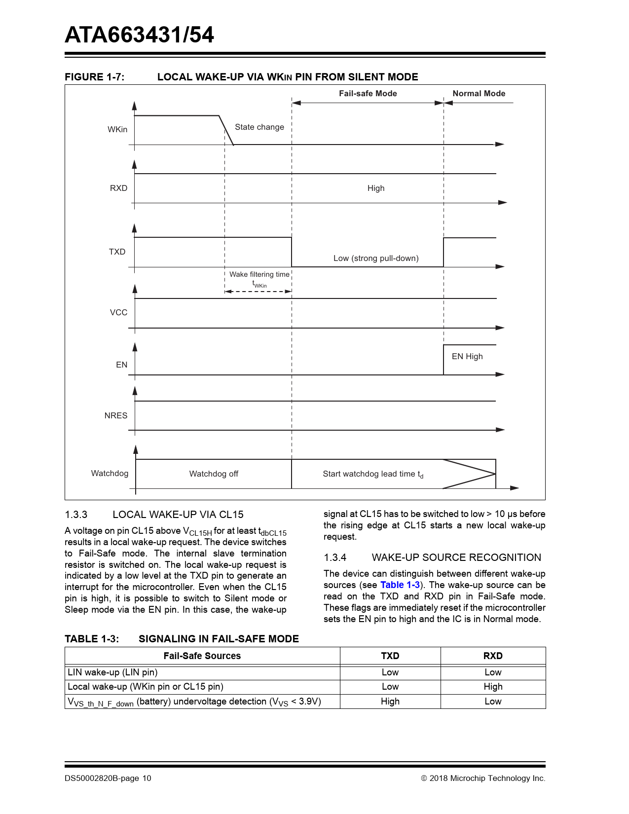

ATA663431/54. FIGURE 1-7:. LOCAL WAKE-UP VIA WKIN PIN FROM SILENT MODE. Fail-safe Mode. Normal Mode. Table 1-3. TABLE 1-3:
ATA663431/54 FIGURE 1-7: LOCAL WAKE-UP VIA WKIN PIN FROM SILENT MODE Fail-safe Mode Normal Mode Table 1-3 TABLE 1-3:
link to page 10
WKin State change RXD High TXD Low (strong pull-down) Wake filtering time tWKin VCC EN High EN NRES Watchdog Watchdog off Start watchdog lead time td 1.3.3 LOCAL WAKE-UP VIA CL15 signal at CL15 has to be switched to low > 10 μs before the rising edge at CL15 starts a new local wake-up A voltage on pin CL15 above VCL15H for at least tdbCL15 results in a local wake-up request. The device switches request. to Fail-Safe mode. The internal slave termination 1.3.4 WAKE-UP SOURCE RECOGNITION resistor is switched on. The local wake-up request is indicated by a low level at the TXD pin to generate an The device can distinguish between different wake-up interrupt for the microcontroller. Even when the CL15 sources (see
Table 1-3
). The wake-up source can be pin is high, it is possible to switch to Silent mode or read on the TXD and RXD pin in Fail-Safe mode. Sleep mode via the EN pin. In this case, the wake-up These flags are immediately reset if the microcontroller sets the EN pin to high and the IC is in Normal mode.
TABLE 1-3: SIGNALING IN FAIL-SAFE MODE Fail-Safe Sources TXD RXD
LIN wake-up (LIN pin) Low Low Local wake-up (WKin pin or CL15 pin) Low High VVS_th_N_F_down (battery) undervoltage detection (VVS < 3.9V) High Low DS50002820B-page 10
