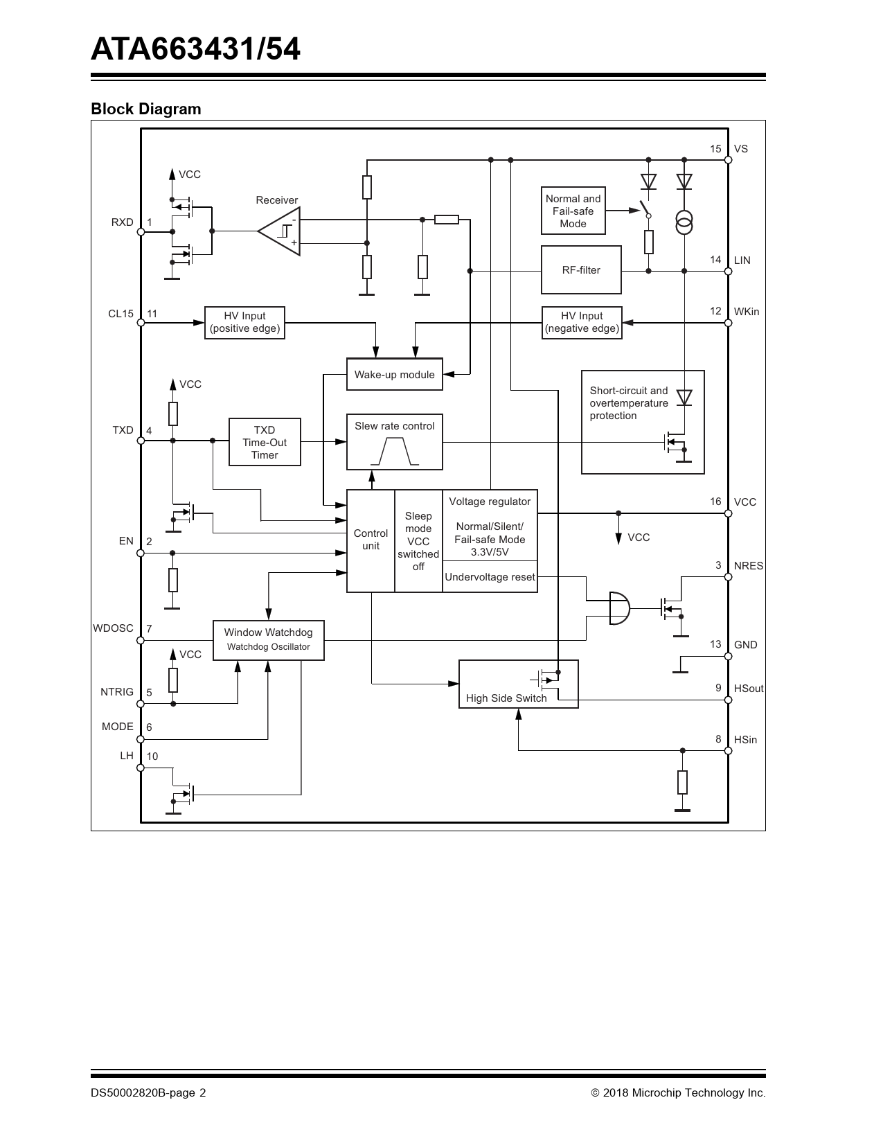

ATA663431/54. Block Diagram
ATA663431/54 Block Diagram
15 VS V&& Receiver Normal and Fail-safe RXD 1 - Mode + 14 LIN RF-filter 12 CL15 11 WKin HV Input HV Input (positive edge) (negative edge) Wake-up module V&& Short-circuit and overtemperature protection TXD 4 TXD Slew rate control Time-Out Timer Voltage regulator 16 VCC Sleep Normal/Silent/ Control mode EN 2 Fail-safe Mode V&& unit VCC 3.3V/5V switched off 3 NRES Undervoltage reset WDOSC 7 Window Watchdog 13 Watchdog Oscillator GND V&& NTRIG 5 9 HSout High Side Switch MODE 6 8 HSin LH 10 DS50002820B-page 2
