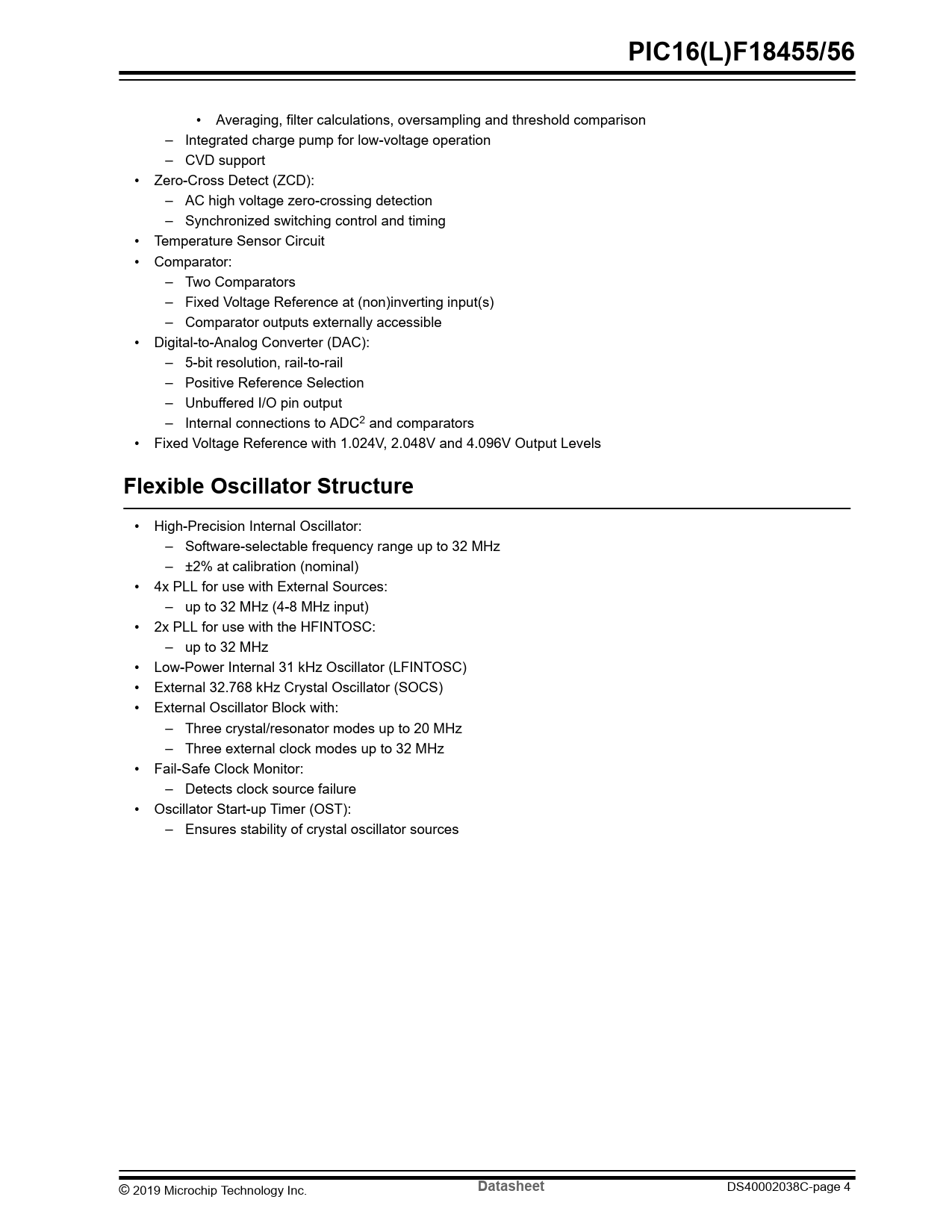

• Averaging, filter calculations, oversampling and threshold comparison – Integrated charge pump for low-voltage operation – CVD support • Zero-Cross Detect (ZCD): – AC high voltage zero-crossing detection – Synchronized switching control and timing • Temperature Sensor Circuit • Comparator: – Two Comparators – Fixed Voltage Reference at (non)inverting input(s) – Comparator outputs externally accessible • Digital-to-Analog Converter (DAC): – 5-bit resolution, rail-to-rail – Positive Reference Selection – Unbuffered I/O pin output – Internal connections to ADC2 and comparators • Fixed Voltage Reference with 1.024V, 2.048V and 4.096V Output Levels
Flexible Oscillator Structure
• High-Precision Internal Oscillator: – Software-selectable frequency range up to 32 MHz – ±2% at calibration (nominal) • 4x PLL for use with External Sources: – up to 32 MHz (4-8 MHz input) • 2x PLL for use with the HFINTOSC: – up to 32 MHz • Low-Power Internal 31 kHz Oscillator (LFINTOSC) • External 32.768 kHz Crystal Oscillator (SOCS) • External Oscillator Block with: – Three crystal/resonator modes up to 20 MHz – Three external clock modes up to 32 MHz • Fail-Safe Clock Monitor: – Detects clock source failure • Oscillator Start-up Timer (OST): – Ensures stability of crystal oscillator sources © 2019 Microchip Technology Inc.
