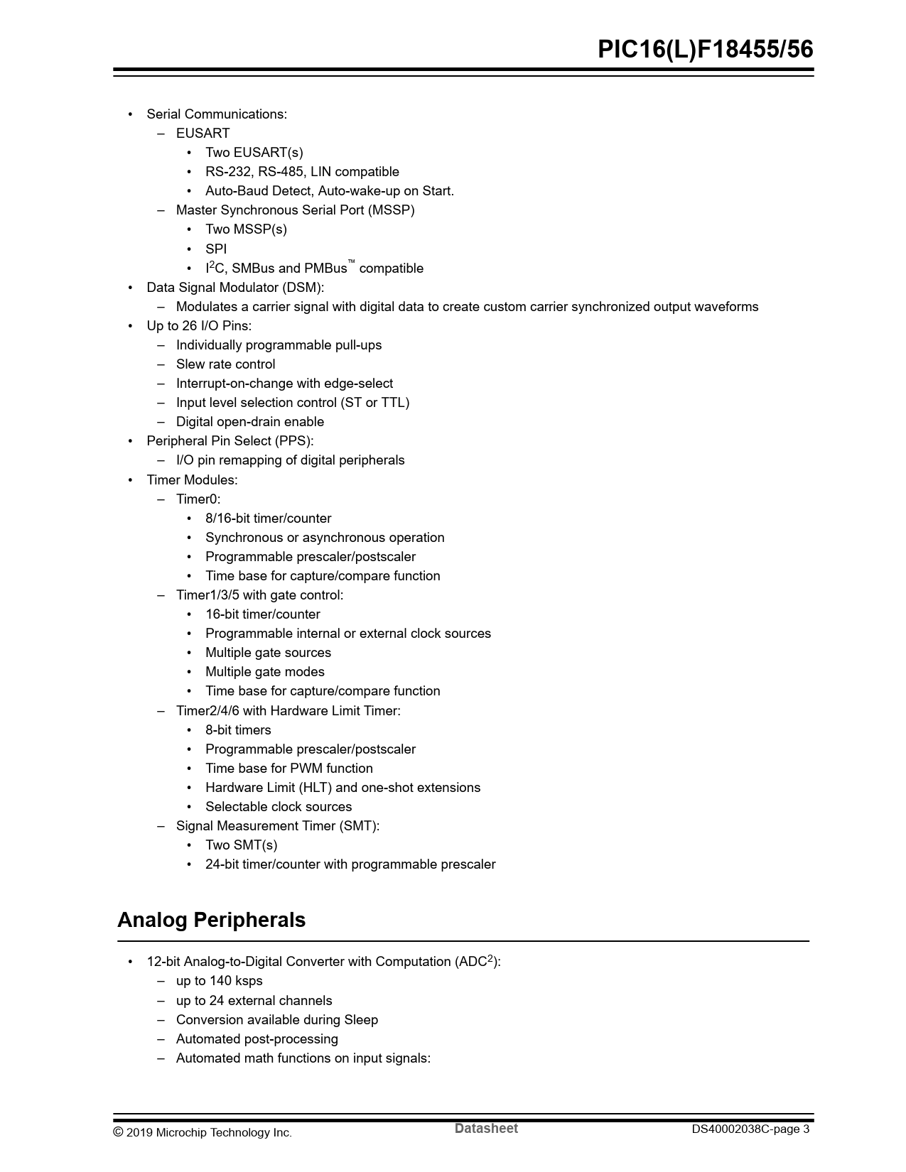

PIC16(L)F18455/56
• Serial Communications: – EUSART • Two EUSART(s) • RS-232, RS-485, LIN compatible • Auto-Baud Detect, Auto-wake-up on Start. – Master Synchronous Serial Port (MSSP) • Two MSSP(s) • SPI • I2C, SMBus and PMBus™ compatible • Data Signal Modulator (DSM): – Modulates a carrier signal with digital data to create custom carrier synchronized output waveforms • Up to 26 I/O Pins: – Individually programmable pull-ups – Slew rate control – Interrupt-on-change with edge-select – Input level selection control (ST or TTL) – Digital open-drain enable • Peripheral Pin Select (PPS): – I/O pin remapping of digital peripherals • Timer Modules: – Timer0: • 8/16-bit timer/counter • Synchronous or asynchronous operation • Programmable prescaler/postscaler • Time base for capture/compare function – Timer1/3/5 with gate control: • 16-bit timer/counter • Programmable internal or external clock sources • Multiple gate sources • Multiple gate modes • Time base for capture/compare function – Timer2/4/6 with Hardware Limit Timer: • 8-bit timers • Programmable prescaler/postscaler • Time base for PWM function • Hardware Limit (HLT) and one-shot extensions • Selectable clock sources – Signal Measurement Timer (SMT): • Two SMT(s) • 24-bit timer/counter with programmable prescaler
Analog Peripherals
• 12-bit Analog-to-Digital Converter with Computation (ADC2): – up to 140 ksps – up to 24 external channels – Conversion available during Sleep – Automated post-processing – Automated math functions on input signals: © 2019 Microchip Technology Inc.
