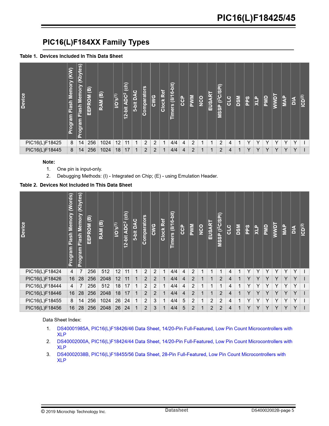

Pages / Page708 / 5 — PIC16(L)F18425/45. PIC16(L)F184XX Family Types. Table 1. Devices Included …
File Format / SizePDF / 10.6 Mb
PIC16(L)F18425/45. PIC16(L)F184XX Family Types. Table 1. Devices Included In This Data Sheet. (ch)2. (1) s. C/SPI)2. (2). CLC. Device
PIC16(L)F18425/45 PIC16(L)F184XX Family Types Table 1. Devices Included In This Data Sheet (ch)2 (1) s C/SPI)2 (2) CLC Device
PIC16(L)F18425/45 PIC16(L)F184XX Family Types Table 1. Devices Included In This Data Sheet (ch)2 (1) s C/SPI)2 (2) CLC Device CWG CCP PWM NCO DSM PPS XLP PMD RAM (B) I/O’ WWDT MAP DIA ICD 5-bit DAC Clock Ref EUSART EEPROM (B) Comparators imers (8/16-bit) 12-bit ADC T MSSP (I Program Flash Memory (KW) Program Flash Memory (Kbytes)
PIC16(L)F18425 8 14 256 1024 12 11 1 2 2 1 4/4 4 2 1 1 2 4 1 Y Y Y Y Y Y I PIC16(L)F18445 8 14 256 1024 18 17 1 2 2 1 4/4 4 2 1 1 2 4 1 Y Y Y Y Y Y I
Note: 
1. One pin is input-only. 2. Debugging Methods: (I) - Integrated on Chip; (E) - using Emulation Header.
Table 2. Devices Not Included In This Data Sheet ords) (ch)2 (1) s C/SPI)2 (2) CLC Device CWG CCP PWM NCO DSM PPS XLP PMD RAM (B) I/O’ WWDT MAP DIA ICD 5-bit DAC Clock Ref EUSART EEPROM (B) Comparators imers (8/16-bit) 12-bit ADC T MSSP (I Program Flash Memory (W Program Flash Memory (Kbytes)
PIC16(L)F18424 4 7 256 512 12 11 1 2 2 1 4/4 4 2 1 1 1 4 1 Y Y Y Y Y Y I PIC16(L)F18426 16 28 256 2048 12 11 1 2 2 1 4/4 4 2 1 1 2 4 1 Y Y Y Y Y Y I PIC16(L)F18444 4 7 256 512 18 17 1 2 2 1 4/4 4 2 1 1 1 4 1 Y Y Y Y Y Y I PIC16(L)F18446 16 28 256 2048 18 17 1 2 2 1 4/4 4 2 1 1 2 4 1 Y Y Y Y Y Y I PIC16(L)F18455 8 14 256 1024 26 24 1 2 3 1 4/4 5 2 1 2 2 4 1 Y Y Y Y Y Y I PIC16(L)F18456 16 28 256 2048 26 24 1 2 3 1 4/4 5 2 1 2 2 4 1 Y Y Y Y Y Y I Data Sheet Index: 1. DS40001985A, PIC16(L)F18426/46 Data Sheet, 14/20-Pin Full-Featured, Low Pin Count Microcontrollers with XLP 2. DS40002000A, PIC16(L)F18424/44 Data Sheet, 14/20-Pin Full-Featured, Low Pin Count Microcontrollers with XLP 3. DS40002038B, PIC16(L)F18455/56 Data Sheet, 28-Pin Full-Featured, Low Pin Count Microcontrollers with XLP © 2019 Microchip Technology Inc.
