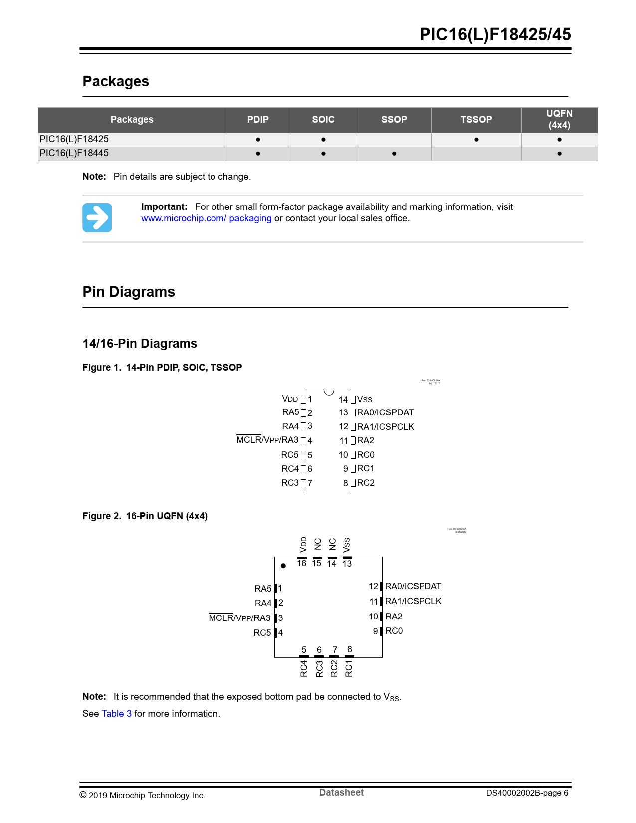

PIC16(L)F18425/45. Packages. UQFN. PDIP. SOIC. SSOP. TSSOP. (4x4). Note: . Important: . Pin Diagrams. 14/16-Pin Diagrams
link to page 8
PIC16(L)F18425/45 Packages UQFN Packages PDIP SOIC SSOP TSSOP (4x4)
PIC16(L)F18425 ● ● ● ● PIC16(L)F18445 ● ● ● ●
Note:
Pin details are subject to change.
Important:
For other small form-factor package availability and marking information, visit www.microchip.com/ packaging or contact your local sales office.
Pin Diagrams 14/16-Pin Diagrams Figure 1. 14-Pin PDIP, SOIC, TSSOP
Rev. 00-000014A 6/21/2017 VDD 1 14 VSS RA5 2 13 RA0/ICSPDAT RA4 3 12 RA1/ICSPCLK MCLR/VPP/RA3 4 11 RA2 RC5 5 10 RC0 RC4 6 9 RC1 RC3 7 8 RC2
Figure 2. 16-Pin UQFN (4x4)
Rev. 00-000016A 6/21/2017 D S D NC V NC S V 16 15 14 13 RA5 1 12 RA0/ICSPDAT RA4 2 11 RA1/ICSPCLK MCLR/VPP/RA3 3 10 RA2 RC5 4 9 RC0 5 6 7 8 3 2 C4 C1 R RC RC R
Note:
It is recommended that the exposed bottom pad be connected to VSS. See Table 3 for more information. © 2019 Microchip Technology Inc.
