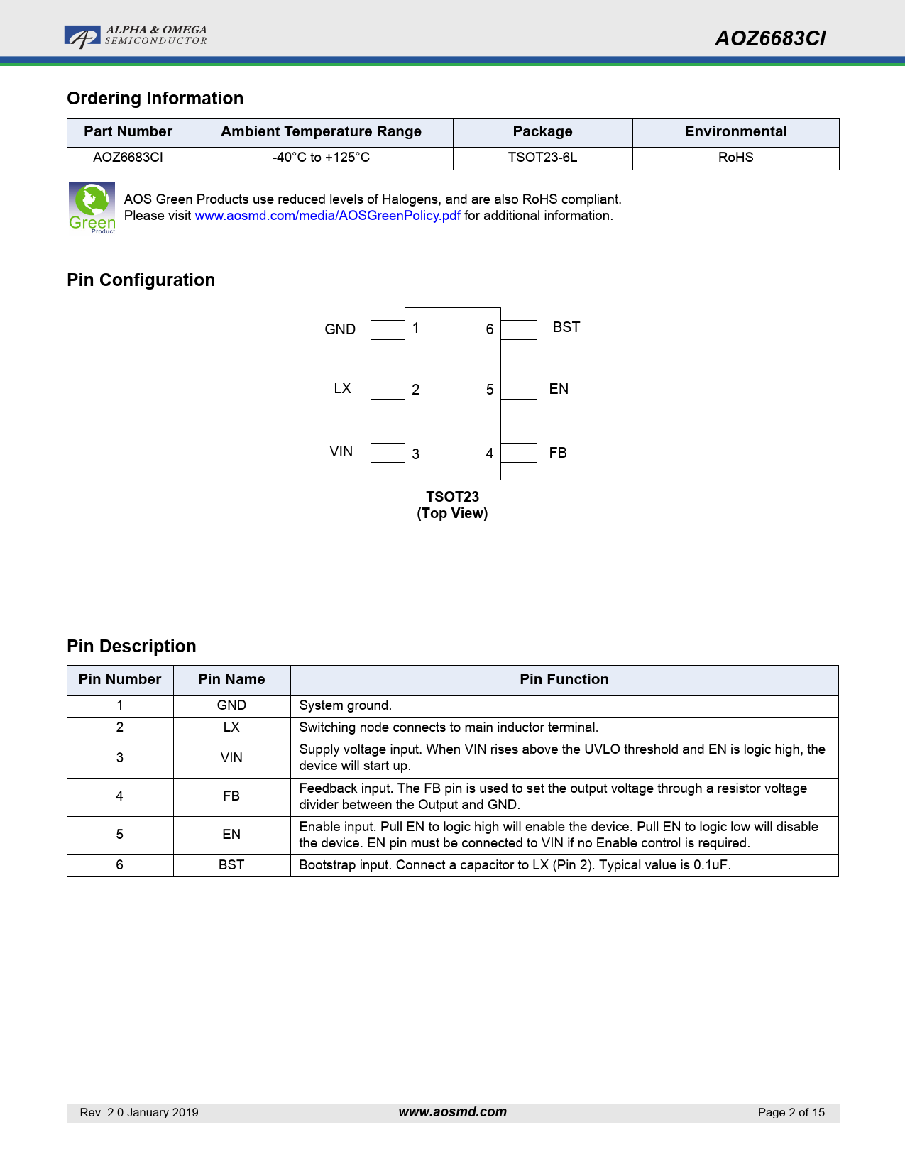

AOZ6683CI. Ordering Information. Part Number. Ambient Temperature Range. Package. Environmental. Pin Configuration. TSOT23. (Top View)
AOZ6683CI Ordering Information Part Number Ambient Temperature Range Package Environmental Pin Configuration TSOT23 (Top View)
AOZ6683CI -40°C to +125°C TSOT23-6L RoHS AOS Green Products use reduced levels of Halogens, and are also RoHS compliant. Please visit www.aosmd.com/media/AOSGreenPolicy.pdf for additional information.
Pin Configuration
GND 1 6 BST LX 2 5 EN VIN 3 4 FB
TSOT23 (Top View) Pin Description Pin Number Pin Name Pin Function
1 GND System ground. 2 LX Switching node connects to main inductor terminal. Supply voltage input. When VIN rises above the UVLO threshold and EN is logic high, the 3 VIN device will start up. Feedback input. The FB pin is used to set the output voltage through a resistor voltage 4 FB divider between the Output and GND. Enable input. Pull EN to logic high will enable the device. Pull EN to logic low will disable 5 EN the device. EN pin must be connected to VIN if no Enable control is required. 6 BST Bootstrap input. Connect a capacitor to LX (Pin 2). Typical value is 0.1uF. Rev. 2.0 January 2019
