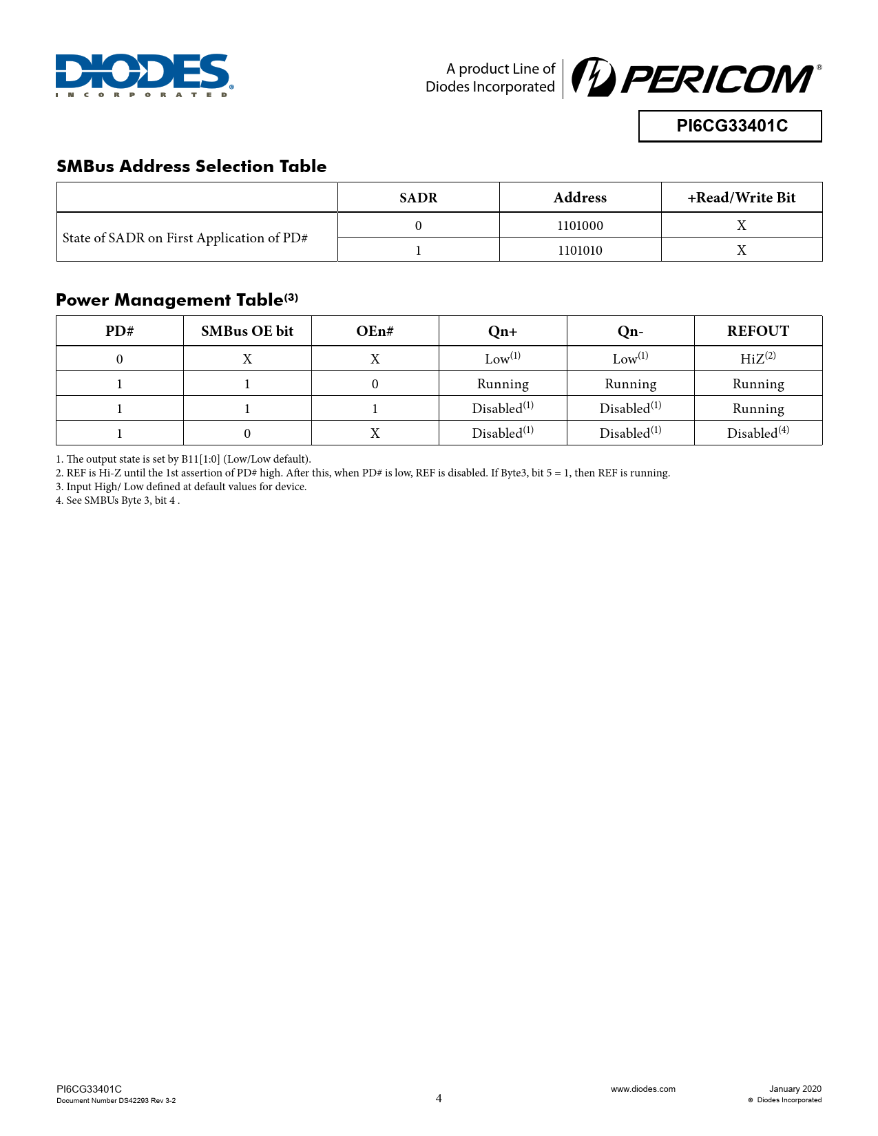

Pages / Page24 / 4 — PI6CG33401C. SMBus Address Selection Table. SADR. Address. +Read/Write …
PI6CG33401C. SMBus Address Selection Table. SADR. Address. +Read/Write Bit. Power Management Table(3). PD#. SMBus OE bit. OEn#. Qn+. Qn-
PI6CG33401C SMBus Address Selection Table SADR Address +Read/Write Bit Power Management Table(3) PD# SMBus OE bit OEn# Qn+ Qn-
A product Line of Diodes Incorporated
0 1101000 X State of SADR on First Application of PD# 1 1101010 X
Power Management Table(3) PD# SMBus OE bit OEn# Qn+ Qn- REFOUT
