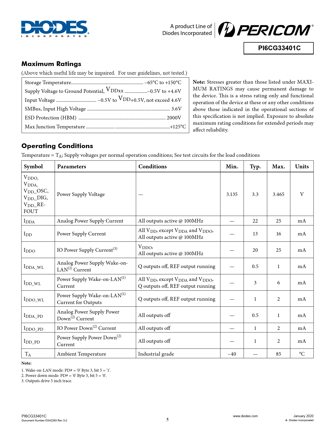

PI6CG33401C Maximum Ratings
(Above which useful life may be impaired. For user guidelines, not tested.) Storage Temperature .. –65°C to +150°C
Note:
Stresses greater than those listed under MAXI- Supply Voltage to Ground Potential, VDDxx ..–0.5V to +4.6V MUM RATINGS may cause permanent damage to the device. This is a stress rating only and functional Input Voltage ... –0.5V to VDD+0.5V, not exceed 4.6V operation of the device at these or any other conditions SMBus, Input High Voltage .. 3.6V above those indicated in the operational sections of ESD Protection (HBM) .. 2000V this specification is not implied. Exposure to absolute Max Junction Temperature ..+125°C maximum rating conditions for extended periods may affect reliability.
Operating Conditions
Temperature = TA; Supply voltages per normal operation conditions; See test circuits for the load conditions
Symbol Parameters Conditions Min. Typ. Max. Units
VDDO, VDDA, VDD_OSC, V Power Supply Voltage — 3.135 3.3 3.465 V DD_DIG, VDD_RE- FOUT IDDA Analog Power Supply Current All outputs active @ 100MHz — 22 25 mA IDD Power Supply Current All VDD, except VDDA and VDDO, All outputs active @ 100MHz — 13 16 mA IDDO IO Power Supply Current(3) VDDO, All outputs active @ 100MHz — 20 25 mA I Analog Power Supply Wake-on- DDA_WL LAN(1) Current Q outputs off, REF output running — 0.5 1 mA I Power Supply Wake-on-LAN(1) All VDD, except VDDA and VDDO, DD_WL Current Q outputs off, REF output running — 3 6 mA I Power Supply Wake-on-LAN(1) DDO_WL Current for Outputs Q outputs off, REF output running — 1 2 mA I Analog Power Supply Power DDA_PD Down(2) Current All outputs off — 0.5 1 mA IDDO_PD IO Power Down(2) Current All outputs off — 1 2 mA I Power Supply Power Down(2) DD_PD Current All outputs off — 1 2 mA TA Ambient Temperature Industrial grade –40 — 85 °C
Note:
1. Wake-on-LAN mode: PD# = '0' Byte 3, bit 5 = '1'. 2. Power down mode: PD# = '0' Byte 3, bit 5 = '0'. 3. Outputs drive 5 inch trace. PI6CG33401C www.diodes.com January 2020 Document Number DS42293 Rev 3-2 5 Diodes Incorporated
