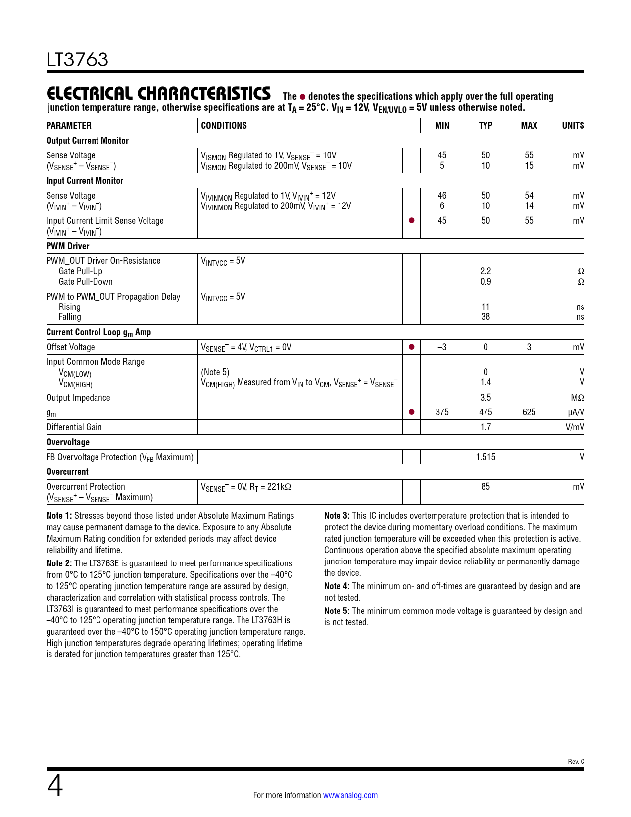

denotes the specifications which apply over the full operating junction temperature range, otherwise specifications are at TA = 25°C. VIN = 12V, VEN/UVLO = 5V unless otherwise noted. PARAMETER CONDITIONS MIN TYP MAX UNITS Output Current Monitor
Sense Voltage V – ISMON Regulated to 1V, VSENSE = 10V 45 50 55 mV (V + – – SENSE – VSENSE ) VISMON Regulated to 200mV, VSENSE = 10V 5 10 15 mV
Input Current Monitor
Sense Voltage V + IVINMON Regulated to 1V, VIVIN = 12V 46 50 54 mV (V + – + IVIN – VIVIN ) VIVINMON Regulated to 200mV, VIVIN = 12V 6 10 14 mV Input Current Limit Sense Voltage l 45 50 55 mV (V + – IVIN – VIVIN )
PWM Driver
PWM_OUT Driver On-Resistance VINTVCC = 5V Gate Pull-Up 2.2 Ω Gate Pull-Down 0.9 Ω PWM to PWM_OUT Propagation Delay VINTVCC = 5V Rising 11 ns Falling 38 ns
Current Control Loop gm Amp
Offset Voltage V – SENSE = 4V, VCTRL1 = 0V l –3 0 3 mV Input Common Mode Range VCM(LOW) (Note 5) 0 V V + – CM(HIGH) VCM(HIGH) Measured from VIN to VCM, VSENSE = VSENSE 1.4 V Output Impedance 3.5 MΩ gm l 375 475 625 µA/V Differential Gain 1.7 V/mV
Overvoltage
FB Overvoltage Protection (VFB Maximum) 1.515 V
Overcurrent
Overcurrent Protection V – SENSE = 0V, RT = 221kΩ 85 mV (V + – SENSE – VSENSE Maximum)
