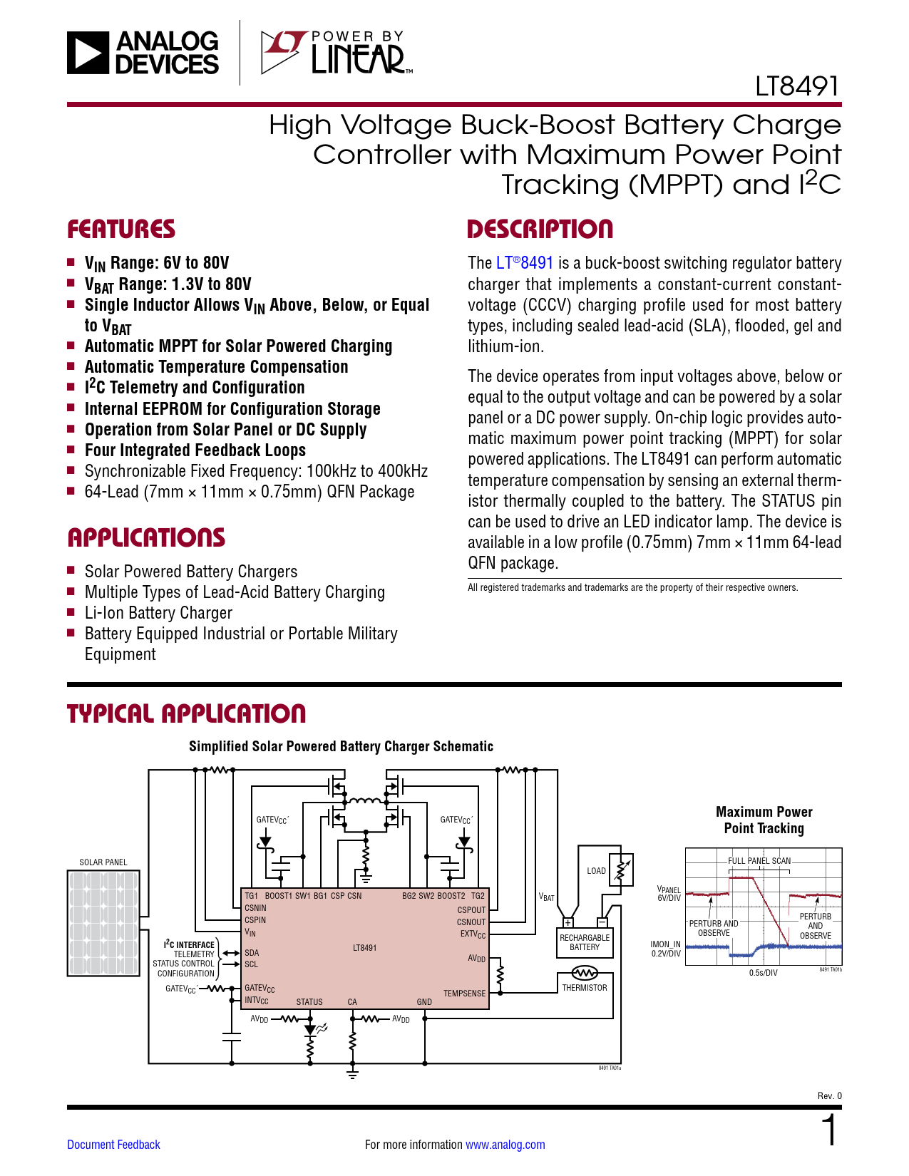

DescriptionHigh Voltage Buck-Boost Battery Charge Controller with Maximum Power Point Tracking (MPPT) and I2C

FEATURES. DESCRIPTION. VIN Range: 6V to 80V. VBAT Range: 1.3V to 80V. Single Inductor Allows VIN Above, Below, or Equal. to VBAT

LT8491 High Voltage Buck-Boost Battery Charge Controller with Maximum Power Point Tracking (MPPT) and I2C
FEATURES DESCRIPTION
n
The LT®8491 is a buck-boost switching regulator battery n
charger that implements a constant-current constant- n
voltage (CCCV) charging profile used for most battery
to VBAT
types, including sealed lead-acid (SLA), flooded, gel and n
Automatic MPPT for Solar Powered Charging
lithium-ion. n
Automatic Temperature Compensation
The device operates from input voltages above, below or n
I2C Telemetry and Configuration
equal to the output voltage and can be powered by a solar n
Internal EEPROM for Configuration Storage
panel or a DC power supply. On-chip logic provides auto- n
Operation from Solar Panel or DC Supply
matic maximum power point tracking (MPPT) for solar n
Four Integrated Feedback Loops
powered applications. The LT8491 can perform automatic n Synchronizable Fixed Frequency: 100kHz to 400kHz temperature compensation by sensing an external therm- n 64-Lead (7mm × 11mm × 0.75mm) QFN Package istor thermally coupled to the battery. The STATUS pin can be used to drive an LED indicator lamp. The device is
APPLICATIONS
available in a low profile (0.75mm) 7mm × 11mm 64-lead n QFN package. Solar Powered Battery Chargers n Multiple Types of Lead-Acid Battery Charging All registered trademarks and trademarks are the property of their respective owners. n Li-Ion Battery Charger n Battery Equipped Industrial or Portable Military Equipment
TYPICAL APPLICATION Simplified Solar Powered Battery Charger Schematic Maximum Power
GATEVCC´ GATEVCC´
Point Tracking
SOLAR PANEL FULL PANEL SCAN LOAD V TG1 BOOST1 SW1 BG1 CSP CSN BG2 SW2 BOOST2 TG2 PANEL VBAT 6V/DIV CSNIN CSPOUT CSPIN PERTURB CSNOUT + – PERTURB AND AND VIN EXTVCC RECHARGABLE OBSERVE OBSERVE
I2C INTERFACE
