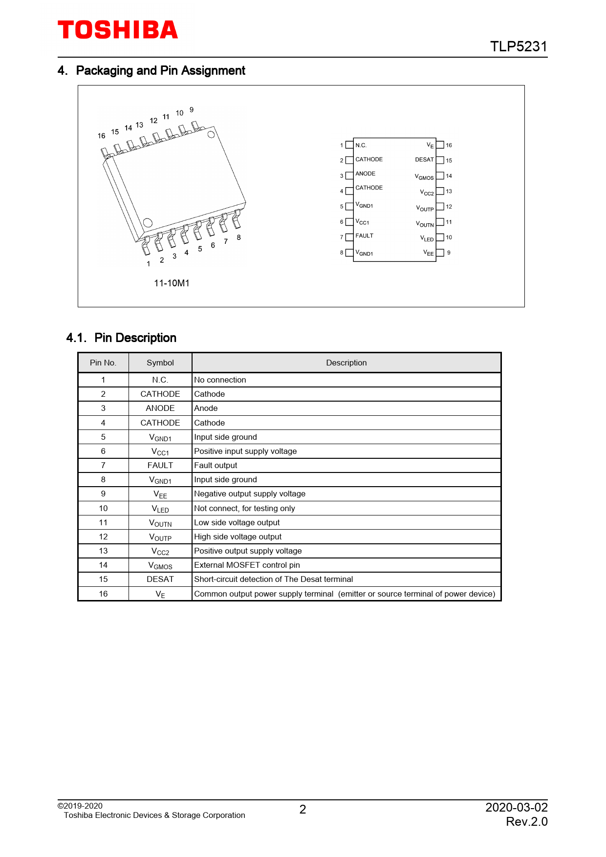

Pages / Page30 / 2 — TLP5231. 4. Packaging. and. Pin. Assignment. 11-10M1. 4.1. Pin. …
TLP5231. 4. Packaging. and. Pin. Assignment. 11-10M1. 4.1. Pin. Description. Pin. No. Symbol. Description. 1. N.C. No. connection. 2. CATHODE. Cathode. 3. ANODE
TLP5231 4 Packaging and Pin Assignment 11-10M1 4.1 Pin Description Pin No Symbol Description 1 N.C No connection 2 CATHODE Cathode 3 ANODE
TLP5231 4. Packaging and Pin Assignment 11-10M1 4.1. Pin Description Pin No. Symbol Description 1 N.C. No connection 2 CATHODE Cathode 3 ANODE Anode 4 CATHODE Cathode 5 VGND1 Input side ground 6 VCC1 Positive input supply voltage 7 FAULT Fault output 8 VGND1 Input side ground 9 VEE Negative output supply voltage 10 VLED Not connect, for testing only 11 VOUTN Low side voltage output 12 VOUTP High side voltage output 13 VCC2 Positive output supply voltage 14 VGMOS External MOSFET control pin 15 DESAT Short-circuit detection of The Desat terminal 16 VE Common output power supply terminal (emitter or source terminal of power device) ©2019-2020 2 2020-03-02 Toshiba Electronic Devices & Storage Corporation Rev.2.0
