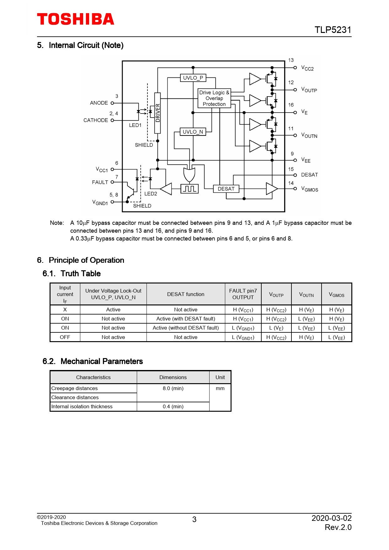

Pages / Page30 / 3 — TLP5231. 5. Internal. Circuit. (Note). Note:. A. 10µF. bypass. capacitor. …
TLP5231. 5. Internal. Circuit. (Note). Note:. A. 10µF. bypass. capacitor. must. be. connected. between. pins. 9. and. 13,. and. A. 1µF. bypass. capacitor. must. be
TLP5231 5 Internal Circuit (Note) Note: A 10µF bypass capacitor must be connected between pins 9 and 13, and A 1µF bypass capacitor must be
TLP5231 5. Internal Circuit (Note) Note: A 10µF bypass capacitor must be connected between pins 9 and 13, and A 1µF bypass capacitor must be connected between pins 13 and 16, and pins 9 and 16. A 0.33µF bypass capacitor must be connected between pins 6 and 5, or pins 6 and 8. 6. Principle of Operation 6.1. Truth Table Input Under Voltage Lock-Out FAULT pin7 current DESAT function VOUTP VOUTN VGMOS UVLO_P, UVLO_N OUTPUT IF X Active Not active H (VCC1) H (VCC2) H (VE) H (VE) ON Not active Active (with DESAT fault) H (VCC1) H (VCC2) L (VEE) H (VE) ON Not active Active (without DESAT fault) L (VGND1) L (VE) L (VEE) L (VEE) OFF Not active Not active L (VGND1) H (VCC2) H (VE) L (VEE) 6.2. Mechanical Parameters Characteristics Dimensions Unit Creepage distances 8.0 (min) mm Clearance distances Internal isolation thickness 0.4 (min) ©2019-2020 3 2020-03-02 Toshiba Electronic Devices & Storage Corporation Rev.2.0
