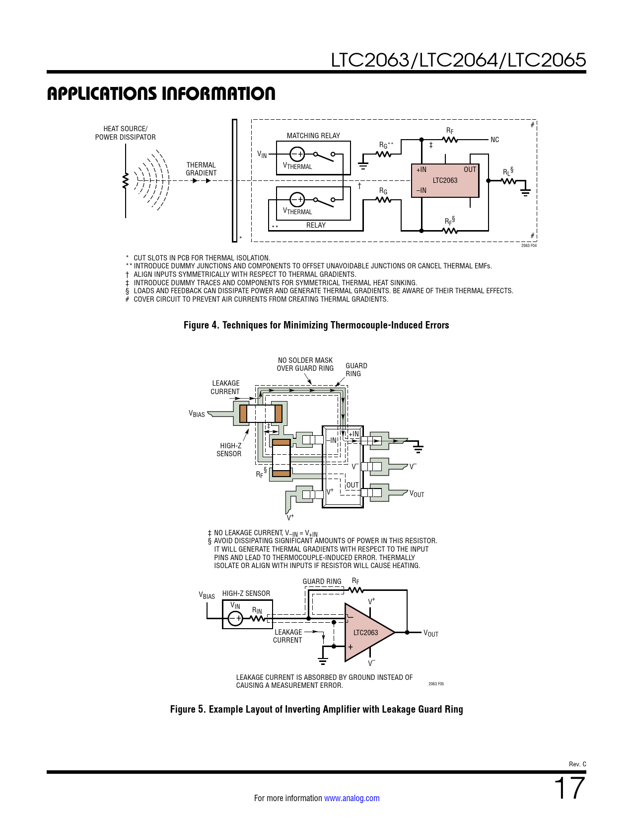

APPLICATIONS INFORMATION. Figure 4. Techniques for Minimizing Thermocouple-Induced Errors
APPLICATIONS INFORMATION Figure 4 Techniques for Minimizing Thermocouple-Induced Errors
LTC2063/LTC2064/LTC2065
HEAT SOURCE/ # RF POWER DISSIPATOR MATCHING RELAY NC RG** ‡ – + VIN THERMAL VTHERMAL GRADIENT +IN OUT R § L LTC2063 † – + RG –IN VTHERMAL R § F RELAY ** * # 2063 F04 * CUT SLOTS IN PCB FOR THERMAL ISOLATION. ** INTRODUCE DUMMY JUNCTIONS AND COMPONENTS TO OFFSET UNAVOIDABLE JUNCTIONS OR CANCEL THERMAL EMFs. † ALIGN INPUTS SYMMETRICALLY WITH RESPECT TO THERMAL GRADIENTS. ‡ INTRODUCE DUMMY TRACES AND COMPONENTS FOR SYMMETRICAL THERMAL HEAT SINKING. § LOADS AND FEEDBACK CAN DISSIPATE POWER AND GENERATE THERMAL GRADIENTS. BE AWARE OF THEIR THERMAL EFFECTS. # COVER CIRCUIT TO PREVENT AIR CURRENTS FROM CREATING THERMAL GRADIENTS.
NO SOLDER MASK GUARD OVER GUARD RING RING LEAKAGE CURRENT VBIAS ‡ +IN –IN HIGH-Z SENSOR V– V– R § F OUT V+ VOUT V+ ‡ NO LEAKAGE CURRENT, V–IN = V+IN § AVOID DISSIPATING SIGNIFICANT AMOUNTS OF POWER IN THIS RESISTOR. IT WILL GENERATE THERMAL GRADIENTS WITH RESPECT TO THE INPUT PINS AND LEAD TO THERMOCOUPLE-INDUCED ERROR. THERMALLY ISOLATE OR ALIGN WITH INPUTS IF RESISTOR WILL CAUSE HEATING. GUARD RING RF V HIGH-Z SENSOR BIAS V+ VIN R – + IN – LEAKAGE LTC2063 VOUT CURRENT + V– LEAKAGE CURRENT IS ABSORBED BY GROUND INSTEAD OF 2063 F05 CAUSING A MEASUREMENT ERROR.
Figure 5. Example Layout of Inverting Amplifier with Leakage Guard Ring
