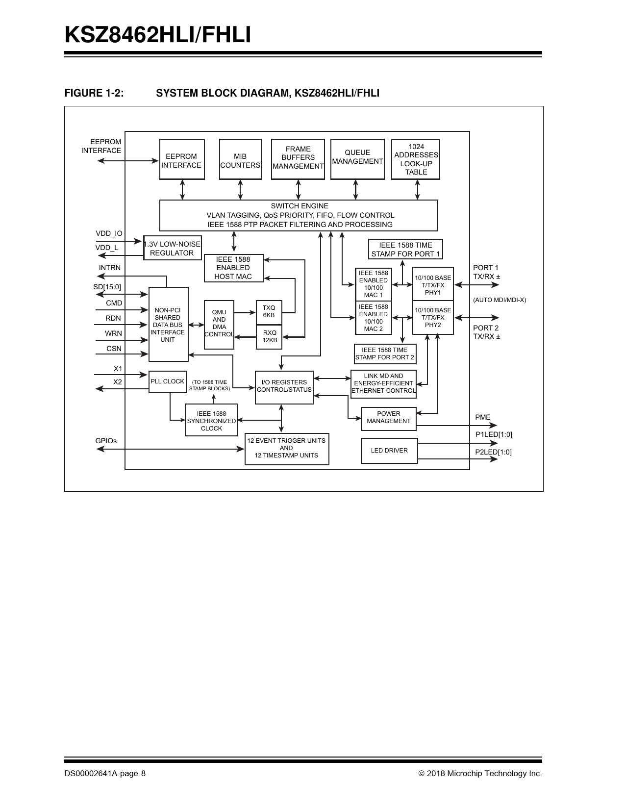

DescriptionIEEE 1588 Precision Time Protocol-Enabled, Two-Port, 10/100 Mbps Ethernet Switch with 8-or 16-Bit Host Interface
Pages / Page233 / 8 — KSZ8462HLI/FHLI. FIGURE 1-2:. SYSTEM BLOCK DIAGRAM, KSZ8462HLI/FHLI
KSZ8462HLI/FHLI FIGURE 1-2: SYSTEM BLOCK DIAGRAM, KSZ8462HLI/FHLI
EEPROM 1024 INTERFACE FRAME QUEUE EEPROM MIB BUFFERS ADDRESSES MANAGEMENT INTERFACE COUNTERS MANAGEMENT LOOK-UP TABLE SWITCH ENGINE VLAN TAGGING, QoS PRIORITY, FIFO, FLOW CONTROL IEEE 1588 PTP PACKET FILTERING AND PROCESSING VDD_IO 1.3V LOW-NOISE VDD_L IEEE 1588 TIME REGULATOR STAMP FOR PORT 1 IEEE 1588 INTRN ENABLED PORT 1 IEEE 1588 HOST MAC 10/100 BASE TX/RX ± ENABLED SD[15:0] 10/100 T/TX/FX MAC 1 PHY1 (AUTO MDI/MDI-X) CMD TXQ IEEE 1588 NON-PCI QMU 10/100 BASE 6KB ENABLED RDN SHARED AND T/TX/FX 10/100 DATA BUS DMA PHY2 MAC 2 PORT 2 WRN INTERFACE RXQ CONTROL TX/RX ± UNIT 12KB CSN IEEE 1588 TIME STAMP FOR PORT 2 X1 LINK MD AND X2 PLL CLOCK (TO 1588 TIME I/O REGISTERS ENERGY-EFFICIENT STAMP BLOCKS) CONTROL/STATUS ETHERNET CONTROL IEEE 1588 POWER PME SYNCHRONIZED MANAGEMENT CLOCK P1LED[1:0] GPIOs 12 EVENT TRIGGER UNITS AND LED DRIVER P2LED[1:0] 12 TIMESTAMP UNITS DS00002641A-page 8
