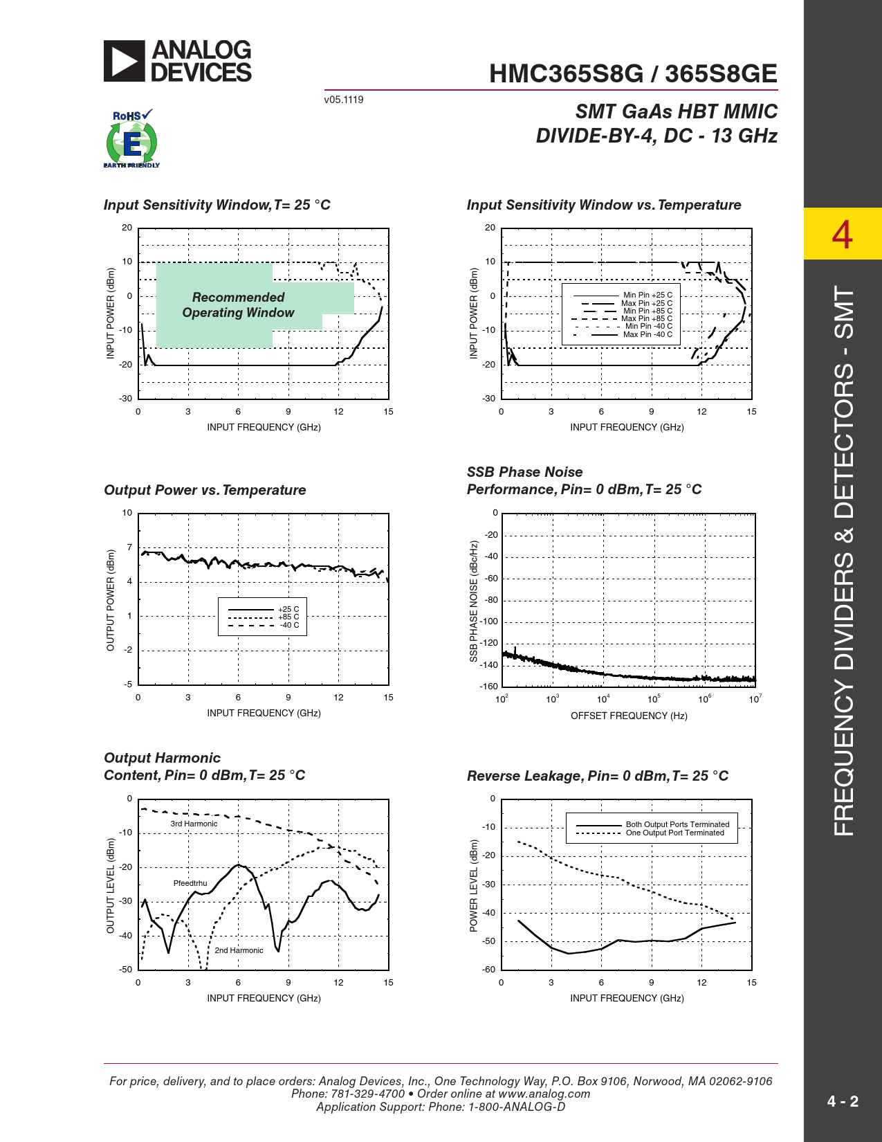

HMC365S8G / 365S8GE. SMT GaAs HBT MMIC. DIVIDE-BY-4, DC - 13 GHz. Input Sensitivity Window, T= 25 °C
HMC365S8G / 365S8GE SMT GaAs HBT MMIC DIVIDE-BY-4, DC - 13 GHz Input Sensitivity Window, T= 25 °C
HMC365S8G / 365S8GE
v05.1119
SMT GaAs HBT MMIC DIVIDE-BY-4, DC - 13 GHz Input Sensitivity Window, T= 25 °C Input Sensitivity Window vs. Temperature
4 20 20 4 10 10 ) m m T (dB 0 (dB R
Recommended
0 Min Pin +25 C R Max Pin +25 C T M E E W
Operating Window
Min Pin +85 C W O Max Pin +85 C O M P -10 P -10 Min Pin -40 C Max Pin -40 C UT UT P P S - S IN IN -20 -20 S - S R -30 -30 R O 0 3 6 9 12 15 0 3 6 9 12 15 O T INPUT FREQUENCY (GHz) INPUT FREQUENCY (GHz) T C C E E T
SSB Phase Noise
T E
Output Power vs. Temperature Performance, Pin= 0 dBm, T= 25 °C
E 10 0 -20 S & D 7 -40 (dBm) S & D R -60 4 R E -80 E ID POWER +25 C 1 +85 C -100 -40 C ID IV -120 OUTPUT -2 IV SSB PHASE NOISE (dBc/Hz) -140 Y D -5 -160 0 3 6 9 12 15 Y D C 102 103 104 105 106 107 INPUT FREQUENCY (GHz) OFFSET FREQUENCY (Hz) C N N E E U
Output Harmonic
U Q
Content, Pin= 0 dBm, T= 25 °C Reverse Leakage, Pin= 0 dBm, T= 25 °C
Q E 0 0 E R 3rd Harmonic Both Output Ports Terminated R F -10 -10 One Output Port Terminated F -20 (dBm) (dBm) -20 Pfeedtrhu -30 LEVEL LEVEL -30 -40 OUTPUT POWER -40 -50 2nd Harmonic -50 -60 0 3 6 9 12 15 0 3 6 9 12 15 INPUT FREQUENCY (GHz) INPUT FREQUENCY (GHz) For price, delivery, and to place orders: Analog Devices, Inc., One Technology Way, P.O. Box 9106, Norwood, MA 02062-9106 Phone: 781-329-4700 • Order online at www.analog.com
