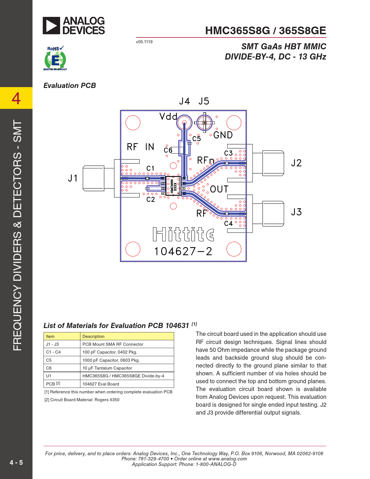

HMC365S8G / 365S8GE. SMT GaAs HBT MMIC. DIVIDE-BY-4, DC - 13 GHz. Evaluation PCB
HMC365S8G / 365S8GE SMT GaAs HBT MMIC DIVIDE-BY-4, DC - 13 GHz Evaluation PCB
HMC365S8G / 365S8GE
v05.1119
4 4 T T M M S - S S - S R R O O T T C C E E T T E E S & D S & D R R E E ID ID IV IV Y D Y D C C N N E E U U Q
List of Materials for Evaluation PCB 104631 [1]
Q E The circuit board used in the application should use Item Description E R RF circuit design techniques. Signal lines should J1 - J3 PCB Mount SMA RF Connector R F have 50 Ohm impedance while the package ground C1 - C4 100 pF Capacitor, 0402 Pkg. F leads and backside ground slug should be con- C5 1000 pF Capacitor, 0603 Pkg. nected directly to the ground plane similar to that C6 10 µF Tantalum Capacitor shown. A sufficient number of via holes should be U1 HMC365S8G / HMC365S8GE Divide-by-4 used to connect the top and bottom ground planes. PCB [2] 104627 Eval Board The evaluation circuit board shown is available [1] Reference this number when ordering complete evaluation PCB from Analog Devices upon request. This evaluation [2] Circuit Board Material: Rogers 4350 board is designed for single ended input testing. J2 and J3 provide differential output signals. For price, delivery, and to place orders: Analog Devices, Inc., One Technology Way, P.O. Box 9106, Norwood, MA 02062-9106
