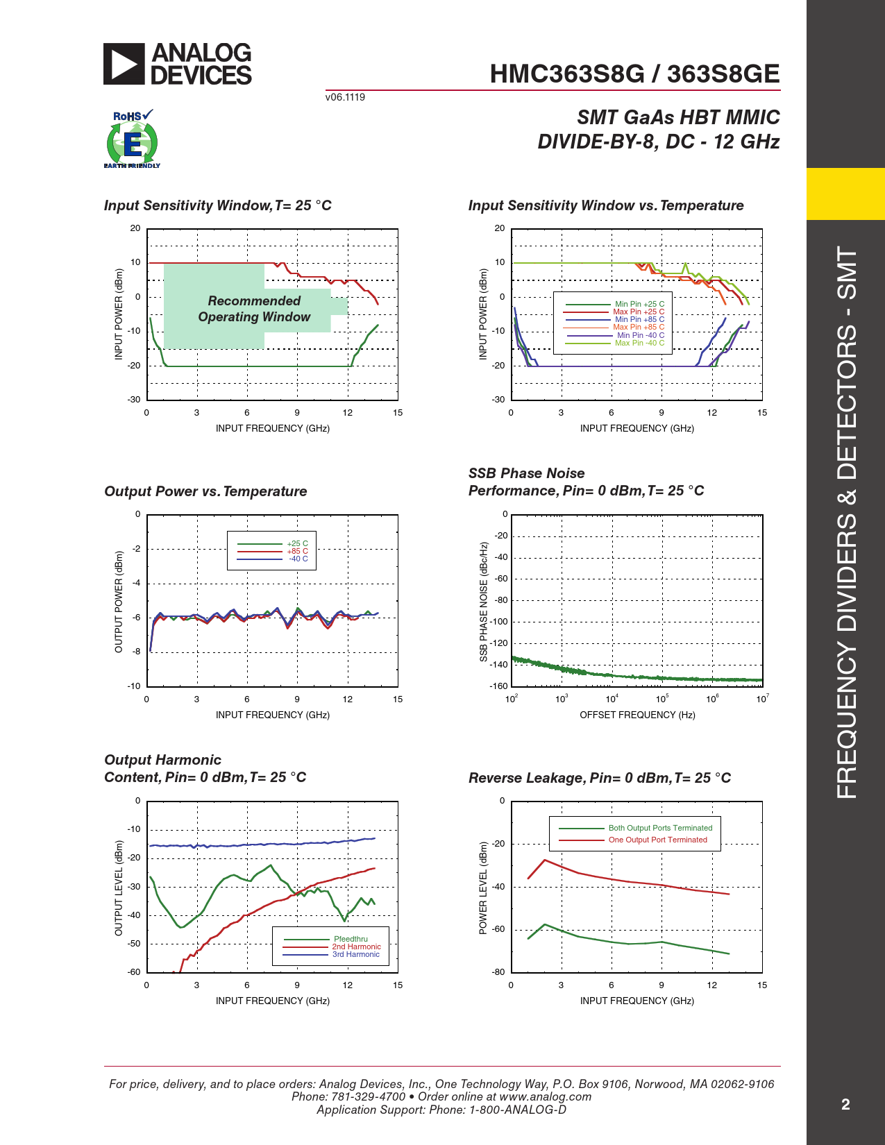

HMC363S8G / 363S8GE. SMT GaAs HBT MMIC. DIVIDE-BY-8, DC - 12 GHz. Input Sensitivity Window, T= 25 °C
HMC363S8G / 363S8GE SMT GaAs HBT MMIC DIVIDE-BY-8, DC - 12 GHz Input Sensitivity Window, T= 25 °C
HMC363S8G / 363S8GE
v06.1119
SMT GaAs HBT MMIC DIVIDE-BY-8, DC - 12 GHz Input Sensitivity Window, T= 25 °C Input Sensitivity Window vs. Temperature
20 20 10 10 t ) m m M (dB 0 (dB R
Recommended
0 R Min Pin +25 C s E E W Max Pin +25 C W O
Operating Window
Min Pin +85 C O P -10 P -10 Max Pin +85 C Min Pin -40 C UT UT Max Pin -40 C s - P P IN IN r -20 -20 o t -30 -30 0 3 6 9 12 15 0 3 6 9 12 15 c INPUT FREQUENCY (GHz) INPUT FREQUENCY (GHz) e t e
SSB Phase Noise Output Power vs. Temperature Performance, Pin= 0 dBm, T= 25 °C
0 0 s & D -20 -2 +25 C +85 C r -40 C -40 e (dBm) (dBc/Hz) -4 -60 iD -80 POWER NOISE -6 iv -100 PHASE -120 OUTPUT -8 SSB y D -140 c -10 -160 n 0 3 6 9 12 15 102 103 104 105 106 107 e INPUT FREQUENCY (GHz) OFFSET FREQUENCY (Hz) u q
Output Harmonic
e
Content, Pin= 0 dBm, T= 25 °C Reverse Leakage, Pin= 0 dBm, T= 25 °C
r 0 0 F -10 Both Output Ports Terminated -20 One Output Port Terminated -20 (dBm) (dBm) -30 -40 LEVEL LEVEL -40 OUTPUT -60 POWER -50 Pfeedthru 2nd Harmonic 3rd Harmonic -60 -80 0 3 6 9 12 15 0 3 6 9 12 15 INPUT FREQUENCY (GHz) INPUT FREQUENCY (GHz) For price, delivery, and to place orders: Analog Devices, Inc., One Technology Way, P.O. Box 9106, Norwood, MA 02062-9106 Phone: 781-329-4700 • Order online at www.analog.com
