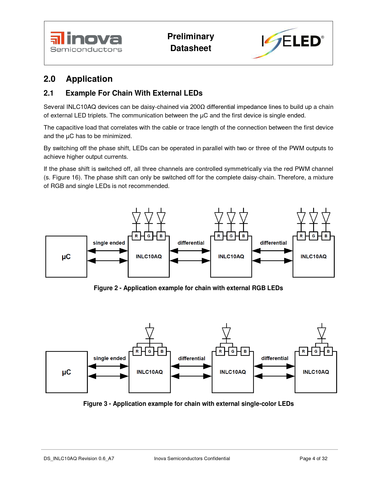

Preliminary. Datasheet. 2.0 Application. 2.1. Example For Chain With External LEDs
Preliminary Datasheet 2.0 Application 2.1 Example For Chain With External LEDs
link to page 21
Several INLC10AQ devices can be daisy-chained via 200Ω differential impedance lines to build up a chain of external LED triplets. The communication between the µC and the first device is single ended. The capacitive load that correlates with the cable or trace length of the connection between the first device and the µC has to be minimized. By switching off the phase shift, LEDs can be operated in parallel with two or three of the PWM outputs to achieve higher output currents. If the phase shift is switched off, all three channels are controlled symmetrically via the red PWM channel (s. Figure 16). The phase shift can only be switched off for the complete daisy-chain. Therefore, a mixture of RGB and single LEDs is not recommended.
Figure 2 - Application example for chain with external RGB LEDs Figure 3 - Application example for chain with external single-color LEDs
