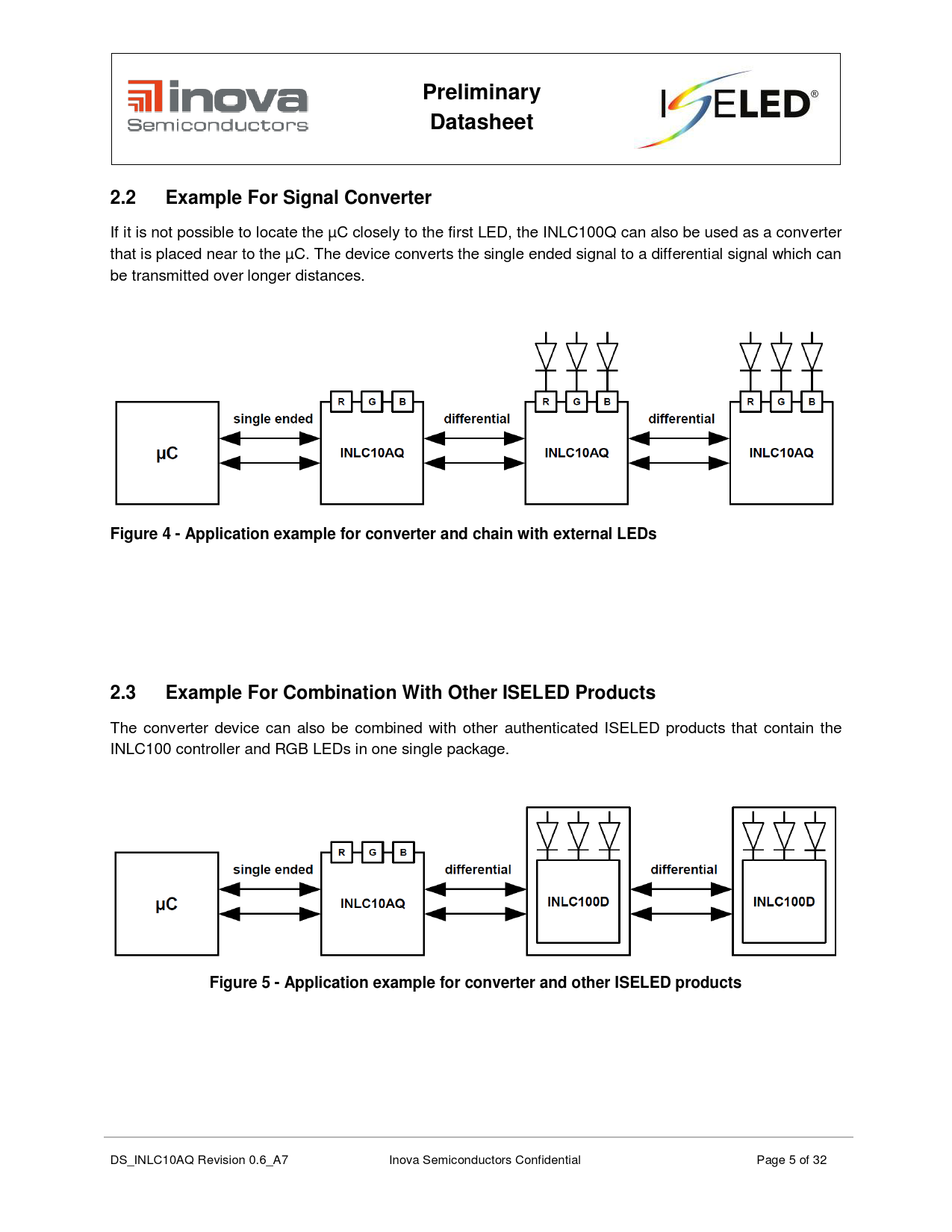

If it is not possible to locate the µC closely to the first LED, the INLC100Q can also be used as a converter that is placed near to the µC. The device converts the single ended signal to a differential signal which can be transmitted over longer distances.
Figure 4 - Application example for converter and chain with external LEDs 2.3 Example For Combination With Other ISELED Products
The converter device can also be combined with other authenticated ISELED products that contain the INLC100 controller and RGB LEDs in one single package.
Figure 5 - Application example for converter and other ISELED products
