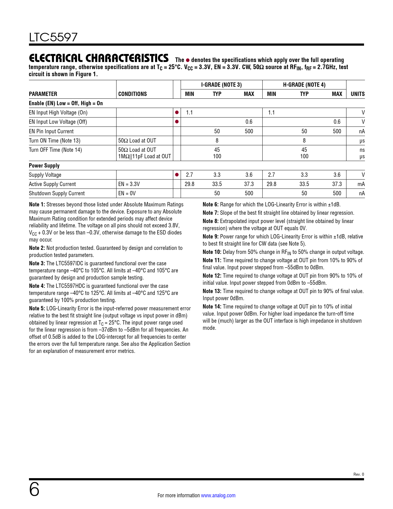

LTC5597
l
denotes the specifications which apply over the full operating temperature range, otherwise specifications are at TC = 25°C. VCC = 3.3V, EN = 3.3V. CW, 50Ω source at RFIN, fRF = 2.7GHz, test circuit is shown in Figure 1. I-GRADE (NOTE 3) H-GRADE (NOTE 4) PARAMETER CONDITIONS MIN TYP MAX MIN TYP MAX UNITS Enable (EN) Low = Off, High = On
EN Input High Voltage (On) l 1.1 1.1 V EN Input Low Voltage (Off) l 0.6 0.6 V EN Pin Input Current 50 500 50 500 nA Turn ON Time (Note 13) 50Ω Load at OUT 8 8 μs Turn OFF Time (Note 14) 50Ω Load at OUT 45 45 ns 1MΩ||11pF Load at OUT 100 100 μs
Power Supply
Supply Voltage l 2.7 3.3 3.6 2.7 3.3 3.6 V Active Supply Current EN = 3.3V 29.8 33.5 37.3 29.8 33.5 37.3 mA Shutdown Supply Current EN = 0V 50 500 50 500 nA
Note 1:
Note 6:
Range for which the LOG-Linearity Error is within ±1dB. may cause permanent damage to the device. Exposure to any Absolute
Note 7:
Slope of the best fit straight line obtained by linear regression. Maximum Rating condition for extended periods may affect device
Note 8:
Extrapolated input power level (straight line obtained by linear reliability and lifetime. The voltage on all pins should not exceed 3.8V, regression) where the voltage at OUT equals 0V. VCC + 0.3V or be less than –0.3V, otherwise damage to the ESD diodes
Note 9:
Power range for which LOG-Linearity Error is within ±1dB, relative may occur. to best fit straight line for CW data (see Note 5).
Note 2:
Not production tested. Guaranteed by design and correlation to
Note 10:
Delay from 50% change in RFIN to 50% change in output voltage. production tested parameters.
Note 11:
Time required to change voltage at OUT pin from 10% to 90% of
Note 3:
The LTC5597IDC is guaranteed functional over the case final value. Input power stepped from –55dBm to 0dBm. temperature range –40°C to 105°C. All limits at –40°C and 105°C are
Note 12:
Time required to change voltage at OUT pin from 90% to 10% of guaranteed by design and production sample testing. initial value. Input power stepped from 0dBm to –55dBm.
Note 4:
The LTC5597HDC is guaranteed functional over the case
Note 13:
Time required to change voltage at OUT pin to 90% of final value. temperature range –40°C to 125°C. All limits at –40°C and 125°C are Input power 0dBm. guaranteed by 100% production testing.
Note 14:
Time required to change voltage at OUT pin to 10% of initial
Note 5:
LOG-Linearity Error is the input-referred power measurement error value. Input power 0dBm. For higher load impedance the turn-off time relative to the best fit straight line (output voltage vs input power in dBm) will be (much) larger as the OUT interface is high impedance in shutdown obtained by linear regression at TC = 25°C. The input power range used mode. for the linear regression is from –37dBm to –5dBm for all frequencies. An offset of 0.5dB is added to the LOG-intercept for all frequencies to center the errors over the full temperature range. See also the Application Section for an explanation of measurement error metrics. Rev. 0 6 For more information www.analog.com Document Outline Features Applications Typical Application Description Absolute Maximum Ratings Order Information Electrical Characteristics Pin Configuration Electrical Characteristics Typical Performance Characteristics Pin Functions Test Circuit Applications Information Package Description Typical Application Related Parts
