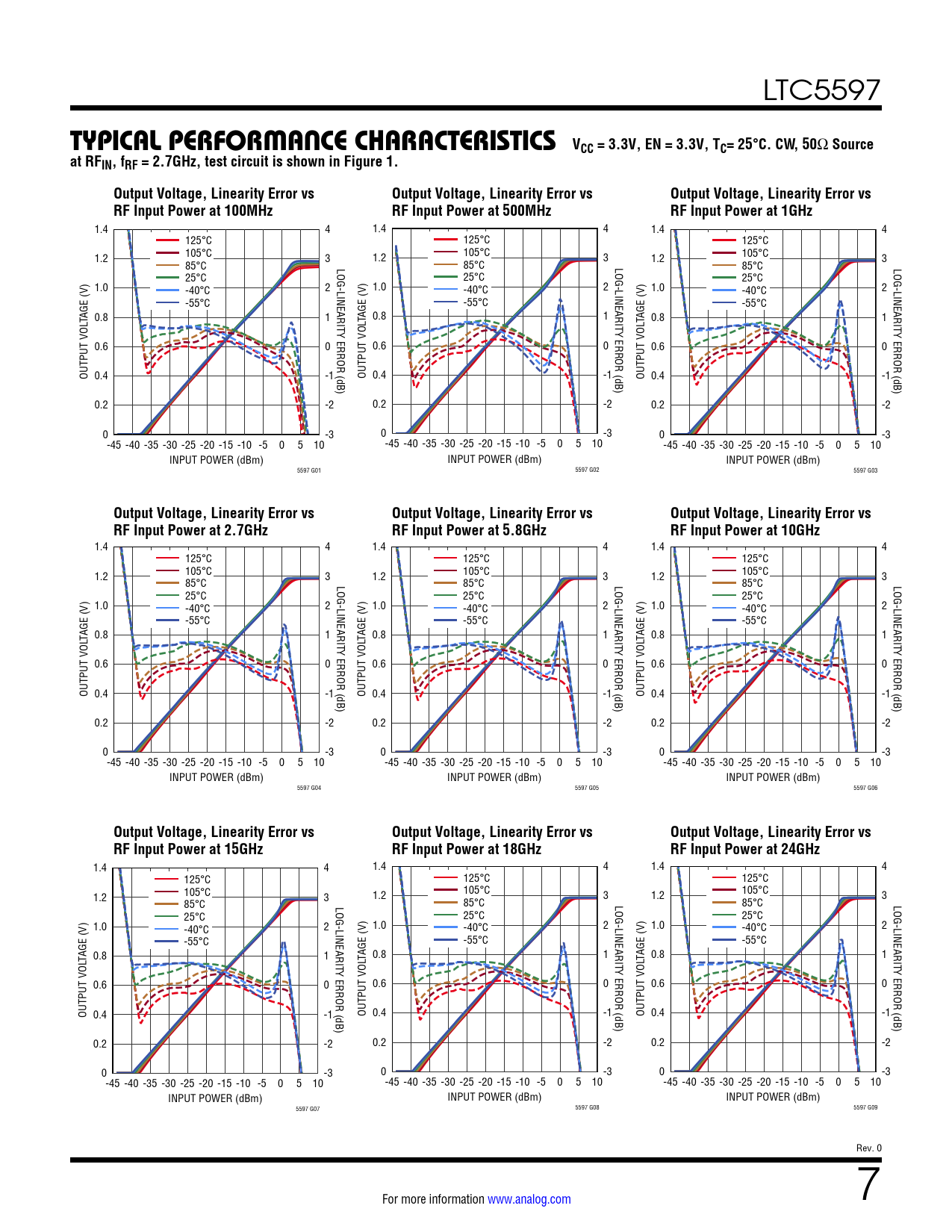

TYPICAL PERFORMANCE CHARACTERISTICS VCC = 3.3V, EN = 3.3V, TC= 25°C. CW, 50. Source
TYPICAL PERFORMANCE CHARACTERISTICS VCC = 3.3V, EN = 3.3V, TC= 25°C CW, 50 Source
LTC5597
Ω
Source at RFIN, fRF = 2.7GHz, test circuit is shown in Figure 1. Output Voltage, Linearity Error vs Output Voltage, Linearity Error vs Output Voltage, Linearity Error vs RF Input Power at 100MHz RF Input Power at 500MHz RF Input Power at 1GHz
1.4 4 1.4 4 1.4 4 125°C 125°C 125°C 1.2 105°C 3 1.2 105°C 3 1.2 105°C 3 85°C LOG-LINEARIT 85°C LOG-LINEARIT 85°C LOG-LINEARIT 25°C 25°C 25°C 1.0 2 -40°C 1.0 2 -40°C 1.0 2 -40°C -55°C -55°C -55°C TAGE (V) 0.8 1 TAGE (V) 0.8 1 TAGE (V) 0.8 1 Y ERROR (dB) Y ERROR (dB) Y ERROR (dB) 0.6 0 0.6 0 0.6 0 OUTPUT VOL 0.4 -1 OUTPUT VOL 0.4 -1 OUTPUT VOL 0.4 -1 0.2 -2 0.2 -2 0.2 -2 0 -3 0 -3 0 -3 -45 -40 -35 -30 -25 -20 -15 -10 -5 0 5 10 -45 -40 -35 -30 -25 -20 -15 -10 -5 0 5 10 -45 -40 -35 -30 -25 -20 -15 -10 -5 0 5 10 INPUT POWER (dBm) INPUT POWER (dBm) INPUT POWER (dBm) 5597 G01 5597 G02 5597 G03
Output Voltage, Linearity Error vs Output Voltage, Linearity Error vs Output Voltage, Linearity Error vs RF Input Power at 2.7GHz RF Input Power at 5.8GHz RF Input Power at 10GHz
1.4 4 1.4 4 1.4 4 125°C 125°C 125°C 1.2 105°C 3 1.2 105°C 3 1.2 105°C 3 85°C LOG-LINEARIT 85°C LOG-LINEARIT 85°C LOG-LINEARIT 25°C 25°C 25°C 1.0 2 -40°C 1.0 2 -40°C 1.0 2 -40°C -55°C -55°C -55°C TAGE (V) 0.8 1 TAGE (V) 0.8 1 TAGE (V) 0.8 1 Y ERROR (dB) Y ERROR (dB) Y ERROR (dB) 0.6 0 0.6 0 0.6 0 OUTPUT VOL 0.4 -1 OUTPUT VOL 0.4 -1 OUTPUT VOL 0.4 -1 0.2 -2 0.2 -2 0.2 -2 0 -3 0 -3 0 -3 -45 -40 -35 -30 -25 -20 -15 -10 -5 0 5 10 -45 -40 -35 -30 -25 -20 -15 -10 -5 0 5 10 -45 -40 -35 -30 -25 -20 -15 -10 -5 0 5 10 INPUT POWER (dBm) INPUT POWER (dBm) INPUT POWER (dBm) 5597 G04 5597 G05 5597 G06
Output Voltage, Linearity Error vs Output Voltage, Linearity Error vs Output Voltage, Linearity Error vs RF Input Power at 15GHz RF Input Power at 18GHz RF Input Power at 24GHz
1.4 4 1.4 4 1.4 4 125°C 125°C 125°C 1.2 105°C 3 1.2 105°C 3 1.2 105°C 3 85°C LOG-LINEARIT 85°C LOG-LINEARIT 85°C LOG-LINEARIT 25°C 25°C 25°C 1.0 2 -40°C 1.0 2 -40°C 1.0 2 -40°C -55°C -55°C -55°C TAGE (V) 0.8 1 TAGE (V) 0.8 1 TAGE (V) 0.8 1 Y ERROR (dB) Y ERROR (dB) Y ERROR (dB) 0.6 0 0.6 0 0.6 0 OUTPUT VOL 0.4 -1 OUTPUT VOL 0.4 -1 OUTPUT VOL 0.4 -1 0.2 -2 0.2 -2 0.2 -2 0 -3 0 -3 0 -3 -45 -40 -35 -30 -25 -20 -15 -10 -5 0 5 10 -45 -40 -35 -30 -25 -20 -15 -10 -5 0 5 10 -45 -40 -35 -30 -25 -20 -15 -10 -5 0 5 10 INPUT POWER (dBm) INPUT POWER (dBm) INPUT POWER (dBm) 5597 G07 5597 G08 5597 G09 Rev. 0 For more information www.analog.com 7 Document Outline Features Applications Typical Application Description Absolute Maximum Ratings Order Information Electrical Characteristics Pin Configuration Electrical Characteristics Typical Performance Characteristics Pin Functions Test Circuit Applications Information Package Description Typical Application Related Parts
