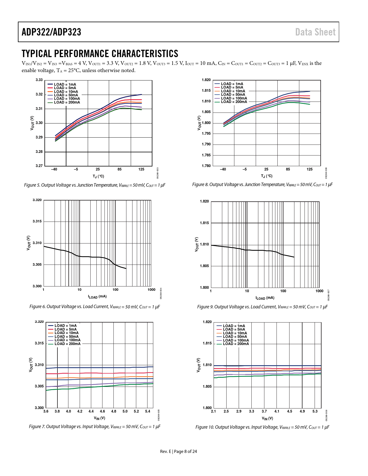

ADP322/ADP323. Data Sheet. TYPICAL PERFORMANCE CHARACTERISTICS. 3.33. 1.820. LOAD = 1mA. LOAD = 5mA. LOAD = 10mA. 1.815. 3.32. LOAD = 50mA
ADP322/ADP323 Data Sheet TYPICAL PERFORMANCE CHARACTERISTICS
VIN1/VIN2 = VIN3 =VBIAS = 4 V, VOUT1 = 3.3 V, VOUT2 = 1.8 V, VOUT3 = 1.5 V, IOUT = 10 mA, CIN = COUT1 = COUT2 = COUT3 = 1 µF, VENX is the enable voltage, TA = 25°C, unless otherwise noted.
3.33 1.820 LOAD = 1mA LOAD = 1mA LOAD = 5mA LOAD = 5mA LOAD = 10mA 1.815 LOAD = 10mA 3.32 LOAD = 50mA LOAD = 50mA LOAD = 100mA LOAD = 100mA LOAD = 200mA 1.810 LOAD = 200mA 3.31 1.805 (V) (V) 3.30 1.800 UT UT O O V V 1.795 3.29 1.790 3.28 1.785 3.27 1.780 –40 –5 25 85 125 –40 –5 25 85 125

09288- Figure 5. Output Voltage vs. Junction Temperature, VRIPPLE = 50 mV, COUT = 1 µF Figure 8. Output Voltage vs. Junction Temperature, VRIPPLE = 50 mV, COUT = 1 µF
3.320 1.820 3.315 1.815 (V) 3.310 (V) UT 1.810 O UT V OV 3.305 1.805 3.300 1.800 1 10 100 1000

09288- Figure 6. Output Voltage vs. Load Current, VRIPPLE = 50 mV, COUT = 1 µF Figure 9. Output Voltage vs. Load Current, VRIPPLE = 50 mV, COUT = 1 µF
3.320 1.820 LOAD = 1mA LOAD = 1mA LOAD = 5mA LOAD = 5mA LOAD = 10mA LOAD = 10mA LOAD = 50mA LOAD = 50mA LOAD = 100mA LOAD = 100mA 3.315 LOAD = 200mA 1.815 LOAD = 200mA (V) (V) 3.310 1.810 UT UT O O V V 3.305 1.805 3.300 1.800 3.6 3.8 4.0 4.2 4.4 4.6 4.8 5.0 5.2 5.4

IN (V)
