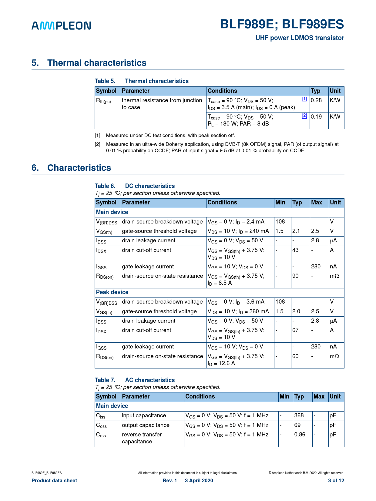

BLF989E; BLF989ES. UHF power LDMOS transistor. 5. Thermal. characteristics. Table 5. Thermal characteristics. Symbol. Parameter
BLF989E; BLF989ES UHF power LDMOS transistor 5 Thermal characteristics Table 5 Thermal characteristics Symbol Parameter
link to page 3 link to page 3
BLF989E; BLF989ES UHF power LDMOS transistor 5. Thermal characteristics Table 5. Thermal characteristics Symbol Parameter Conditions Typ Unit
R [1] th(j-c) thermal resistance from junction Tcase = 90 C; VDS = 50 V; 0.28 K/W to case IDS = 3.5 A (main); IDS = 0 A (peak) T [2] case = 90 C; VDS = 50 V; 0.19 K/W PL = 180 W; PAR = 8 dB [1] Measured under DC test conditions, with peak section off. [2] Measured in an ultra-wide Doherty application, using DVB-T (8k OFDM) signal, PAR (of output signal) at 0.01 % probability on CCDF; PAR of input signal = 9.5 dB at 0.01 % probability on CCDF.
6. Characteristics Table 6. DC characteristics
Tj = 25 C; per section unless otherwise specified.
Symbol Parameter Conditions Min Typ Max Unit Main device
V(BR)DSS drain-source breakdown voltage VGS = 0 V; ID = 2.4 mA 108 - - V VGS(th) gate-source threshold voltage VDS = 10 V; ID = 240 mA 1.5 2.1 2.5 V IDSS drain leakage current VGS = 0 V; VDS = 50 V - - 2.8 A IDSX drain cut-off current VGS = VGS(th) + 3.75 V; - 43 - A VDS = 10 V IGSS gate leakage current VGS = 10 V; VDS = 0 V - - 280 nA RDS(on) drain-source on-state resistance VGS = VGS(th) + 3.75 V; - 90 - m ID = 8.5 A
Peak device
V(BR)DSS drain-source breakdown voltage VGS = 0 V; ID = 3.6 mA 108 - - V VGS(th) gate-source threshold voltage VDS = 10 V; ID = 360 mA 1.5 2.0 2.5 V IDSS drain leakage current VGS = 0 V; VDS = 50 V - - 2.8 A IDSX drain cut-off current VGS = VGS(th) + 3.75 V; - 67 - A VDS = 10 V IGSS gate leakage current VGS = 10 V; VDS = 0 V - - 280 nA RDS(on) drain-source on-state resistance VGS = VGS(th) + 3.75 V; - 60 - m ID = 12.6 A
Table 7. AC characteristics
Ciss input capacitance VGS = 0 V; VDS = 50 V; f = 1 MHz - 368 - pF Coss output capacitance VGS = 0 V; VDS = 50 V; f = 1 MHz - 69 - pF Crss reverse transfer VGS = 0 V; VDS = 50 V; f = 1 MHz - 0.86 - pF capacitance BLF989E_BLF989ES All information provided in this document is subject to legal disclaimers. © Ampleon Netherlands B.V. 2020. All rights reserved.
