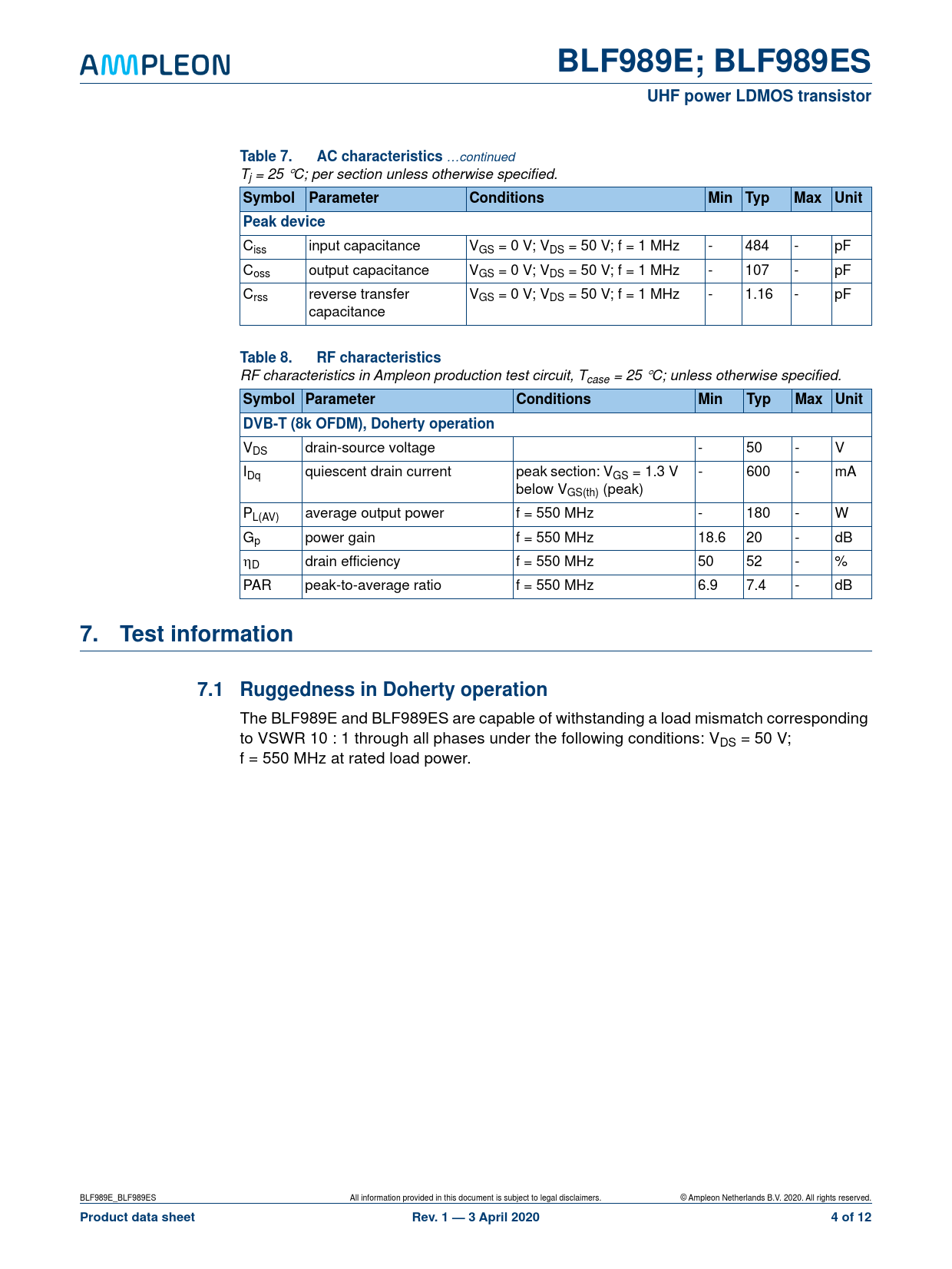

BLF989E; BLF989ES. UHF power LDMOS transistor. Table 7. AC characteristics. Symbol. Parameter. Conditions. Min Typ. Max Unit. Peak device
BLF989E; BLF989ES UHF power LDMOS transistor Table 7 AC characteristics Symbol Parameter Conditions Min Typ Max Unit Peak device
BLF989E; BLF989ES UHF power LDMOS transistor Table 7. AC characteristics
…continued Tj = 25 C; per section unless otherwise specified.
Ciss input capacitance VGS = 0 V; VDS = 50 V; f = 1 MHz - 484 - pF Coss output capacitance VGS = 0 V; VDS = 50 V; f = 1 MHz - 107 - pF Crss reverse transfer VGS = 0 V; VDS = 50 V; f = 1 MHz - 1.16 - pF capacitance
Table 8. RF characteristics
RF characteristics in Ampleon production test circuit, Tcase = 25 C; unless otherwise specified.
Symbol Parameter Conditions Min Typ Max Unit DVB-T (8k OFDM), Doherty operation
VDS drain-source voltage - 50 - V IDq quiescent drain current peak section: VGS = 1.3 V - 600 - mA below VGS(th) (peak) PL(AV) average output power f = 550 MHz - 180 - W Gp power gain f = 550 MHz 18.6 20 - dB D drain efficiency f = 550 MHz 50 52 - % PAR peak-to-average ratio f = 550 MHz 6.9 7.4 - dB
7. Test information 7.1 Ruggedness in Doherty operation
The BLF989E and BLF989ES are capable of withstanding a load mismatch corresponding to VSWR 10 : 1 through all phases under the following conditions: VDS = 50 V; f = 550 MHz at rated load power. BLF989E_BLF989ES All information provided in this document is subject to legal disclaimers. © Ampleon Netherlands B.V. 2020. All rights reserved.
