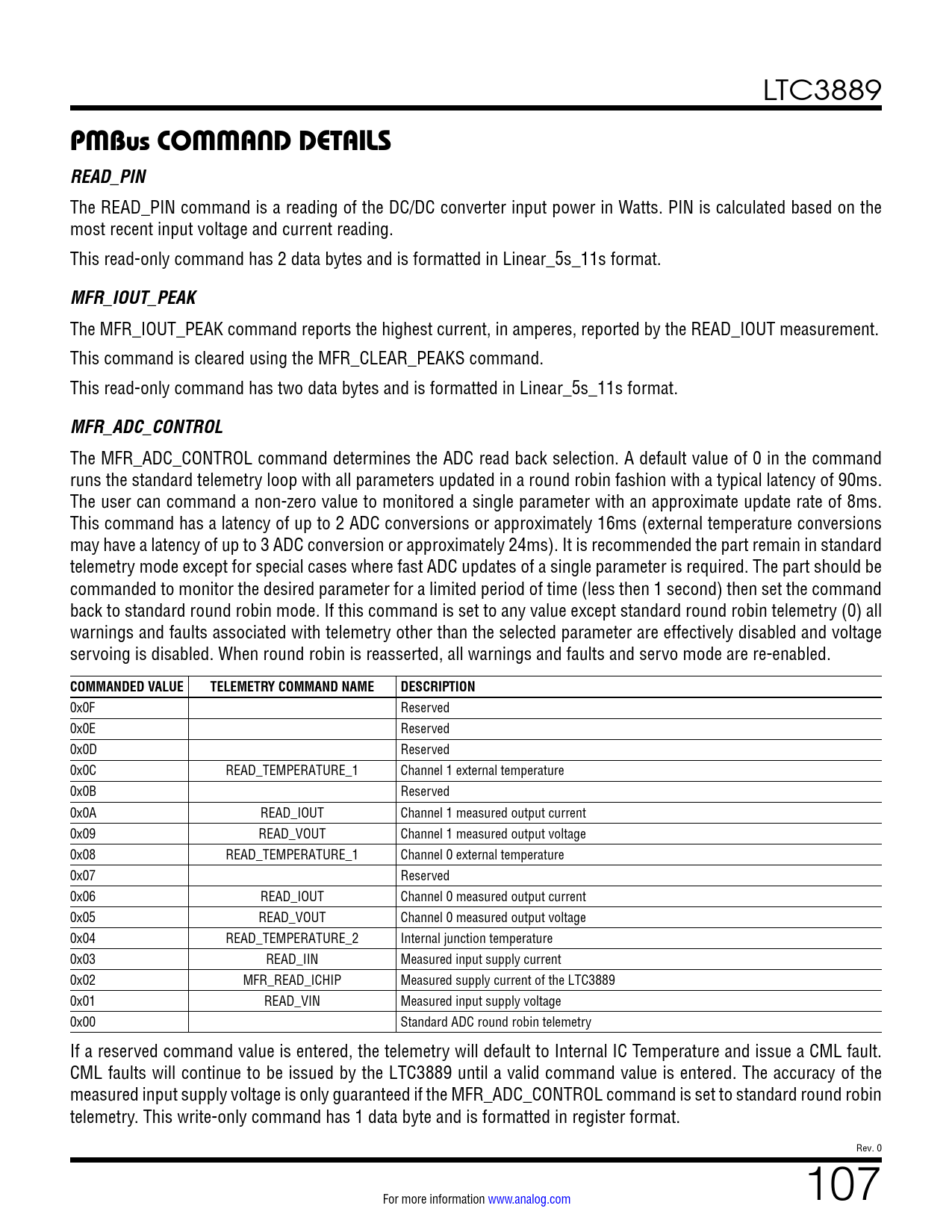

LTC3889
PMBus COMMAND DETAILS READ_PIN
The READ_PIN command is a reading of the DC/DC converter input power in Watts. PIN is calculated based on the most recent input voltage and current reading. This read-only command has 2 data bytes and is formatted in Linear_5s_11s format.
MFR_IOUT_PEAK
The MFR_IOUT_PEAK command reports the highest current, in amperes, reported by the READ_IOUT measurement. This command is cleared using the MFR_CLEAR_PEAKS command. This read-only command has two data bytes and is formatted in Linear_5s_11s format.
MFR_ADC_CONTROL
The MFR_ADC_CONTROL command determines the ADC read back selection. A default value of 0 in the command runs the standard telemetry loop with all parameters updated in a round robin fashion with a typical latency of 90ms. The user can command a non-zero value to monitored a single parameter with an approximate update rate of 8ms. This command has a latency of up to 2 ADC conversions or approximately 16ms (external temperature conversions may have a latency of up to 3 ADC conversion or approximately 24ms). It is recommended the part remain in standard telemetry mode except for special cases where fast ADC updates of a single parameter is required. The part should be commanded to monitor the desired parameter for a limited period of time (less then 1 second) then set the command back to standard round robin mode. If this command is set to any value except standard round robin telemetry (0) all warnings and faults associated with telemetry other than the selected parameter are effectively disabled and voltage servoing is disabled. When round robin is reasserted, all warnings and faults and servo mode are re-enabled.
COMMANDED VALUE TELEMETRY COMMAND NAME DESCRIPTION
0x0F Reserved 0x0E Reserved 0x0D Reserved 0x0C READ_TEMPERATURE_1 Channel 1 external temperature 0x0B Reserved 0x0A READ_IOUT Channel 1 measured output current 0x09 READ_VOUT Channel 1 measured output voltage 0x08 READ_TEMPERATURE_1 Channel 0 external temperature 0x07 Reserved 0x06 READ_IOUT Channel 0 measured output current 0x05 READ_VOUT Channel 0 measured output voltage 0x04 READ_TEMPERATURE_2 Internal junction temperature 0x03 READ_IIN Measured input supply current 0x02 MFR_READ_ICHIP Measured supply current of the LTC3889 0x01 READ_VIN Measured input supply voltage 0x00 Standard ADC round robin telemetry If a reserved command value is entered, the telemetry will default to Internal IC Temperature and issue a CML fault. CML faults will continue to be issued by the LTC3889 until a valid command value is entered. The accuracy of the measured input supply voltage is only guaranteed if the MFR_ADC_CONTROL command is set to standard round robin telemetry. This write-only command has 1 data byte and is formatted in register format. Rev. 0 For more information www.analog.com 107 Document Outline Table of Contents Features Applications Typical Application Description Table of Contents Absolute Maximum Ratings Order Information Pin Configuration Electrical Characteristics Typical Performance Characteristics Pin Functions Block Diagram Operation Overview Main Control Loop EEPROM CRC Protection Power-Up and Initialization Soft-Start Time-Based Sequencing Event-Based Sequencing Shutdown Light-Load Current Operation PWM Loop Compensation Switching Frequency and Phase Output Voltage Sensing Output Current Sensing Input Current Sensing PolyPhase Load Sharing External/Internal Temperature Sense RCONFIG (Resistor Configuration) Pins Fault Handling Status Registers and ALERT Masking Mapping Faults to FAULT Pins Power Good Pins Serial Interface Communication Protection Device Addressing Responses to VOUT and IOUT Faults Output Overvoltage Fault Response Output Undervoltage Response Peak Output Overcurrent Fault Response Responses to Timing Faults Responses to VIN OV Faults Responses to OT/UT Faults Internal Overtemperature Fault/Warn Response External Overtemperature and Undertemperature Fault Response Responses to External Faults Fault Logging Bus Timeout Protection Similarity Between PMBus, SMBus and I2C 2-Wire Interface PMBus Serial Digital Interface PMBus Command Summary PMBus Commands Applications Information Current Limit Programming ISENSE+ and ISENSE– Pins Low Value Resistor Current Sensing Inductor DCR Current Sensing Slope Compensation and Inductor Peak Current Inductor Value Calculation Inductor Core Selection Power MOSFET and Optional Schottky Diode Selection CIN and COUT Selection Variable Delay Time, Soft-Start and Output Voltage Ramping Digital Servo Mode Soft Off (Sequenced Off) DRVCC Regulator Topside MOSFET Driver Supply (CB, DB) Undervoltage Lockout Fault Indications Open-Drain Pins Phase-Locked Loop and Frequency Synchronization Minimum On-Time Considerations External Temperature Sense Derating EEPROM Retention at Temperature Input Current Sense Amplifier External Resistor Configuration Pins (RCONFIG) Voltage Selection Frequency Selection Phase Selection Address Selection Using RCONFIG Efficiency Considerations Programmable Loop Compensation Checking Transient Response PolyPhase Configuration PC Board Layout Checklist PC Board Layout Debugging Design Example Additional Design Checks Connecting the USB to I2C/SMBus/PMBus Adapter to the LTC3889 In System LTpowerPlay: An Interactive GUI for Digital Power PMBus Communication and Command Processing PMBus Command Details Addressing and Write Protect General Configuration COMMANDS On/Off/Margin PWM Configuration Voltage Input Voltage and Limits Output Voltage and Limits Output Current and Limits Input Current and Limits Temperature External Temperature Calibration Timing Timing—On Sequence/Ramp Timing—Off Sequence/Ramp Precondition for Restart Fault Response Fault Responses All Faults Fault Responses Input Voltage Fault Responses Output Voltage Fault Responses Output Current Fault Responses IC Temperature Fault Responses External Temperature Fault Sharing Fault Sharing Propagation Fault Sharing Response Scratchpad Identification Fault Warning and Status Telemetry EEPROM Memory Commands Store/Restore Fault Logging Fault Log Operation Block Memory Write/Read Typical Applications Package Description Typical Application Related Parts
