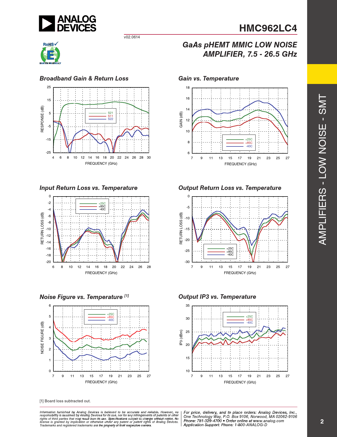

HMC962LC4. GaAs pHEMT MMIC LOW NOISE. AMPLIFIER, 7.5 - 26.5 GHz. Broadband Gain & Return Loss. Gain vs. Temperature
HMC962LC4 GaAs pHEMT MMIC LOW NOISE AMPLIFIER, 7.5 - 26.5 GHz Broadband Gain & Return Loss Gain vs Temperature
HMC962LC4
v02.0614
GaAs pHEMT MMIC LOW NOISE AMPLIFIER, 7.5 - 26.5 GHz Broadband Gain & Return Loss Gain vs. Temperature
25 18 16 15 T m 14 (dB) 5 S21 S11 s (dB) S22 12 -5 GAIN RESPONSE 10 e - -15 +25C is 8 +85C -40C o -25 6 4 6 8 10 12 14 16 18 20 22 24 26 28 30 7 9 11 13 15 17 19 21 23 25 27 FREQUENCY (GHz) FREQUENCY (GHz) w N lo
Input Return Loss vs. Temperature Output Return Loss vs. Temperature
s - 0 0 r -2 +25C +85C -5 -4 -40C ie -6 (dB) (dB) -10 -8 lif LOSS LOSS -10 -15 p -12 m -20 -14 RETURN RETURN A -16 +25C -25 +85C -40C -18 -20 -30 6 8 10 12 14 16 18 20 22 24 26 28 7 9 11 13 15 17 19 21 23 25 27 FREQUENCY (GHz) FREQUENCY (GHz)
Noise Figure vs. Temperature [1] Output IP3 vs. Temperature
6 35 +25C 5 +85C 30 +25C -40C +85C ) -40C (dB 4 E ) R 25 U IG 3 (dBm F E IP3 20 IS 2 O N 15 1 0 10 7 9 11 13 15 17 19 21 23 25 27 7 9 11 13 15 17 19 21 23 25 27 FREQUENCY (GHz) FREQUENCY (GHz) [1] Board loss subtracted out. Inf F or o m r p atio r n ifc ur e n , d ishe e d lbiv y e A r n y a alog n D d t evic o p es is la beclie o eved rd to ebre sa: H ccur iattti e tae M nd re ilicarbloew . H a o ve C wever, o n rp o For price, delivery, and to place orders: Analog Devices, Inc., responsibility is assumed by Analog Devices for its use, nor for any infringements of patents or other oration, 2 Elizabeth Drive, Chelmsford, MA 01824 One Technology Way, P.O. Box 9106, Norwood, MA 02062-9106 Phone: 978-250-3343 Fax: 978-250-3373 O rights of third parties that may result from its use. Specifications subject to change without notice. No P rd hone e r O : 7 n 81- -3li 2n 9 e a -47 t w 0 w 0 • O w rd .h e it r o t niltie n .c e ao t m license is granted by implication or otherwise under any patent or patent rights of Analog Devices. www.analog.com
