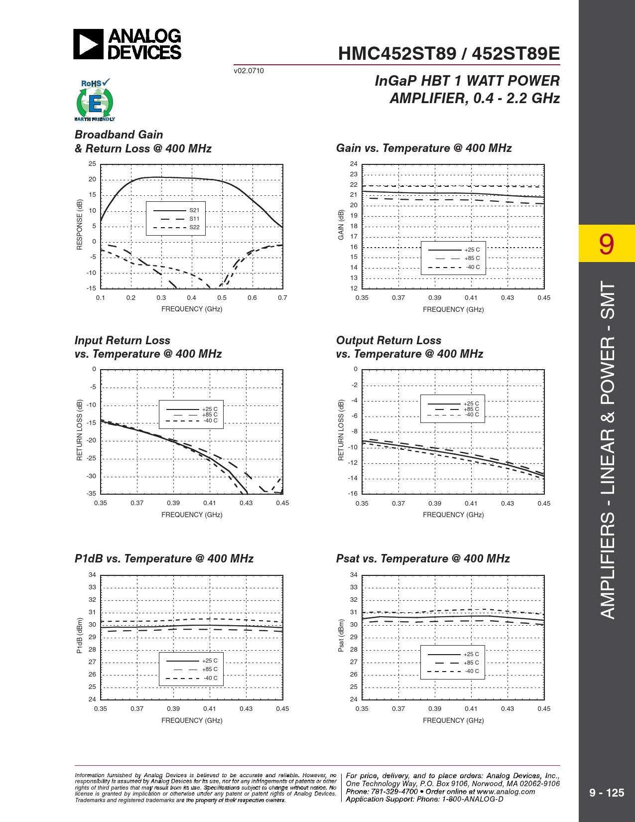

DescriptionInGaP HBT 1 WATT POWER AMPLIFIER, 0.4 - 2.2 GHz
Pages / Page22 / 2 — HMC452ST89 / 452ST89E. InGaP HBT 1 WATT POWER. AMPLIFIER, 0.4 - 2.2 GHz. …
HMC452ST89 / 452ST89E. InGaP HBT 1 WATT POWER. AMPLIFIER, 0.4 - 2.2 GHz. Broadband Gain & Return Loss @ 400 MHz
HMC452ST89 / 452ST89E InGaP HBT 1 WATT POWER AMPLIFIER, 0.4 - 2.2 GHz Broadband Gain & Return Loss @ 400 MHz
v02.0710
InGaP HBT 1 WATT POWER AMPLIFIER, 0.4 - 2.2 GHz Broadband Gain & Return Loss @ 400 MHz Gain vs. Temperature @ 400 MHz
25 24 23 20 22 15 21 20 10 S21 19 S11 (dB) 5 S22 18 17 GAIN 0 RESPONSE (dB) 16 +25 C 9 -5 15 +85 C 14 -40 C -10 13 -15 12 T 0.1 0.2 0.3 0.4 0.5 0.6 0.7 0.35 0.37 0.39 0.41 0.43 0.45 FREQUENCY (GHz) FREQUENCY (GHz)
Input Return Loss Output Return Loss
R - SM
vs. Temperature @ 400 MHz vs. Temperature @ 400 MHz
E 0 0 W -2 -5 O -4 +25 C -10 +25 C +85 C +85 C -6 -40 C -15 -40 C -8 -20 R & P -10 A RETURN LOSS (dB) -25 RETURN LOSS (dB) -12 E -30 -14 IN -35 -16 0.35 0.37 0.39 0.41 0.43 0.45 0.35 0.37 0.39 0.41 0.43 0.45 FREQUENCY (GHz) FREQUENCY (GHz) S - L R IE
P1dB vs. Temperature @ 400 MHz Psat vs. Temperature @ 400 MHz
IF 34 34 L 33 33 P 32 32 M 31 31 A 30 30 29 29 28 Psat (dBm) 28 P1dB (dBm) +25 C 27 +25 C 27 +85 C +85 C -40 C 26 26 -40 C 25 25 24 24 0.35 0.37 0.39 0.41 0.43 0.45 0.35 0.37 0.39 0.41 0.43 0.45 FREQUENCY (GHz) FREQUENCY (GHz) Info F rmoatr pr ion f iurcne, de ished b ly iv A e n r al y o a g D n evd to p ices is bla eli c eve o ed t rde o be ras: H ccuratite tiatne M d reli iacr ble ow . Ho av wev e C er, n o o rpo Fora r t p iro ic n e ,, 2 d 0 eli A ve lrpha R y, and toad, C o place hoel rd m er s s fo : Ard, MA 01 nalog Devic 8 e 2 s 4 , Inc., responsibility is assumed by Analog Devices for its use, nor for any infringements of patents or other One Technology Way, P.O. Box 9106, Norwood, MA 02062-9106 Phone: 978-250-3343 Fax: 978-250-3373 O rights of third parties that may result from its use. Specifications subject to change without notice. No P rde hone r O : 7 n 81- -3li 2n 9 e a -47 t w 0 w 0 • O w rd .ehit r o t nilte in .c e ao t m license is granted by implication or otherwise under any patent or patent rights of Analog Devices. www.analog.com
