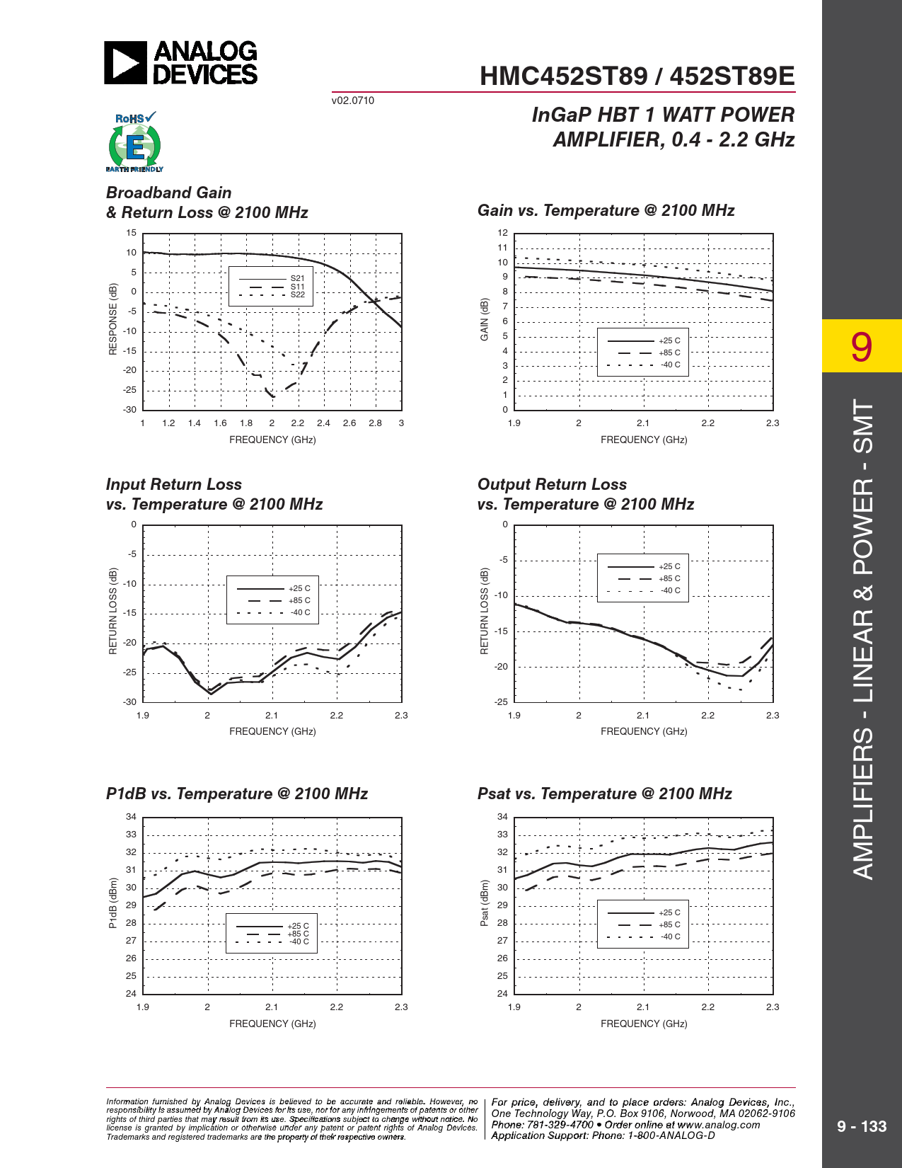

HMC452ST89 / 452ST89E. InGaP HBT 1 WATT POWER. AMPLIFIER, 0.4 - 2.2 GHz. Broadband Gain & Return Loss @ 2100 MHz
HMC452ST89 / 452ST89E InGaP HBT 1 WATT POWER AMPLIFIER, 0.4 - 2.2 GHz Broadband Gain & Return Loss @ 2100 MHz
v02.0710
InGaP HBT 1 WATT POWER AMPLIFIER, 0.4 - 2.2 GHz Broadband Gain & Return Loss @ 2100 MHz Gain vs. Temperature @ 2100 MHz
15 12 11 10 10 5 S21 9 S11 0 S22 8 7 -5 (dB) 6 -10 5 GAIN +25 C -15 RESPONSE (dB) 4 +85 C -40 C 9 3 -20 2 -25 1 -30 0 T 1 1.2 1.4 1.6 1.8 2 2.2 2.4 2.6 2.8 3 1.9 2 2.1 2.2 2.3 FREQUENCY (GHz) FREQUENCY (GHz)
Input Return Loss Output Return Loss
R - SM
vs. Temperature @ 2100 MHz vs. Temperature @ 2100 MHz
E 0 0 W -5 -5 O +25 C +85 C -10 +25 C -40 C -10 +85 C -15 -40 C R & P -15 -20 A RETURN LOSS (dB) RETURN LOSS (dB) E -20 -25 IN -30 -25 1.9 2 2.1 2.2 2.3 1.9 2 2.1 2.2 2.3 FREQUENCY (GHz) FREQUENCY (GHz) S - L R IE
P1dB vs. Temperature @ 2100 MHz Psat vs. Temperature @ 2100 MHz
IF 34 34 L 33 33 P 32 32 M 31 31 A 30 30 29 29 +25 C 28 P1dB (dBm) +25 C Psat (dBm) 28 +85 C +85 C 27 -40 C -40 C 27 26 26 25 25 24 24 1.9 2 2.1 2.2 2.3 1.9 2 2.1 2.2 2.3 FREQUENCY (GHz) FREQUENCY (GHz) Info F rmoatr pr ion f iurcne, de ished b ly iv A e n r al y o a g D n evd to p ices is bla eli c eve o ed t rde o be ras: H ccuratite tiatne M d reli iacr ble ow . Ho av wev e C er, n o o rpo Fora r t p iro ic n e ,, 2 d 0 eli A ve lrpha R y, and toad, C o place hoel rd m er s s fo : Ard, MA 01 nalog Devic 8 e 2 s 4 , Inc., responsibility is assumed by Analog Devices for its use, nor for any infringements of patents or other One Technology Way, P.O. Box 9106, Norwood, MA 02062-9106 Phone: 978-250-3343 Fax: 978-250-3373 O rights of third parties that may result from its use. Specifications subject to change without notice. No P rde hone r O : 7 n 81- -3li 2n 9 e a -47 t w 0 w 0 • O w rd .ehit r o t nilte in .c e ao t m license is granted by implication or otherwise under any patent or patent rights of Analog Devices. www.analog.com
