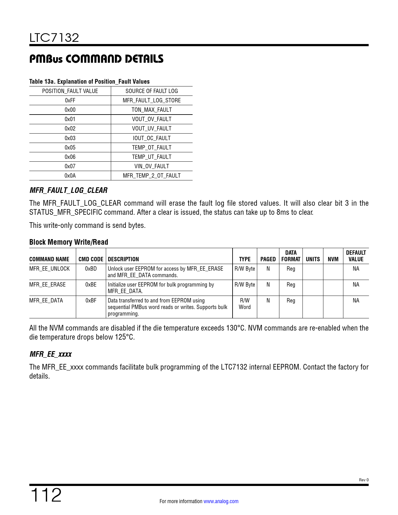

PMBus COMMAND DETAILS. Table 13a. Explanation of Position_Fault Values. MFR_FAULT_LOG_CLEAR. Block Memory Write/Read. DATA
PMBus COMMAND DETAILS Table 13a Explanation of Position_Fault Values MFR_FAULT_LOG_CLEAR Block Memory Write/Read DATA
LTC7132
PMBus COMMAND DETAILS Table 13a. Explanation of Position_Fault Values
POSITION_FAULT VALUE SOURCE OF FAULT LOG 0xFF MFR_FAULT_LOG_STORE 0x00 TON_MAX_FAULT 0x01 VOUT_OV_FAULT 0x02 VOUT_UV_FAULT 0x03 IOUT_OC_FAULT 0x05 TEMP_OT_FAULT 0x06 TEMP_UT_FAULT 0x07 VIN_OV_FAULT 0x0A MFR_TEMP_2_OT_FAULT
MFR_FAULT_LOG_CLEAR
The MFR_FAULT_LOG_CLEAR command wil erase the fault log file stored values. It wil also clear bit 3 in the STATUS_MFR_SPECIFIC command. After a clear is issued, the status can take up to 8ms to clear. This write-only command is send bytes.
Block Memory Write/Read DATA DEFAULT COMMAND NAME CMD CODE DESCRIPTION TYPE PAGED FORMAT UNITS NVM VALUE
MFR_EE_UNLOCK 0xBD Unlock user EEPROM for access by MFR_EE_ERASE R/W Byte N Reg NA and MFR_EE_DATA commands. MFR_EE_ERASE 0xBE Initialize user EEPROM for bulk programming by R/W Byte N Reg NA MFR_EE_DATA. MFR_EE_DATA 0xBF Data transferred to and from EEPROM using R/W N Reg NA sequential PMBus word reads or writes. Supports bulk Word programming. All the NVM commands are disabled if the die temperature exceeds 130°C. NVM commands are re-enabled when the die temperature drops below 125°C.
MFR_EE_xxxx
The MFR_EE_xxxx commands facilitate bulk programming of the LTC7132 internal EEPROM. Contact the factory for details. Rev 0 112 For more information www.analog.com Document Outline Features Applications Typical Application Description Table of Contents Absolute Maximum Ratings Order Information Pin Configuration Electrical Characteristics Typical Performance Characteristics Pin Functions Block Diagram Operation Overview Main Control Loop EEPROM Power-Up and Initialization Soft-Start Time-Based Sequencing Voltage-Based Sequencing Shutdown Light-Load Current Operation Switching Frequency and Phase PWM Loop Compensation Output Voltage Sensing INTVCC/EXTVCC Power Output Current Sensing and Sub-Milliohm DCR Current Sensing Input Current Sensing PolyPhase Load Sharing External/Internal Temperature Sense RCONFIG (Resistor Configuration) Pins Fault Detection and Handling Status Registers and ALERT Masking Mapping Faults to FAULT Pins Power Good Pins CRC Protection Serial Interface Communication Protection Device Addressing Responses to VOUT and IIN/IOUT Faults Output Overvoltage Fault Response Output Undervoltage Response Peak Output Overcurrent Fault Response Responses to Timing Faults Responses to VIN OV Faults Responses to OT/UT Faults Internal Overtemperature Fault Response External Overtemperature and Undertemperature Fault Response Responses to Input Overcurrent and Output Undercurrent Faults Responses to External Faults Fault Logging Bus Timeout Protection Similarity Between PMBus, SMBus and I2C 2-Wire Interface PMBus Serial Digital Interface PMBus Command Summary PMBus Commands *Data Format Applications Information Current Limit Programming ISENSE0± and ISENSE1± Pins Inductor DCR Sensing Inductor Value Calculation Inductor Core Selection Low Value Resistor Current Sensing Slope Compensation and Inductor Peak Current Variable Delay Time, Soft-Start and Output Voltage Ramping Digital Servo Mode Soft Off (Sequenced Off) INTVCC/EXTVCC Power Topside MOSFET Driver Supply (CB, DB) Undervoltage Lockout CIN and COUT Selection Fault INDICATION Open-Drain Pins Phase-Locked Loop and Frequency Synchronization Minimum On-Time Considerations External Temperature Sense Input Current Sense Amplifier External Resistor Configuration Pins (RCONFIG) Voltage Selection Frequency Selection Phase Selection Address Selection Using RCONFIG Efficiency Considerations Thermal Considerations Programmable Loop Compensation Checking Transient Response PolyPhase Configuration PC Board Layout Checklist PC Board Layout Debugging Design Example Additional Design Checks Connecting the USB to I2C/SMBus/PMBus Controller to the LTC7132 in System LTpowerPlay: An Interactive GUI for Digital Power PMBus Communication and Command Processing PMBus Command Details Addressing and Write Protect General Configuration Commands On/Off/Margin PWM Configuration Voltage Input Voltage and Limits Output Voltage and Limits Output Current and Limits Input Current and Limits Temperature External Temperature Calibration Timing Timing—On Sequence/Ramp Timing—Off Sequence/Ramp Precondition for Restart Fault Response Fault Responses All Faults Fault Responses Input Voltage Fault Responses Output Voltage Fault Responses Output Current Fault Responses IC Temperature Fault Responses External Temperature Fault Sharing Fault Sharing Propagation Fault Sharing Response Scratchpad Identification Fault Warning and Status Telemetry NVM Memory Commands Store/Restore Fault Logging Block Memory Write/Read Typical Applications Package Description Typical Application Related Parts
